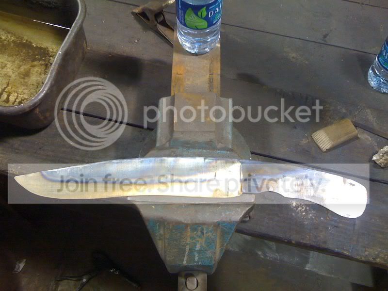

This is an 8 1/2" blade and is just about 2" at the widest point. I ground the bevels to within about 1/2" of the spine to create a nice thin flat ground blade. My blade is also 3/16" at the ricasso and tapers to near zero. I didn't round the spine, but the edges are "eased".
I think, if I were to build a "real" test knife it probably would be a full tang. But, we'll see how this does. I put two pins in this one just because I thought it needed it mechanically, not so much for aesthetics.
Anyway. This is the knife. I have a couple more things to do to it before its ready, and I need to find some rope...... enough to hang myself if needed!
