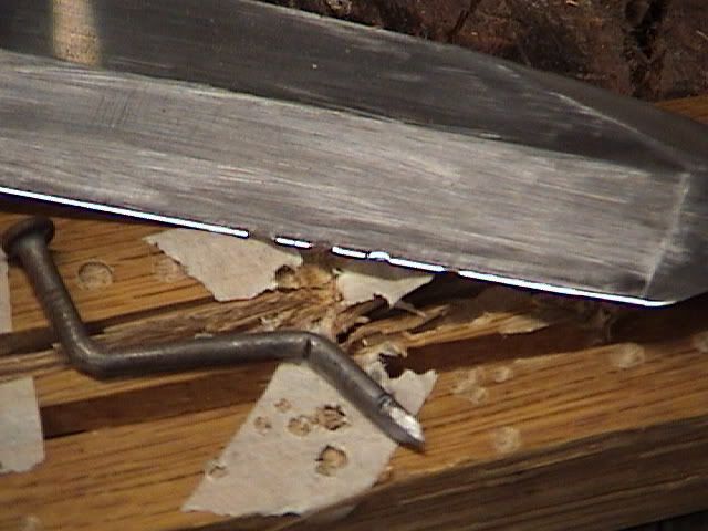

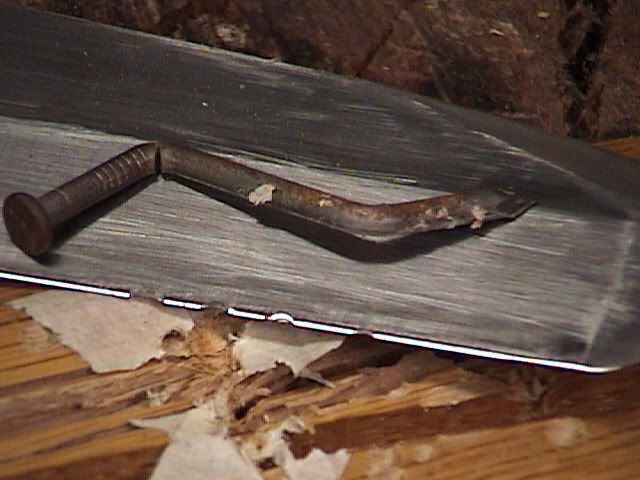

I am slowly reading through this thread, but thought I'd give it a shot with an old beater 440C tanto. Edge angle at around 35-40 degrees total. 2.5" nail, and a big nylon hammer. I cut through about 40%, maybe a little less. I had a hard time figuring out why technique could be an issue - hold the knife straight and strong, and hit it with a hammer. I guess the knife could slip as you hit it, though. If I would have done it on a harder surface I could have ounded through, but I drove the nail into the wood and bent it before I could cut through.
Pictures of edge damage:
Some nice dents and one chip.
My conclusion is that this is a test you should not do with your nice knives.
I destroyed a ocuple knives just from the awkward position I was in (not working on a table) and not having the best grip on them.
Happened to me as well, then I put the nail on top of a bit of steel to remedy that. But then it could shift around as I started to apply pressure before the hit, which didn't help with lining up.
It would just take a minute to set up a guide for this sort of thing, which I'll probably do once I redo the HT on some Old Hickories.

Broos, it's interesting to see how that blade failed. For starters, the ONLY test conditions I can attest to are using an 8d Common Bright nail from Home Depot. If you use a different weight of nail, I don't know what you might expect. The tanto was clearly not very hard, probably Rc54-55 would be my guess, which is probably where many factories harden 440C. Except for the small chip, those failures are plastic deformation. I got the same kind of failure with an Ontario Machete, which is 1095 at Rc53-55. That damage, while looking pretty dramatic, isn't really too bad when you think about it. The knife is still useful and you can sharpen those dings out of the edge rather easily, especially if you use a small belt sander method. You should try that. Given a convex edge, a repeat of the same test will likely result in less damage.
If a "Competition" cutter can't cut an 8d nail with almost invisible damage, it probably can't cut the hardwood dowel without a ding in the competition. The Professional Cutting Competition is a very serious test of steel. The knife has to have an edge that will easily cut rings off the paper towel tube, slice empty aluminum cans, and/or other very fine cutting challenges, PLUS be able to go through the 2 x 4 in under 10 seconds and slice through a 1" dowel of some unknown tropical hardwood. The tasks vary with each competiton, but they all place a very demanding requirement for an extremely fine cutting edge as well as a very durable chopping edge. Any detectable rolling, flattening, chipping or any other damage results in disqualification.

I need to back up for a second and note that the plastic deformation damage in Broos' knife is not the same as the plastic deformation in the M60S blade. The message from the M60S blade is that the steel can deform beyond the immediate area of contact. What I can therefore expect of both those steels is that a fine edge in made in them will roll or deform easily on even moderate impacts or on hard materials, just like happens with most kitchen cutlery, including some of the better stuff like Henckels. Most kitchen knives, except the real expensive Japanese kind, use steels having those attributes preferentially to harder, more robust steels that might chip. Nothing sadder than a broken point on a $200 chef's knife. A rolled edge that can be quickly straightened with a steel is far preferrable.
So what does this have to do with the subject of the thread? Well, it's what those more robust steels are capable of enduring in edges that are designed for chopping. As you can see in the 154CM blade above, there is fairly modest damage from cutting the nail. Compared with Broos' knife, the 154CM blade has very minor chipping at the very edge. What you see extending up from the chipped area is nail steel that is smeared on the surface of the harder steel.
A well designed edge in GOOD steel that is properly heat treated is capable of amazing cutting potential. Even some steels that are considered less than tough can exhibit a lot of toughness when they are used properly, but there is no remedy for weakness.

While there is major deformation above the edge, the edge itself is crushed on the M60S blade.
That is compressive brittle failure and fairly interesting, though not unexpected in a high carbide steel. I would like to see micrographs of the steel, surely this was done when the failure was reported as well as material properties checked on the exact hardening method used. What were the results of that analysis?
