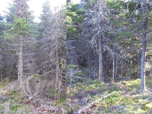

As a summary of the above, chopping well seasoned small diameter wood (2-4"), mainly juniper and spruce. The following were used until when shaving arm hair enough draw and force had to be used that the skin was abraded and/or cut:
Fiskars : 764 - 850
Bruks : 852 - 894
VTAC : 415 - 525
Again as noted the Fiskars and VTAC were significantly modified geometry wise, the bit was reduced in angle which will dramatically increase performance. The VTAC is still more obtuse than the Fiskars so the above is not a comparison of steel alone. Interestingly enough, it took longer to sharpen the Bruks after each honing, this only meant like 2 minutes instead of a minute and a half for the Fiskars. The blunting was all deformation based for each axe and thus wear resistance through carbide volume would just lower performance.
I am also not confident that those ranges represent the extremes of performance, especially on the low end. It is simply too difficult to tell when shaving has been lost because the change is just so slow in extended use that there is almost no difference after even 100 more chops. I would strongly recommend to anyone doing that type of comparison to have a reference blade in a very high corrosion resistant stainless (to keep the sharpness constant) at the exact level of blunting that the cutting will be stopped. If you use this as a reference point for the shaving it would make it more consistent.
