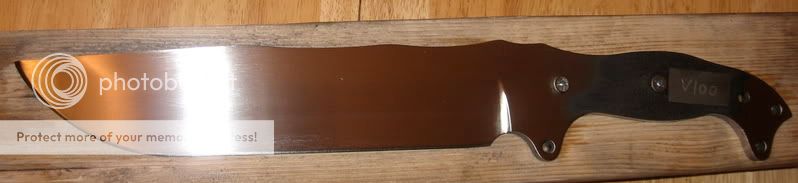

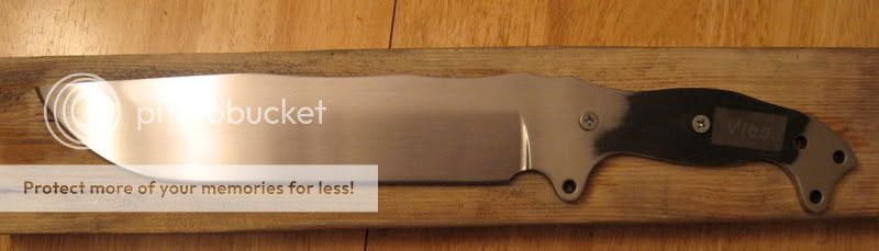

Update:
Yesterday I was able to get rid of most of the dimples on the blade by hand sanding with a rubber block and 80 grit paper. Today I removed the little bit that remained on the blade, then the ricasso and butt areas. And this is the great part. After the 600 grit I just tested the scotch-brite wheel that we have discussed in other threads. Here is what I got.
Bad lighting but I think it looks pretty darn good for a user. And if I can get away with just hand sanding with 80 grit and then the scotch-brite method to clean it up then I am going to be a happy HOG! :D
Now it's time for side two. :(

Now that looks darn good!
After 40 min, with a few breaks, I am about 1/2 finished on the blade. Tomorrow I hope to finish it up and get the handles on. I hope. :D
But there are some of those zig zag grind marks on the ricasso that I expect will give me some trouble. :(
That's lookin really good, Tyrkon. :thumbup:
You should be able to get away with the 80 grit to Scotchbrite if your last sanding is with fairly worn out 80 grit paper.
Once it's finished... you will be able to clean it up any time you like with your Scotchbrite wheel.
Good stuff. :)
