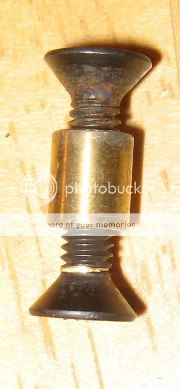

Here is the data on the screws and the tube/spacer:
Screws: 8/32" machine thread and 5/16" long
Tube/Spacer: threaded for 8/32" machine screws, 1/4" OD, 5/16-1/4" length.
Today I ordered some 1/2" long standoffs threaded for 8-32 screws, along with a pack (100, yeesh) of SS black oxide hex screws in 8-32 3/8" long. If they fit I'll be happy to sell some of the 94 extra screws. :)

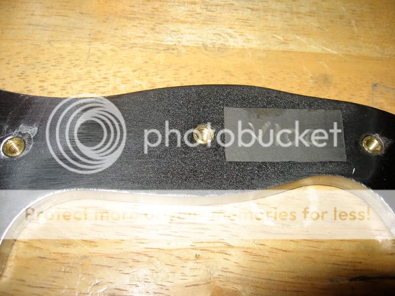

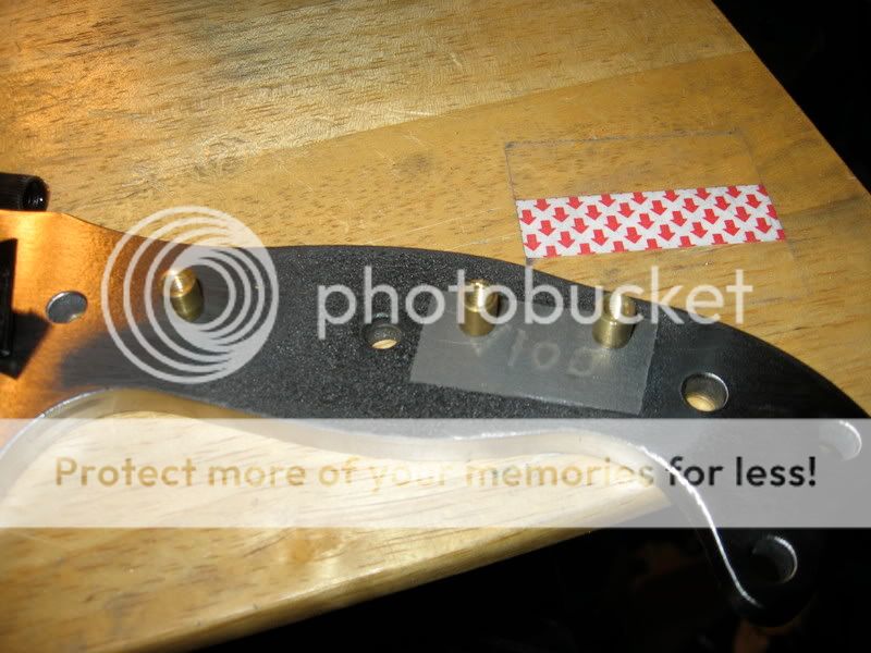

Here I put the threaded tubing/spacers in. They are 1/4" OD and threaded to fit 8/32 machine screws. I had to lightly tap them in and they were snug.

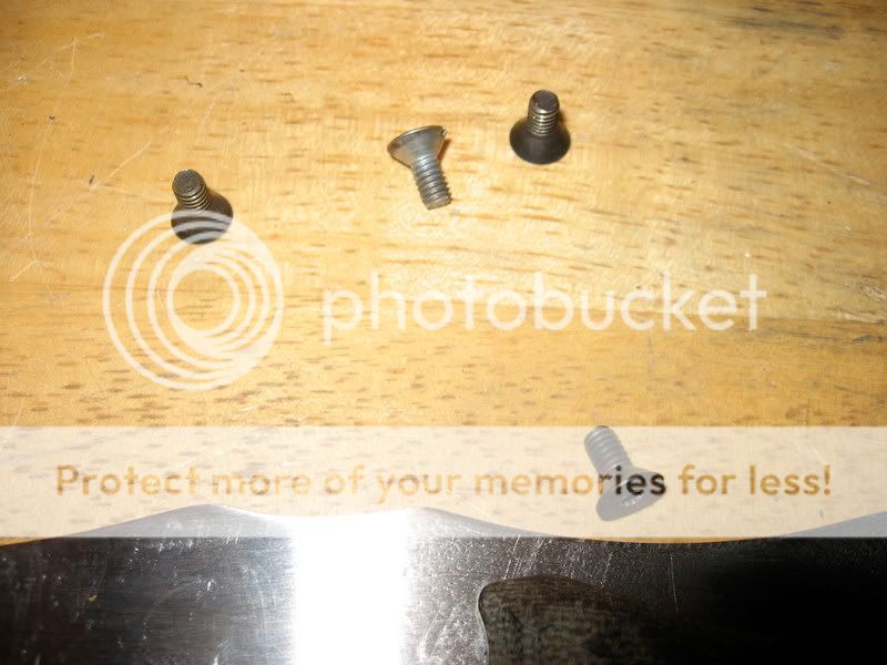

Next these are the screws I used. They are 8/32" machine thread and approx 5/16" in length. These are just temporary until I get some nicer ones.
I suppose I could smooth it out a bit more but this bad boy is a user. So I think this is it for now. But Once the handles were secure I hit the entire blade again with some scotch-brite. I achieved my main goal which was to remove the INFI dimples. You'll notice that one of the handle screws is different from the rest. But I'll be replacing all of them in the very near future.

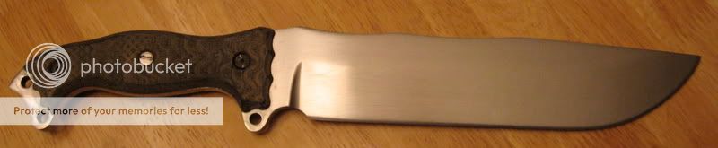

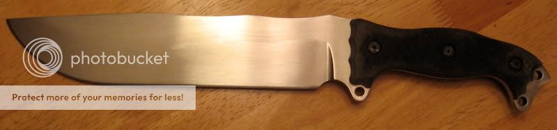

From this
To this.
