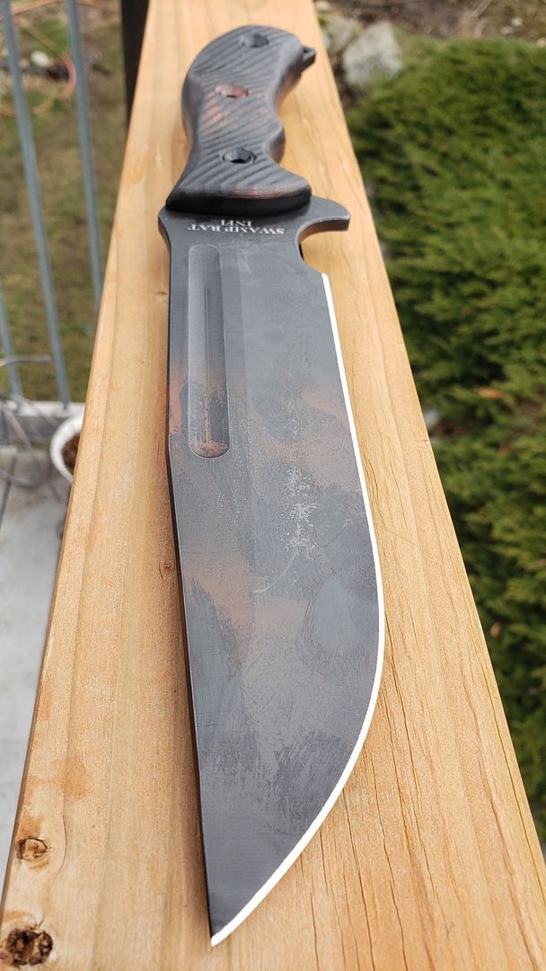

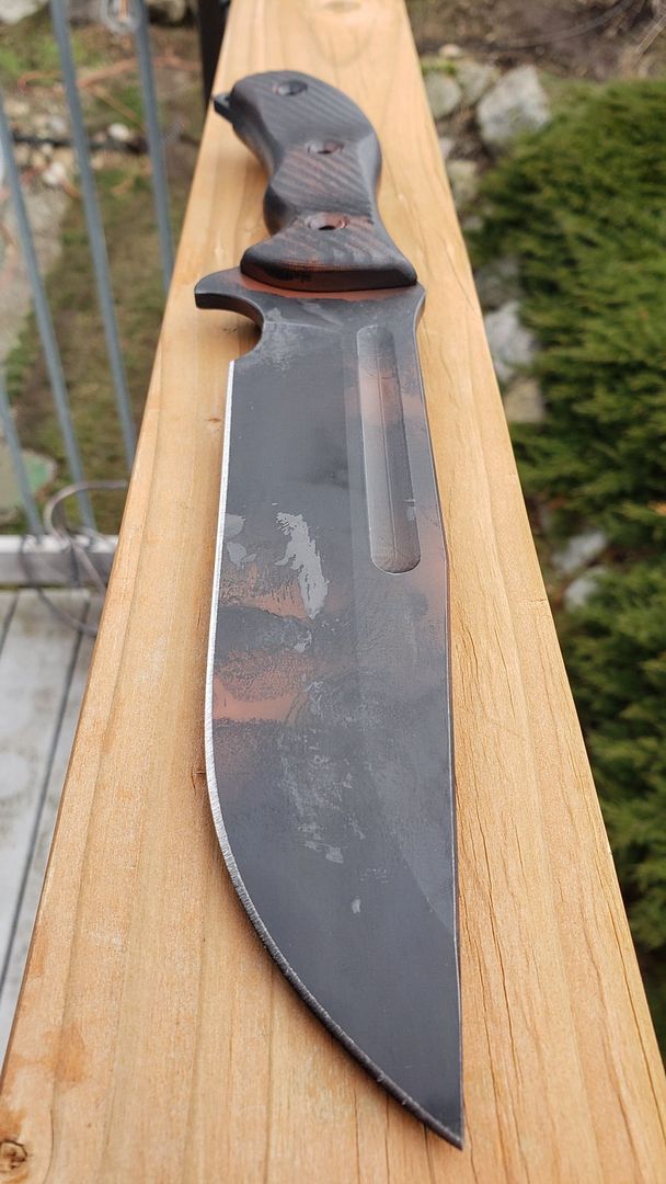

We still don't know if what we are looking at for INFI is decarb or scale (meaning patina). From the article:
"Generally both these surface phenomena, oxidation and decarburisation take place simultaneously. If the rate of both these processes are equal, or even when the rate of oxidation is faster than decarburisation, then the steel surface lying immediately below the scale layer is not decarburised and has the same composition as the interior of the steel.
Decarburisation depends on the chemical composition of the steels. Chromium, if present in steel, makes it less sensitive to decarburisation, as it reduces the diffusion of carbon, and itself produces thin, adhering and impermeable film of scale, which physically prevents interaction of carbon and atmosphere of the furnace. Elements like Si, W, V and Mo increase the tendency of the steel to decarburisation."
I get it...
Let's assume it's not decarb. , then what are the likely suspects of what it could be?
I've never seen scale "rust" on immediate contact with oxygen....so I'm personally betting against that one unless what I've been calling "scale" my entire life really isn't.
OTOH, I've literally watched stripped Busse's rust before my very eyes >>> Blades that still has that layer of, I'll call it mystery sauce on it.
Hey, maybe what we think is decarb. could be Thousand Island dressing-- that's the secret sauce on Big Macs-- allegedly...then again 🤔 , I don't think Ronald McDonald's ever made a definitive statement about it. 🤷‍♂️ :p
OTOH, I've literally watched stripped Busse's rust before my very eyes >>> Blades that still has the layer of, let's call it, mystery sauce on it.
Remember, I have one of your strippers, still going strong, and I very much respect your opinion :) Were this INFI ?
I’ve seen enough folks mention this to think it might not be the exaggeration I initially took it to be. That would make for a really cool video, literally watching rust form out of nowhere.

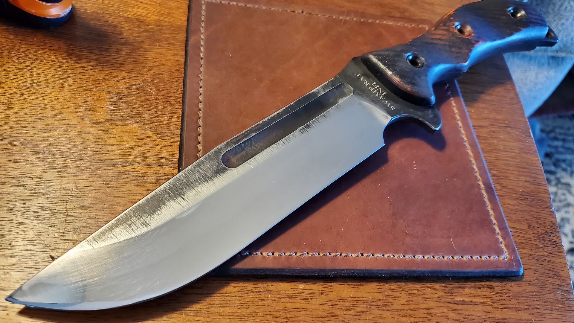

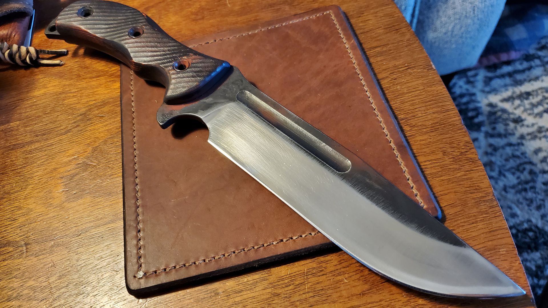

Yeah, Roland, it's all good...I love this kind of discourse I learn a lot this way. Please don't take my teasing personally, I don't think you are taking it that way, BTW, just a pre-emeptive statement.
But yeah, iirc, I removed the stuff with a dremel stainless brush and various grits of sandpaper after I removed the paint with chemical stripper-- Jasco.
I finish up with scotchbrite bonnets and Mother's Chrome Polish-- all those steps are fairly abrasive >>> unlike my posts <at least I hope you interpret it that way> :) .
Photo after bead blasting and sharpening :) came out great, IMHO !
