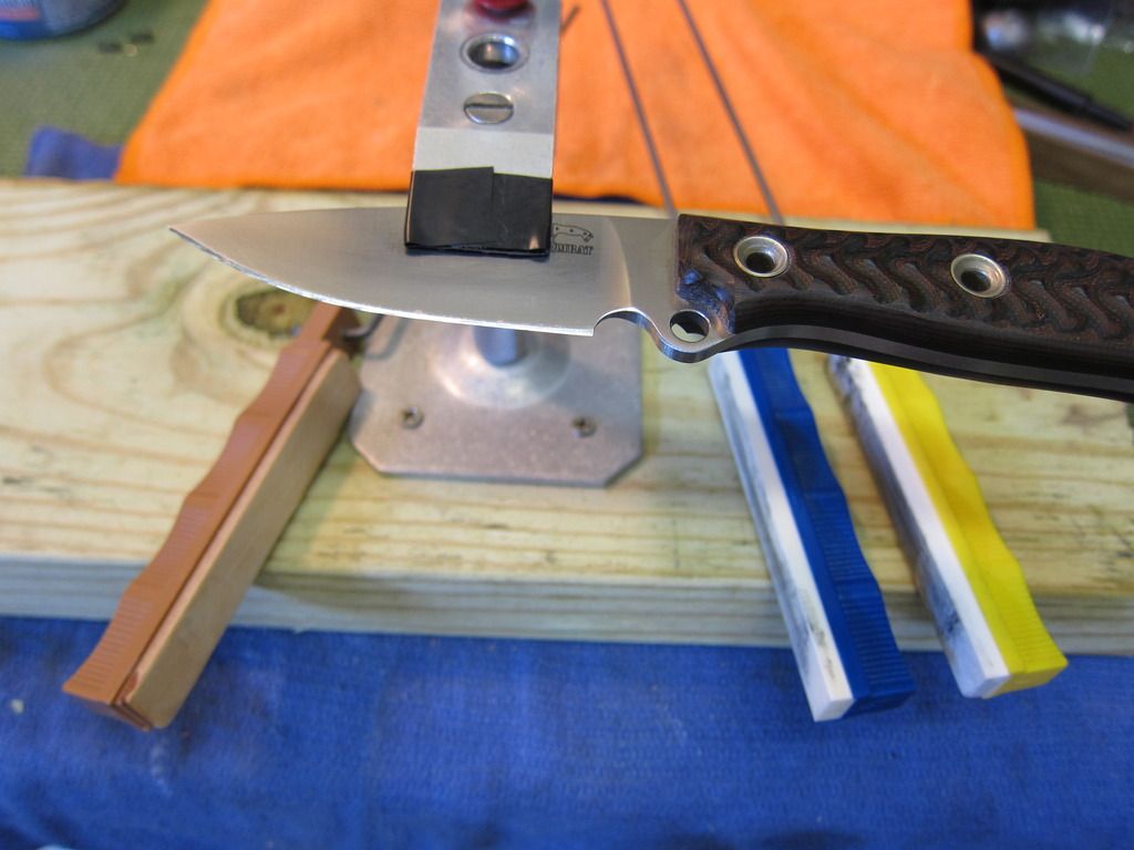

Got in the Lansky 1000, 2000 stones and leather strop. What a difference. Knife is now hair popping sharp. Could not get the blade as polished looking as the knife I sharpened on the wicked edge as you have to do multiple short strokes on the Lansky rather that a long sweeping stroke on the wicked edge.
Tried a long sweeping stroke on the Lansky but fell of the blade and knew that would not end well on the fingers if I tried to continue to do that. Overall a very very sharp edge that shaves hair on your arms with very little pressure. Good stuff, hard to beat for a budget sharpener. Going to try and find a KME to try next.

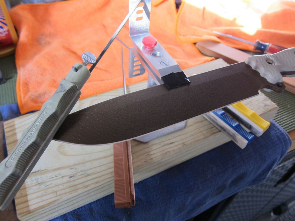

Put the ASH2 in the Lansky clamp to see if there was enough rod length to work. It clamped easily and looks like the rod length is long enough to sharpen.
Looks like the 30 angle on the Lansky would work best. Don't know if there is any correlation between the Lansky angles and real world angles.
Was really tempted to sharpen but am going to strip and blast the ASH2 and only want to sharpen once. You are limited with your angles on the Lansky but it still may work very well

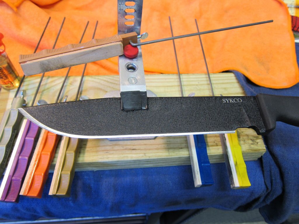

Put the SYKCO 911 on the Lansky and sharpened it. Used the 25 Degree slot on the Lansky clamp. Was a lot of effort to thin out the tip and it took over an hour with the Extra Course diamond stone. The Lansky is not ideal for a blade of this length. Must have been putting quite a bit of pressure with the stone as the the knife loosened up in the clamp and had to re clamp it.

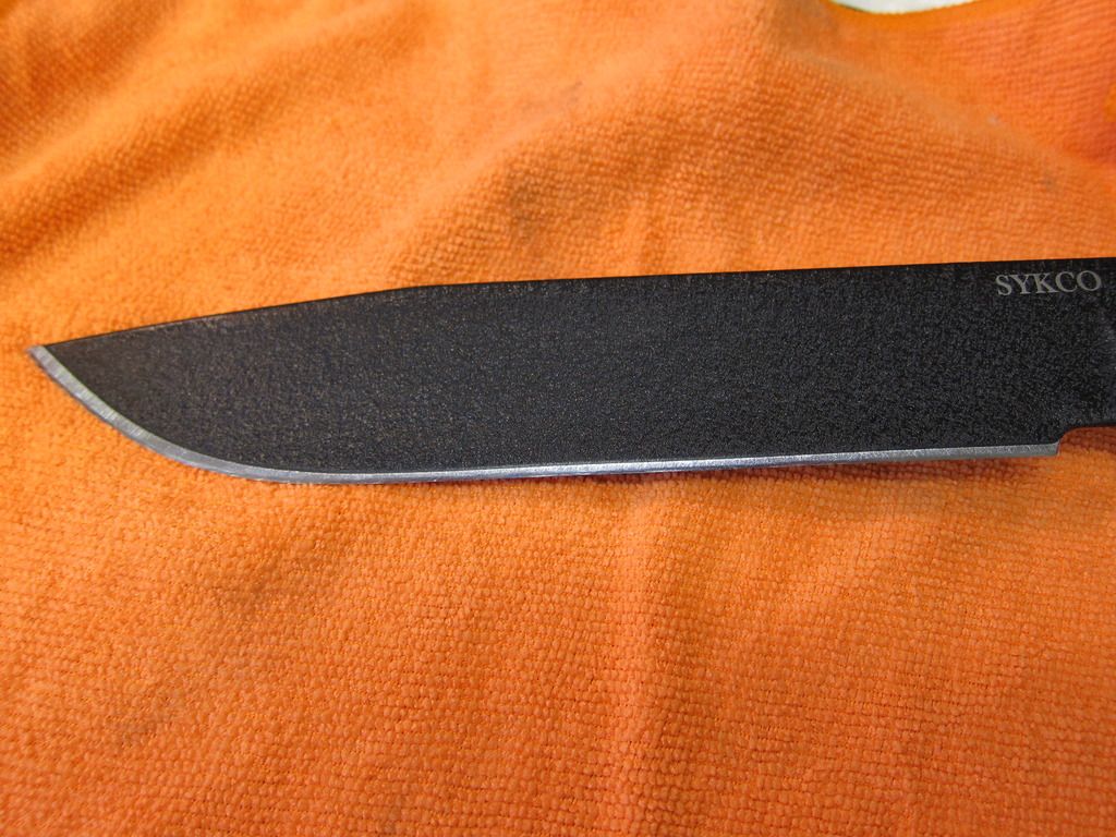

Not the most polished looking edge but the knife is super hair shaving sharp ( SHSS) . Sharper than any stock Busse edge I have seen. Can't wait to test out the 911 and see how the edge holds up.
It looked closer to the 30 degree on the Lansky Clamp. Don't know what the correlation between the Lansky degree on the clamp and actual degree is.
The actual angle will depend on how far the knife sticks out from the clamp. With a standard Victorinox SAK, the actual sharpening angles are:
13.3 degrees on the 17 degrees setting
17.4 degrees on the 20 degrees setting
21.5 degrees on the 25 degrees setting
25.3 degrees on the 30 degrees setting
Looking at your photo, I would say that the angle is close to 23 degrees
http://www.trianglecalculator.net/
Calculated with metric input
