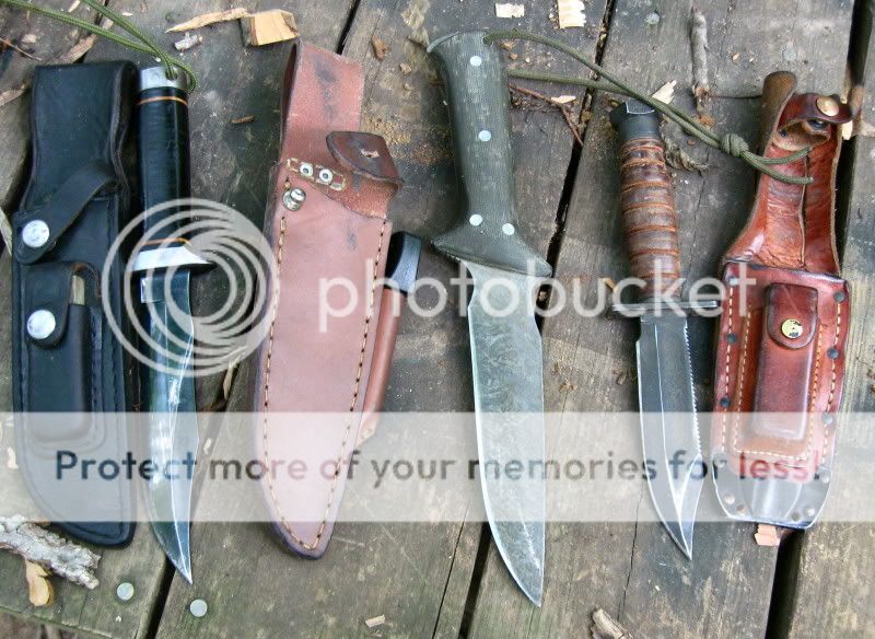

I feel that batoning is fine IF you know the limits of your tools.I have batoned many,many times with my BRKT Aurora,Bravo-1 All of my Fallkniven knives.Most reciently I batoned a pile of wood on a multi-day hiking trip because we were soaked from a daylong heavy rain.That knife was my Forum knife from NWA.I didn't split anything bigger around than my arm.We saved the axes for chopping down trees quickly rather than risk dulling them on the rocky ground.
Exactly, that's when it counts. Batoning has typically been a means of just dealing with what I have on hand most of the time, there are usually other ways I could deal with things. It has been really a matter of well being only once...we were a few miles along the Cumberland trail on the side of a mountain, and it was pouring rain. My oldest daughter (only daughter at the time) was chilled and needed warming quickly. It was dark, there were many pitfalls between rocks out there so rather than hunt for smaller wood I started breaking wrist sized limbs off a downed pine tree and batoning them to get to the inner wood to burn for the initial fuel With the issue survival knife pictured below.
However, it has since that day been a test that any knife I will keep and carry to the woods must pass.
These are three of my go to knives that I trust to take some abuse. They and a few others have passed this test.
I do however find it hilarious that a lot of the high dollar knives so many people are afraid to baton would likely handle it just fine, but people are afraid to because of the price paid.....what was the point unless it is an antique in a glass case.

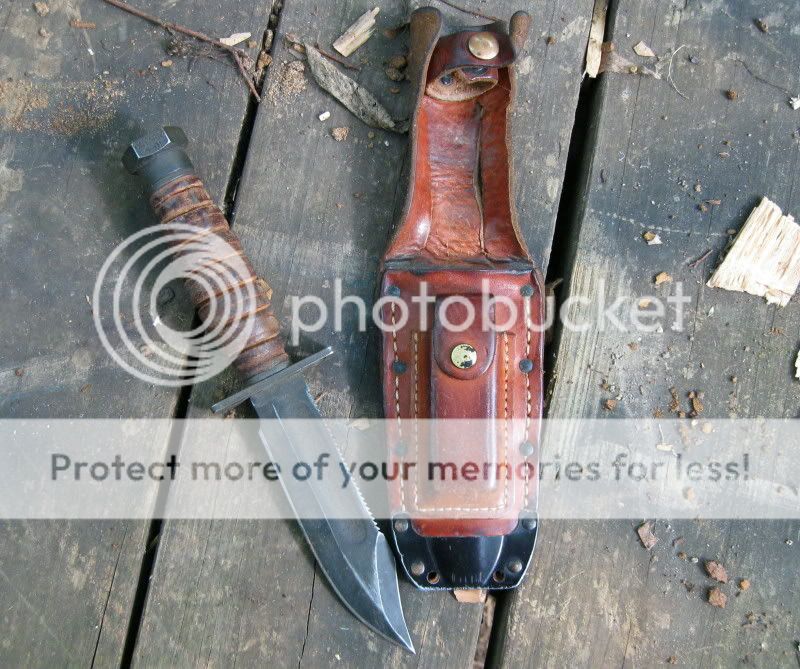

Hey MistWalker I like your Pilot's Survival Knife ! Mine's marked Camillus Cutlery May 1984, What's your's marked on the back of the Sheath ?There a Great Knife I got this Beauty at a Garage Sale last year for 10.00, It's a Real Work Horse,
Batoning is normal, traditional, and non-abusive. At least for camp knives. I would not (could not) baton my needle-tipped Spyderco Ronin, nor would I baton my folders. Thin Stainless steel and extreme high hardness knives are not well suited for batoning. They also do not make the best field/survival knives.
I would never buy a knife from a maker who thinks batoning is abusive. Even a thin machete will sustain no damage from batoning. If a camp knife breaks just from batoning it is flawed in design or heat treat, and not worth owning.
That one is an Ontario and is stamped on the pommel 5-01, that one is the fifth or sixth one I've owned....I keep passing them on to friends after teaching them a few things with them, but this one is now sentimental and not going anywhere. I like yours too, this is only the second Ontario the others were Camillus....I keep hunting for a six inch in decent condition....wish they'd make a run of those.
Thank's for the Info. I know they've been making them since WWII maybe earlyer I'm not sure, Ya the one I have Is a 5" Blade, But It sure Is a Heavy Duty Knife, I seen a Surplus Supply Company In Shotgun New's that had them Military Surplus for I think 40.00 something, I'll look the add up and see what they are,
