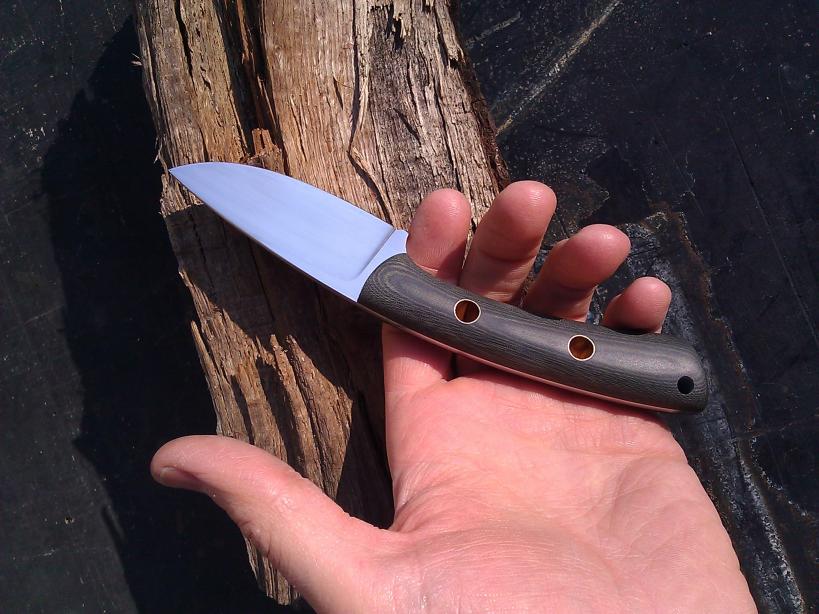

Candiru who? Dex, that is a seriously cool little knife! :thumbup:
It would be cool to see a concept where the bottle opener could still be incorporated on the end. *cough*Dubz*cough*
Can-da-who? lol Thank Jerry. I am really really liking it. It was actually one of the easiest and quickest extreme makeovers I have ever done.
You may be able to add a bottle opener by cutting a slot in the circle. But the way I used this knife, the smooth circle in the palm of my hand felt good where as a sharper bottle opener may not be as comfortable.
Is that a little piece of deer or a fire ant bite on your index finger? Looks like one of the hundreds I've had over the years. Nasty buggers.
Awesome job on the 11 and the deer.
Thanks man! And no Ant bites for me. That was deer flesh. lol. The pieces were flying!

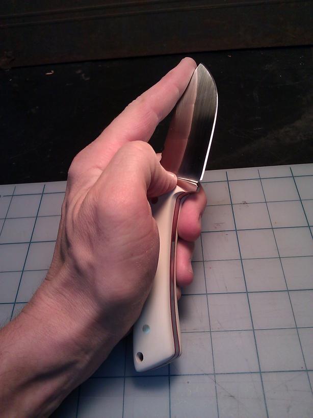

I really do like there is no plunge line at the blade and I can actually use more of the knife to get deeper cuts. The cutting edge is a hair shy of 2 1/4" but you can actually push the blade in up to 3 1/4" with no problem.

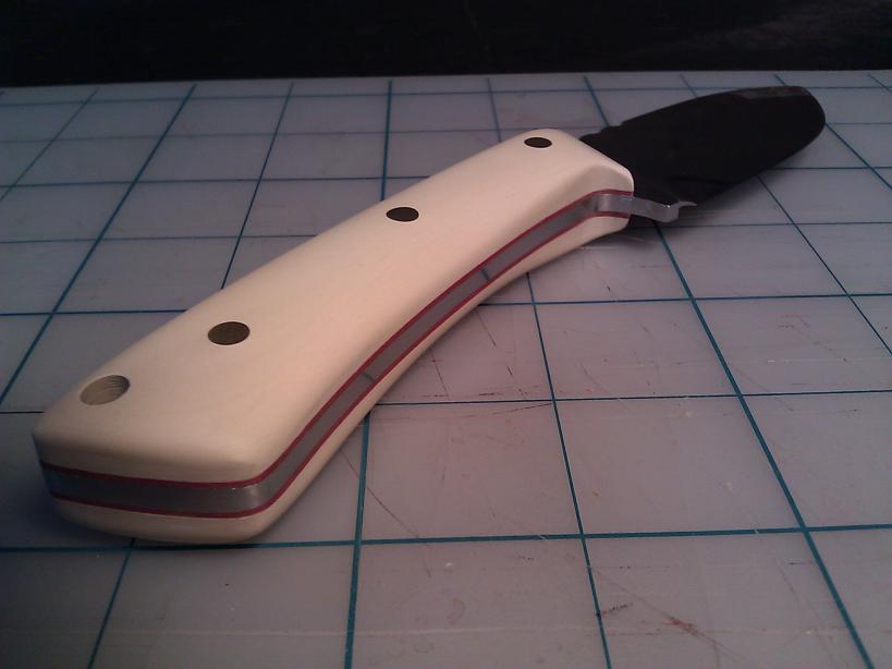

Thanks, and not just white either :D (it was ivory paper micarta, IIRC):
Very nice Daizee. Question: How does the paper micarta hold up when it gets wet? I almost ordered some before but was afraid it would not handle water well unless you coated the finished handle in a CA glue.

The material is seriously infused with epoxy. Linen and canvas micarta would have the same problems. Not that I'd SOAK any of them... Usually I wax the handle anyway. it makes the color a bit richer and less likely to absorb stuff like water, blood, etc.
What I mean is that when paper gets wet, it usually falls a part. Where when fabric get's wet, it just dries. I know I soak my micarta scales in soap and water and clean with a tooth brush or scrubber when they get dirty and they seem to be fine. They actually dry really quick and look brand new. Have never had a problem at all.
I just wasn't sure if the paper would hold up that well. But it makes sense that since the paper is so thin, it would be completely impregnated with the resin and be fine.
Thanks for the info, I may try some out cause I love the smoothness you can get since the fibers are so small. And the white looks so good.
