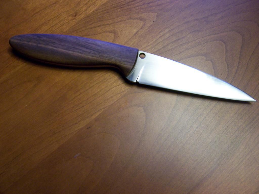

Thanks Granite, The hole was originally in that piece of scrap which had an odd shape and three holes. I was able to machine out the other two during profiling.

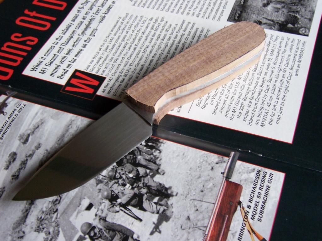

Anyone have any tips for removing scales once they have been epoxied and pinned?
I let the epoxy set for 2 days since i figured it was cold it may take longer to cure. Then decided i wanted to sand them down a bit so the handle wasnt so thick. I used the belt sander to do so. While doing that the scales started to separate from the tang.
WW:
Most epoxy has a temperature range that it has to be cured in, or it won't work as well or at all. Since it's already separating (sorry about that....sucks, doesn't it?) you probably didn't get a good bond to begin with. Should just be able to get a chisel in there and pop the thing off. It's happened to me; the scales left a little wood behind where I did get a good bond, but I just used a sanding block to get the rest of the epoxy and wood off. Make sure next time that the steel is good and roughed up, cleaned well (I use alcohol or acetone; even skin oils will compromise the epoxy bond) and then clamp them with as many clamps as you can fit on there (if your previous post is any indication, that one solo clamp is likely the culprit - should have ones also in both the bolster and lanyard areas) in at least a 60°f or warmer space.
Good luck!
WW, it looks like that scale is tapered, and the surface is simply not flat.
To get it off once the epoxy is cured:
1) pre-heat toaster oven to 300F
2) place blade in toaster oven for 10-15 minutes
3) knock out pins on a bench block with a hammer and punch- use gloves
4) clean up remains
WW:
Good luck!
Thanks Mike! Does suck but it gives me more practice and teaches me something new so i guess i cant be too upset (says while mad at self)
After taking the picture i used a 2nd c-clamp on the top of the handle. And i used alcohol to clean both the wood and the tang before i started to epoxy it. Maybe not well enough though.
Im thinking i should get one of those reptile heat lamps and build a curing box to use from now on.
4) clean up remains
Thanks for the tips Daizee.
The scale is flat on the side of the tang, i was sanding it to thin it out and working on the top. SO the top outside is not flat. Both sides were the same before i started to thin it out. Im not sure if im explaining it right but you probably get what i mean LOL
Ill try this stuff out and start over on some fresh scales, thanks guys!!
