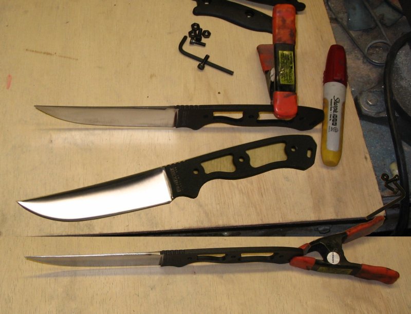

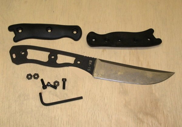

Tomorrow or the next day I'll be cleaning up/regrinding Alex's 15. If I remember, I'll take some before-and-after pics to share here :)
James - I beat ya to it since I was so excited by the outcome. You knew exactly what I had in mind, and good God is this puppy slicey.
I tried sending James two e-mails to pay for shipping, and he did the grinding, paid for shipping, and threw in some Becker/American Knife & Tool Institute swag. What a great guy.
Thank you so much, James. This is going in my knife block to be a daily user. :thumbup:
oooh, that suddenly looks like a great kitchen utility knife!
now knock the guard off the underside and its transformation will be complete!
Just a little thinning and blending... it doesn't take much on this blade:

Yeah... it'll cut ;) Glad it got there OK... I'm always a little nervous shipping stuff during the holidays.
