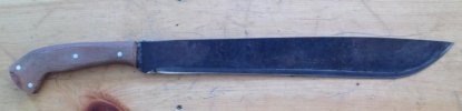

I used to make quite a few bolo/parang handles out of axe and hammer handle ends (I'm kinda rough on wooden handles)- that shape is a very good choice. If you have access to a MIG or TIG setup you can even build up the tang profile, as long as you have a heat sink for the blade and don't do anything at the tang/blade juncture.
this was a very well used GI machete i bought new when I was 18-thought it needed a more Filipino groove so I shortened it and MIGged the tang to change the pommel shape

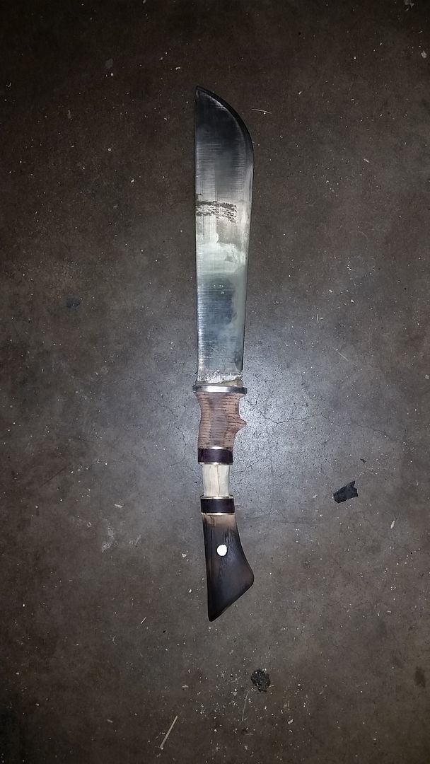

Here is another machete Im working on
I really like where you are going with this. The Ontario Machete I redid with the hatchet handle is one of my all time favorite blades now.
That looks like a serious project. All new handle or reconstruction?
Got a semi-final "form" drawing done, now I have to figure out the "function" part.
I slimmed down the original handle to a stick tang, it goes all the way to the aluminum pin in the hatchet handle. if you end up going with that last drawing that foUr is going to be amazing!
