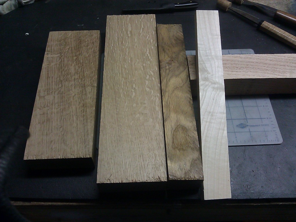

I am cornering the market in fancy white oak.
These new additions are about 20% of my collection.

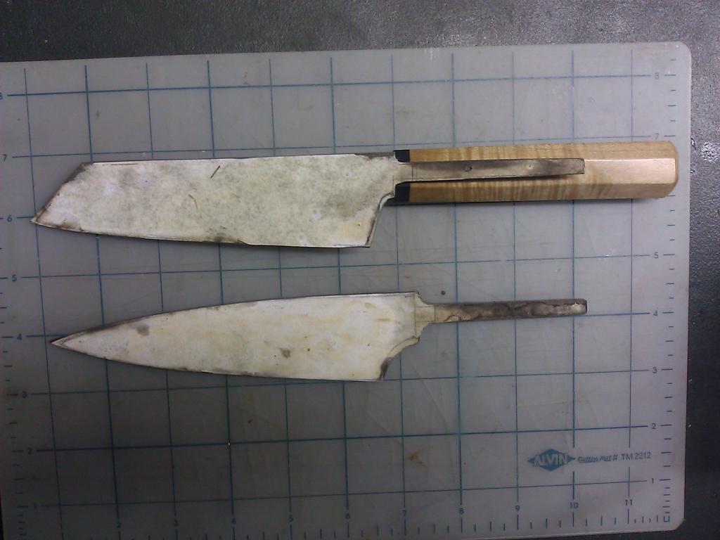

154CM kiln treated in foil wrap, plate-quenched. Came out gorgeous. Of course it's all polished off now. There's a very fine decarb layer, and shaping the handles polishes the perimeter, and it's not always so gorgeous on both sides, etc.
Makes for nice pix, tho! I like to leave that pattern on 'dashi and hidden tang knives if it comes out decent.
Thanks for the info. Shame it gets polished off. I look forward to seeing the finished product.
Yeah, I like it. Over in shop talk I almost got my eyes scratch out for suggesting it looked cool and asking about durability. It's 'unfinished', but... given the forge marks and rough finishes often left on blades, I can't see that it's always the wrong choice.
It's held up pretty well on my original birudashi.

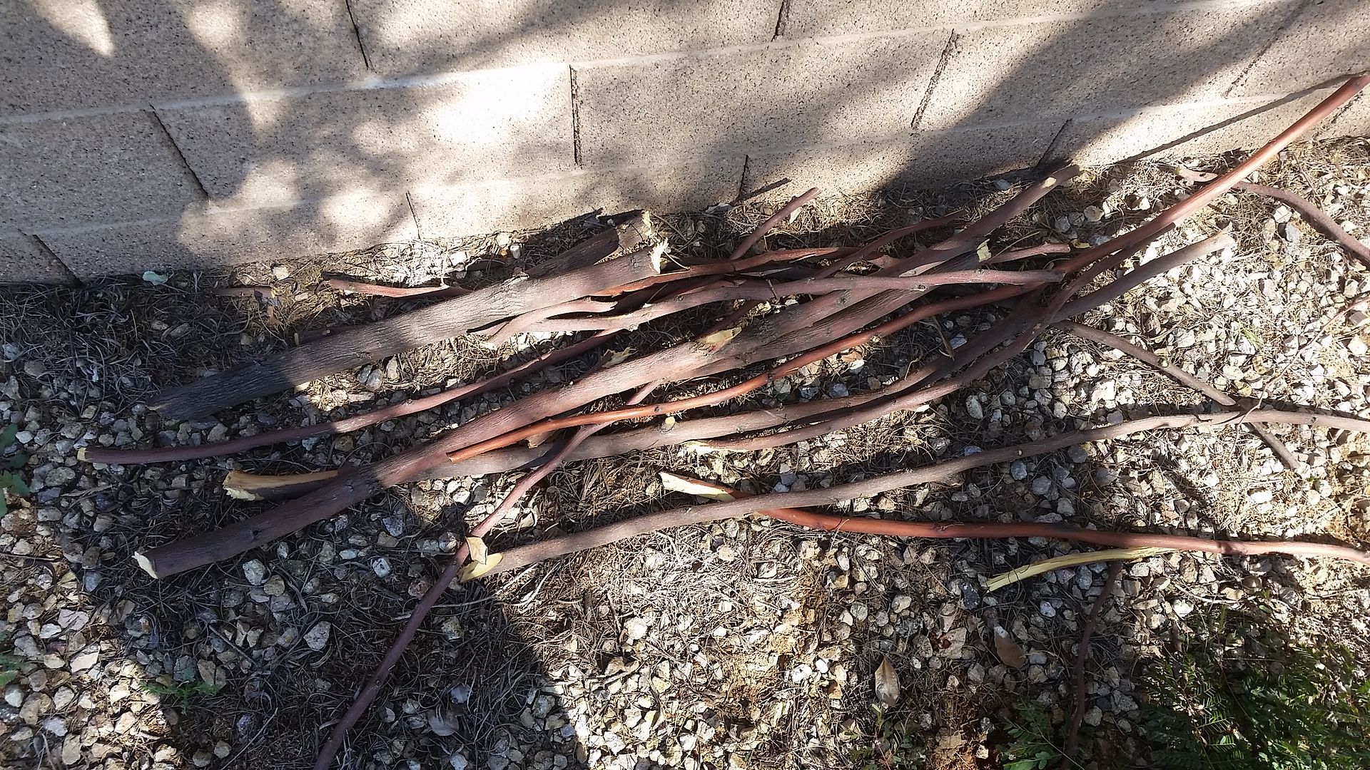

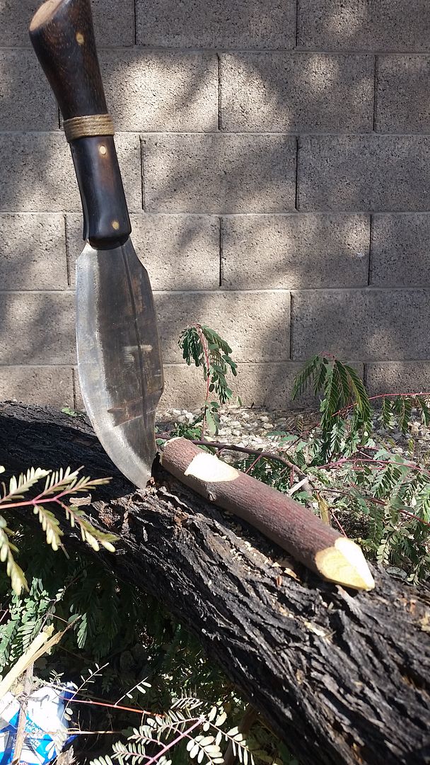

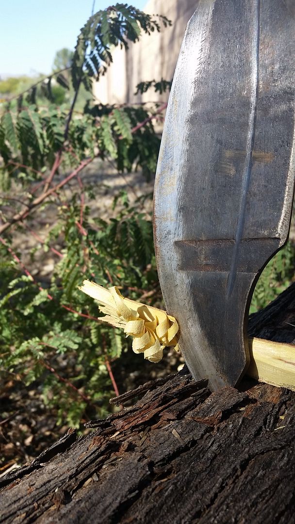

Had some fun today harvesting some downed acacia and mesquite.

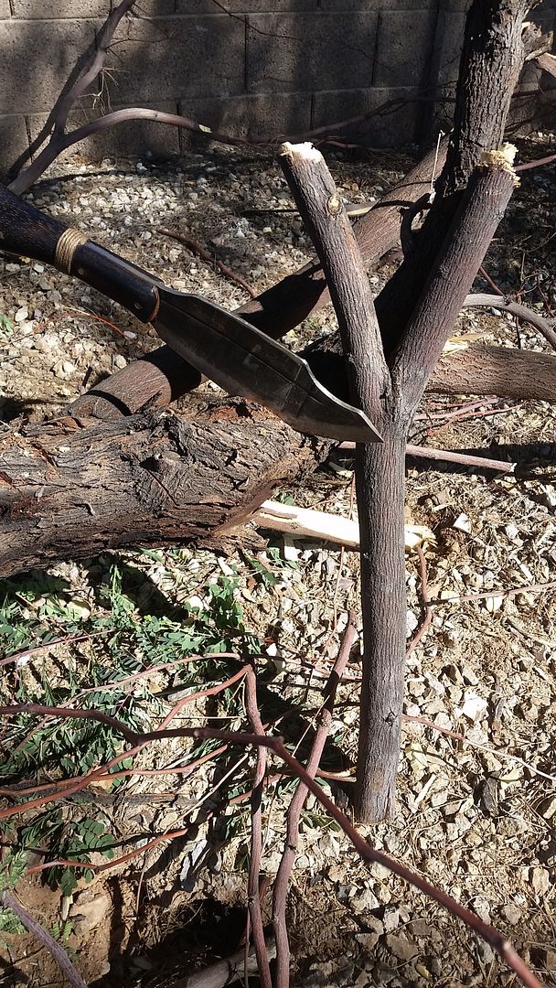

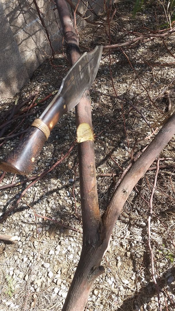

that fawns foot makes chopping so easy. I can use such a relaxed grip and just let the weight do the work. This is definitely the least amount of energy I've expended using a big knife to chop.

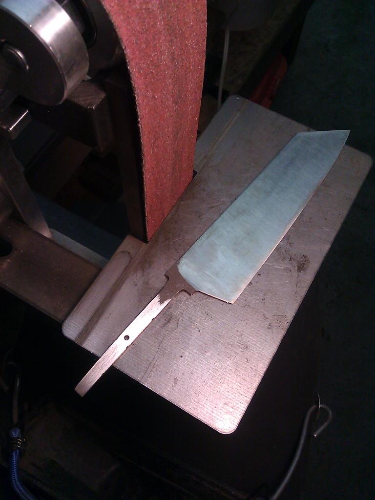

The new grinder.
It works.

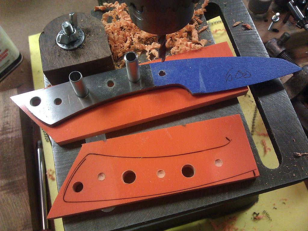

No. That, dear fellow, is mine. With nice bright orange G10 handle scales. Me and Daizee bounced ideas for a riggers knife off eachother until that coalesced.
