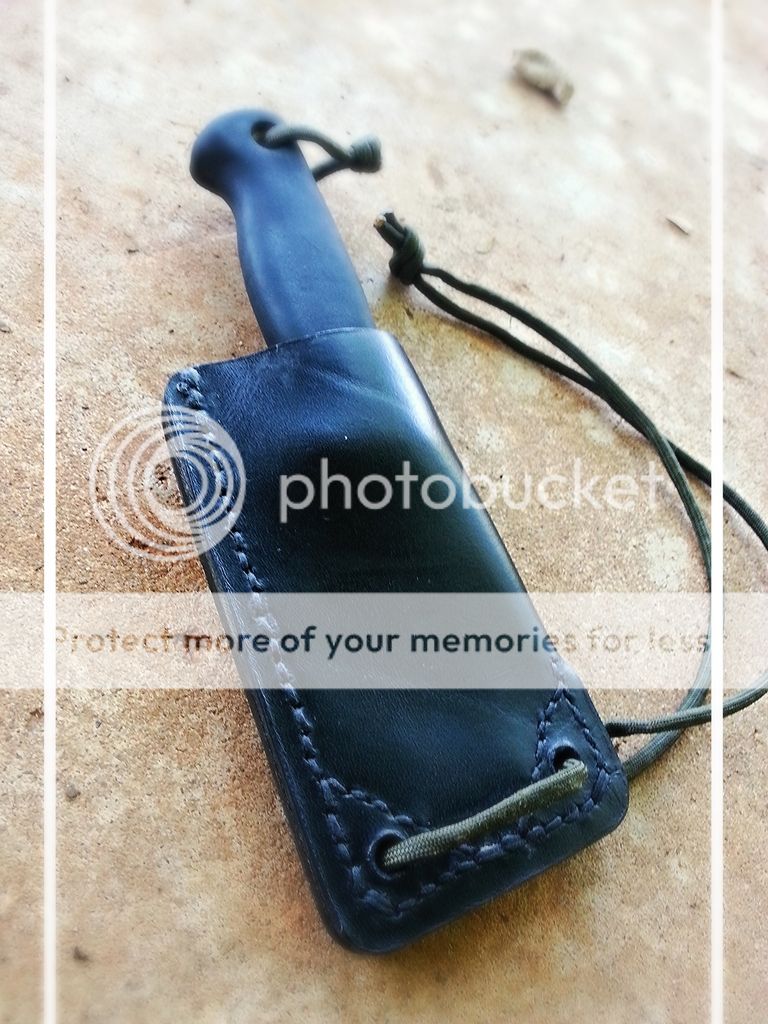

Finally made a better pocket sheath for my SYKCO 311... this thing has been in my pocket since the day it showed up. I made a quick and dirty sheath for it that has performed valiantly for a couple years now, but as with anything it was starting to show some wear and tear as it wasnt made as an end all be all kinda thing. SO! I knocked this thing out yesterday... Not the best but I dont think its too bad for having no idea what I am doing and no leather working tools. LOL I just started cutting, sewing, and waxing and here we go!
Square shaped pocket slip sheath, beeswax impregnated leather, welt sewed "proud", and two tethering holes in the bottom for a "static line" to run through a belt, or can be worn as a neck knife. Also left the interior space and welt sort of ambiguous so that it could fit other knives/things I would just have to reform it. It'll do until finally I get around to getting something more proper made for it.

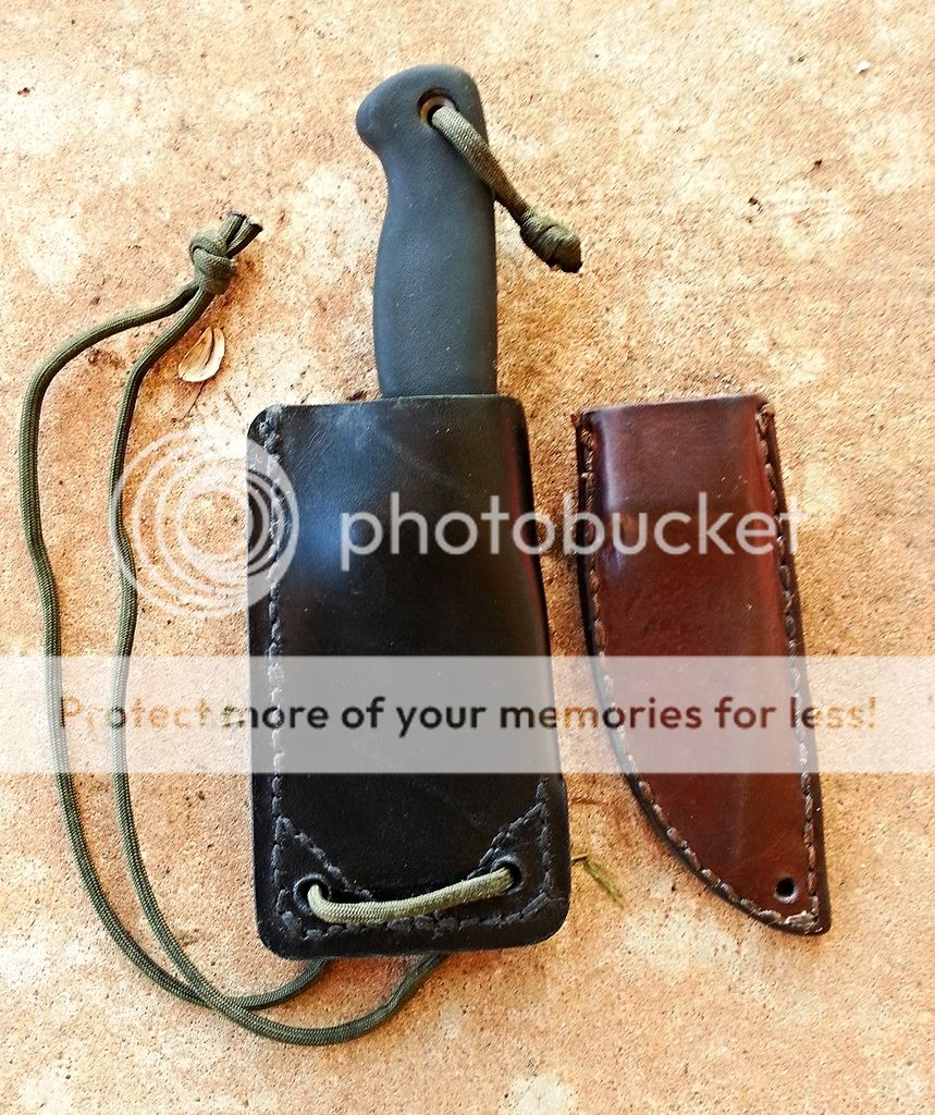

The new and the old.
Think this will work...

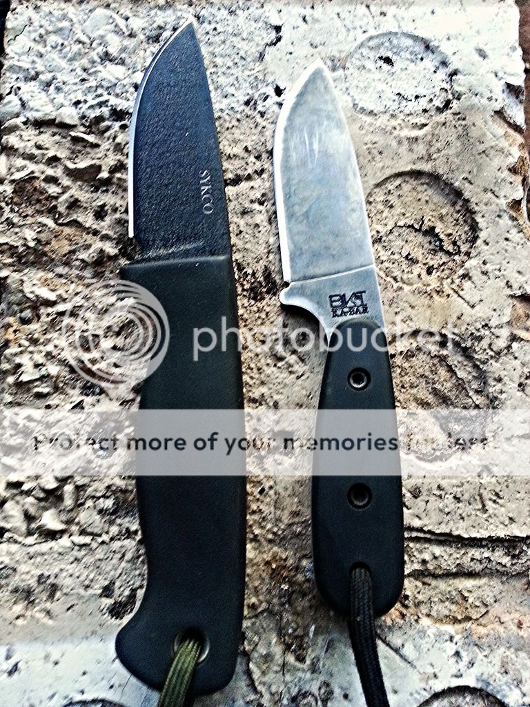

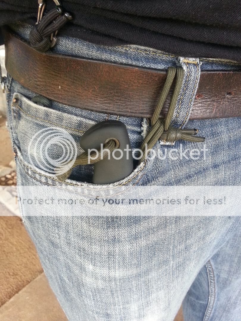

Thank you! And yes the 311 is just almost on that line between belt/pocket size. I always just wear plain ol jeans, but it works! This sheath ended up a bit bigger, but I wanted something a little "beefier sturdier" Actually, in the same pocket with the knife/sheath goes my little craftsman pliers.
Same size blade as the 14, except 3/16" thick,saber/convex ground, 52100 steel, and it has a "full size" handle. Love it, you'd be hard pressed to ever bust it.
Ancient pic, but kinda shows what I mean...
And in the pocket (with old sheath, new sheath sits just a smidge lower, and its adjustable.)

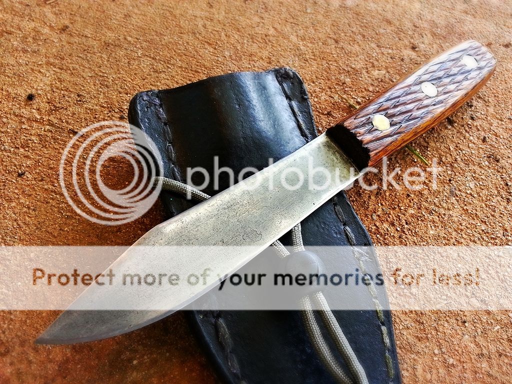

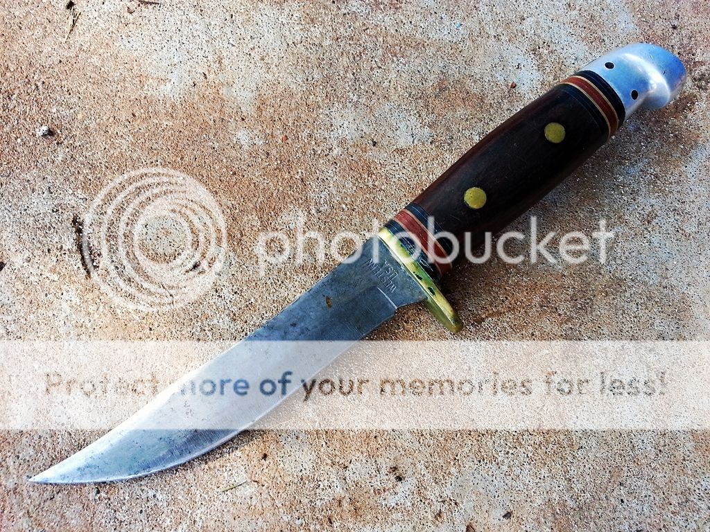

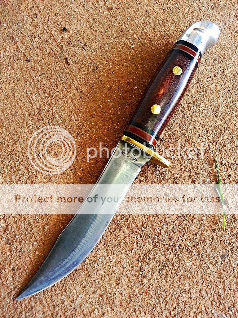

School has been taking up all of my time but to keep myself from going crazy I have been taking on little/fast projects like the sheath above, and a W66 restoration...
I found this little guy for cheap and started the initial restoration things, oil soak, scrub, sharpen, and buff. Well I accomplished all of that but as I was sharpening I noticed that the previous owner had put on an extremely obtuse angle with what appeared to be a real coarse stone/file. No matter, I buzzed it up and took it down, then outside to cut some wood. Dang thing was sharp enough to shave, but because of its age, wear, etc, the overall geometry was just not up to snuff. It was cutting just not as well as its less that 1/8" self should be. So I went back to the drawing board and decided to take it to my 2X42 and thin the grind down. Well after a couple of zips, I resharpened and its much better. Have not taken it through the grits to take out the grind lines yet BUT wanted to test before I put more time into it.
Before:
After:

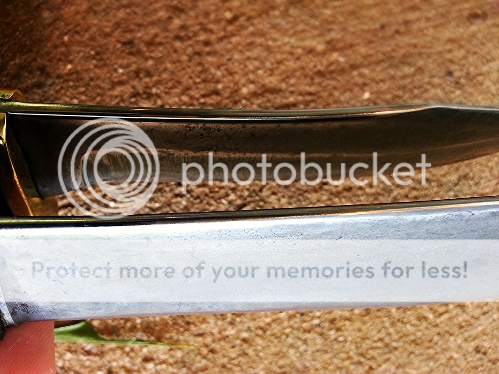

It cuts real good now that everything has been calmed down a bit. Also before hand (if you can see) the spine was really rough, probably just from being knocked around, used and abused. SO! Initially I just squared and cleaned it up, but after going back to the drawing board I decided it was in desperate need of a rounded spine... I like it alot. Also fixed the top swedge as it was a bit wonky. I liked the rounded spine so much I went ahead and rounded the spine on my Green River Belt Knife... This is hard to get a picture of since the spines are so tiny, but I tried!
Also did something a bit different on the Green River, the spine was sharpened to 90 for scraping/striking, so I rounded the spine up to the hump/drop point. Then I left the end portion/drop point, squared off and polished after the hump. So now I can still strike a firesteel, and the spine is o so comfy! It was also a little bit of a test for another idea I have later on.
Overall, no real time invested, but some big differences here (at least to me).
