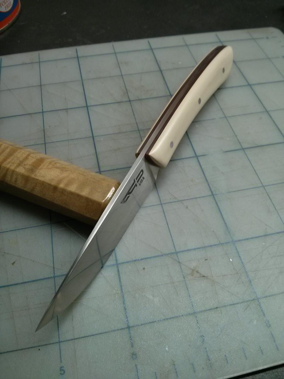

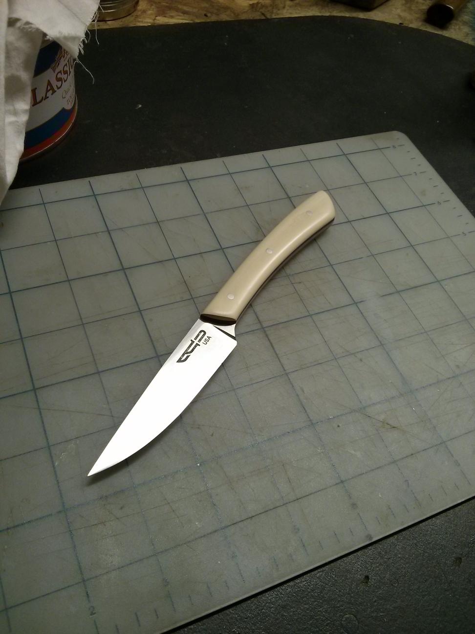

The pinstripe is ruby red. Stupid fluorescent lights.
Sick. :thumbup:
Thanks, fellas, glad you like it.
I'll get some natural light pics after it's been extracted from its wrapping paper...
CF, it's actually a smidge less tapered than I like! This was one of my first ~3/32" ground paring blades that's been in my drawer for about 3 years waiting for a handle. At the time, I was hesitant to reach for the FFG. You can see it stops about 0.100" short of the spine. Ideally that taper would start nearly back at the plunge! A FFG on a p-ground 3/32" paring blade is so lovely... stouter than factory, but not so thick as to be wedgy. Yep, I said wedgy. :D
