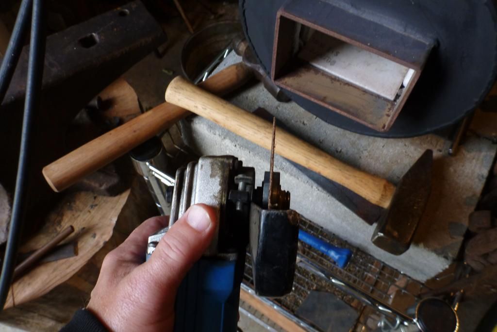

I am going to try it with my VS scroll saw and some metal gutting blades.....though I doubt it'll be very effective. What about an angle grinder, WW? Process is dirty as hell, but workable. Wheels are cost effective and the tools are pretty cheap and portable....
I just watched several youtube videos where people are cutting through steel with a jigsaw and i seen hundreds of jigsaw blades made specifically for metal so i figured id ask. Obviously people do it, but i dont know how long it would last doing it. Bosch even has a jigsaw made specifically for metal but it costs a little more. Just curious if anyone here has used one for that purpose.

I don't know about the jigsaw but I doubt it would work.

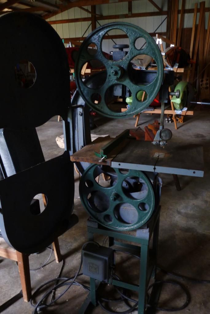

I thought he was talking about cutting off sections of steel to length. An angle grinder would be fine for that. Accurate, thin kerf..lot's of sparks. A bi-metal blade (for ferrous or non-ferrous) can be put on any band saw and will cut annealed steel all day long. You may have to look around to have them made up in the size you need, but it's not that hard to find a vendor. I have a 1938 Gallmeyer and Livingston band saw and I just buy 91 inch ferrous cutting blades for it. I also have a little yard sale band saw with a bi-metal blade and it cuts steel fine. Any band saw will work. If pics would be helpful, I can post some.

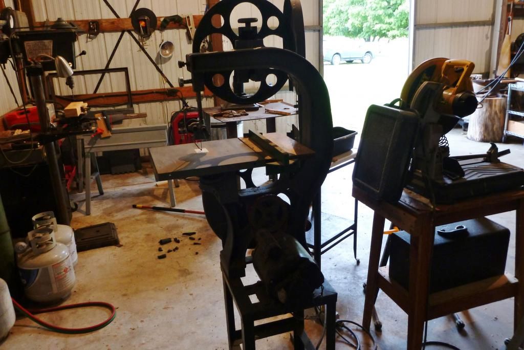

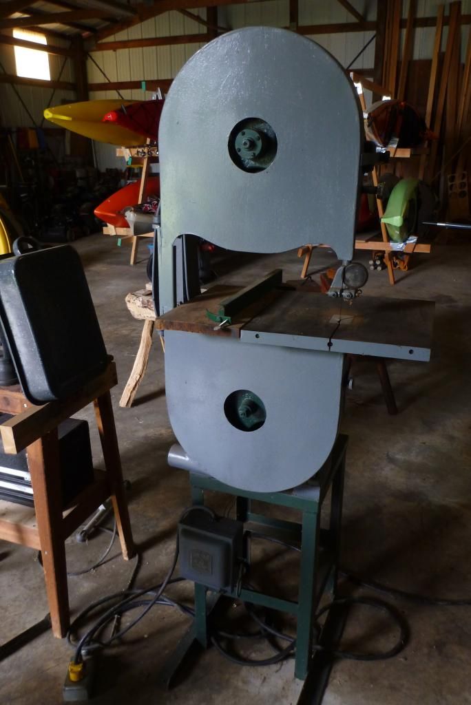

Here's the old 1938 saw.
I slowed it down by switching out the pulleys and a local hardware store makes up blades for me.

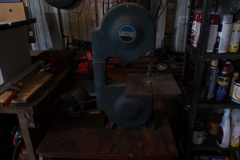

Here is a 25 dollar yardsale Toolcraft bandsaw. Same thing, I switched out the pulley.

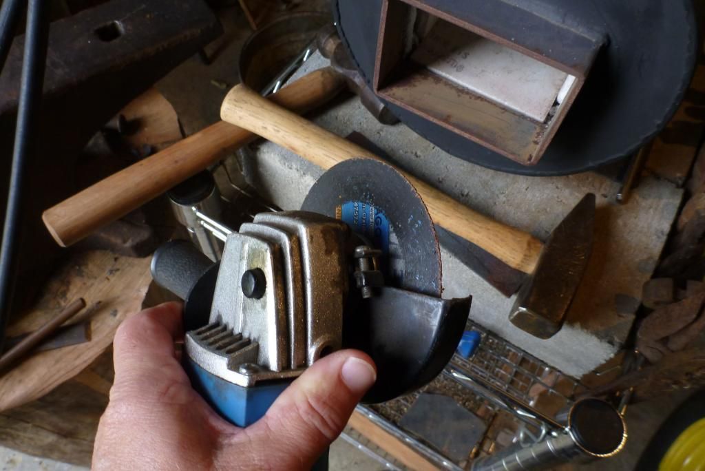

The 15 dollar Harbor Freight side grinder I've been using like a rented mule with cheap cut off wheel. You can see how thin it is.
Now, I am certainly NOT a knifemaker by any stretch, but I've made a few and done a fair bit of metal mangling. I use both those band saws to cut steel with no problems.
