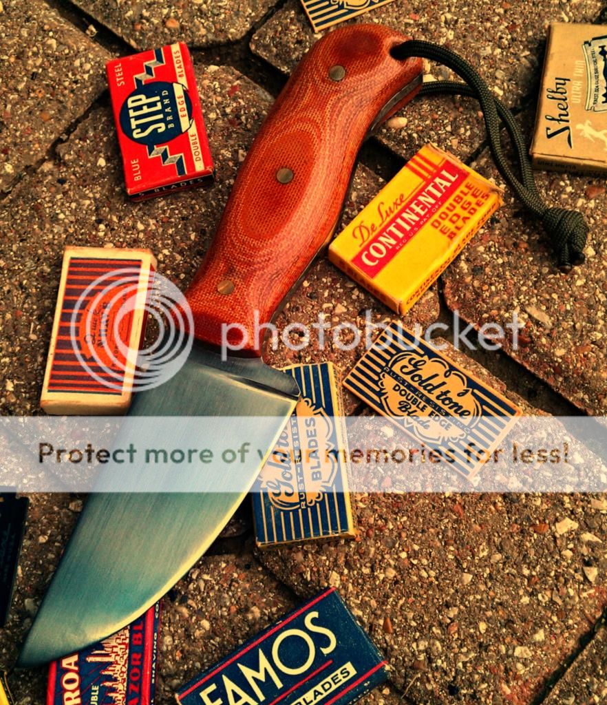

Speaking of that blade I guess I can drop a picture of it here for giggles. Almost done I think, getting close at least...

Sweet knife bud!!
