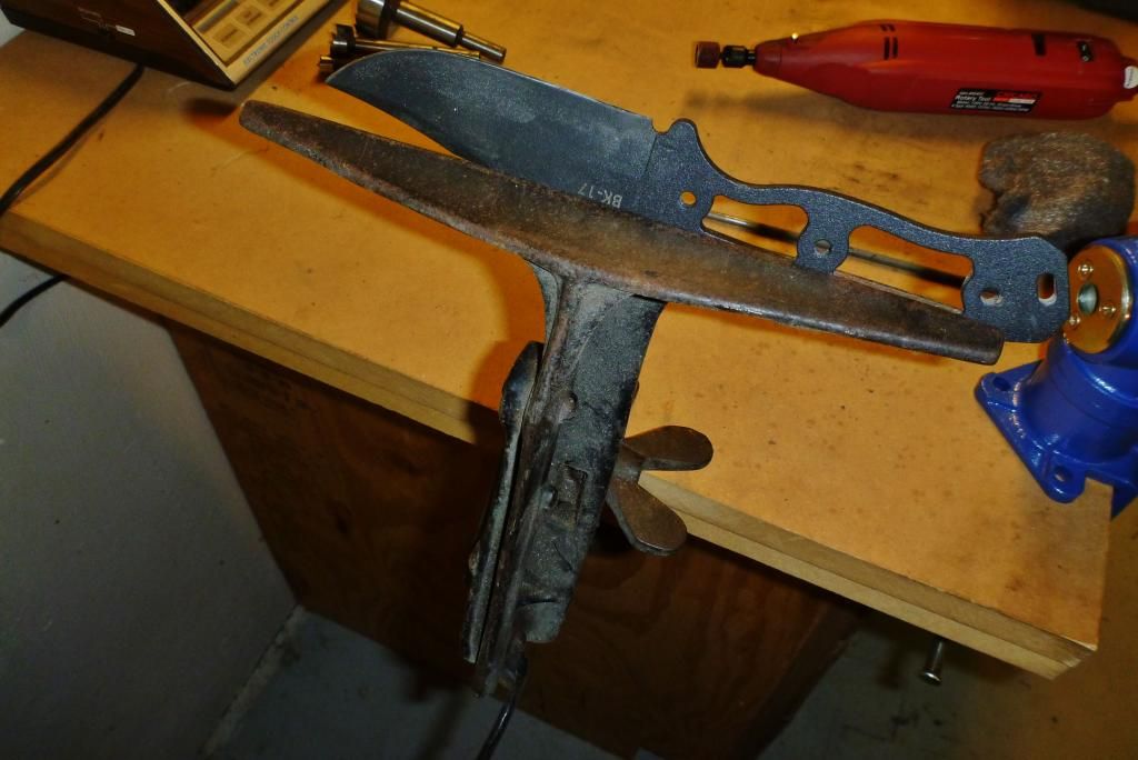

Im a big fan of being able to have my finger right next to the edge of the blade. Especially when peeling fruit, but all the time really, i just like being able to feel what im cutting as i cut it.
So i started slow, and didnt wear any gloves, soon as the knife started warming up even a little i stopped and dipped it in cold water for a minute to avoid ruining the heat treat.
But now i can have my finger right up to the edge. Its a SMALL mod, but it makes a lot of difference in use for me. I know everyone is not a fan of this, but its the reason i like choils so much as well.
I still need to clean it up some, and then i will go ahead and strip the rest of the coating and dip it in Ferric chloride to darken it back up some.... Just figured id share what i have done so far to it.

I bought an old Hay-Budden anvil today. Someone dropped it and busted off part of it, but I think it will still work for my uses.

I been thinking about doing it since i got my grinder but i have been talking myself out of it. Worried id screw it up. But tonight i just said screw it, i wanted it done so it was time to try it. First i profiled out that weird looking blade beside it just to get in the rhythm and then grabbed the 14 and took it slow. I like how it came out, could be prettier i guess but functioning wise its exactly what i wanted. Now i have more handle room and i can grip it right next to the blade.
The other thing in the picture is just practice. Im grinding out shapes like that just to practice doing bevels. i figure double edged gives me the most practice per piece of steel.
