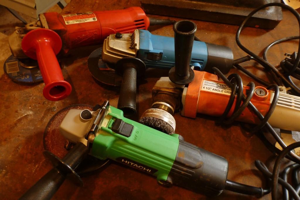

Final word on angle grinders. Get any of them. Mr. Terrio is right on the money. Use good cutoff discs. I have them from Milwaukee to Harbor Freight and they all work quite well. I do have a very good trick for you that I'll share on the phone with you when you get a chance. :thumbup:
Im ready whenever you have time! 2675352700, i appreciate it bud!!

Question for you angle grinder pro's. HF also has something called a "cut-off tool." Is that kind of thing not designed for the thick steel of knives? Is the angle grinder better than that and the way to go for someone who has never used one?
