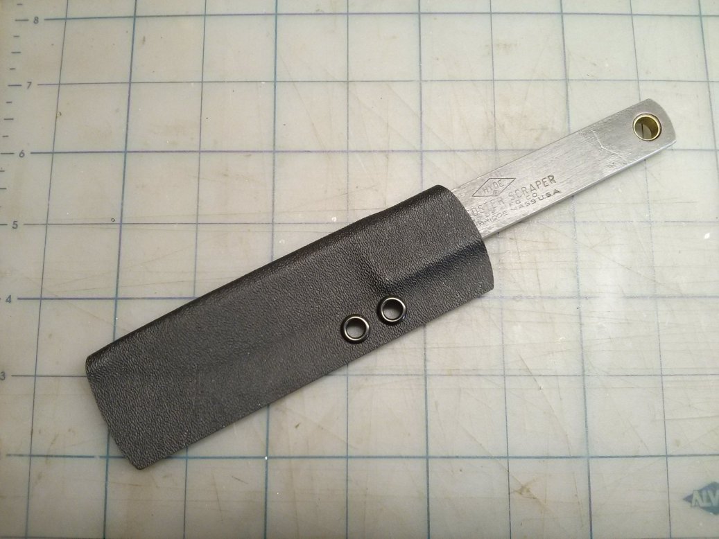

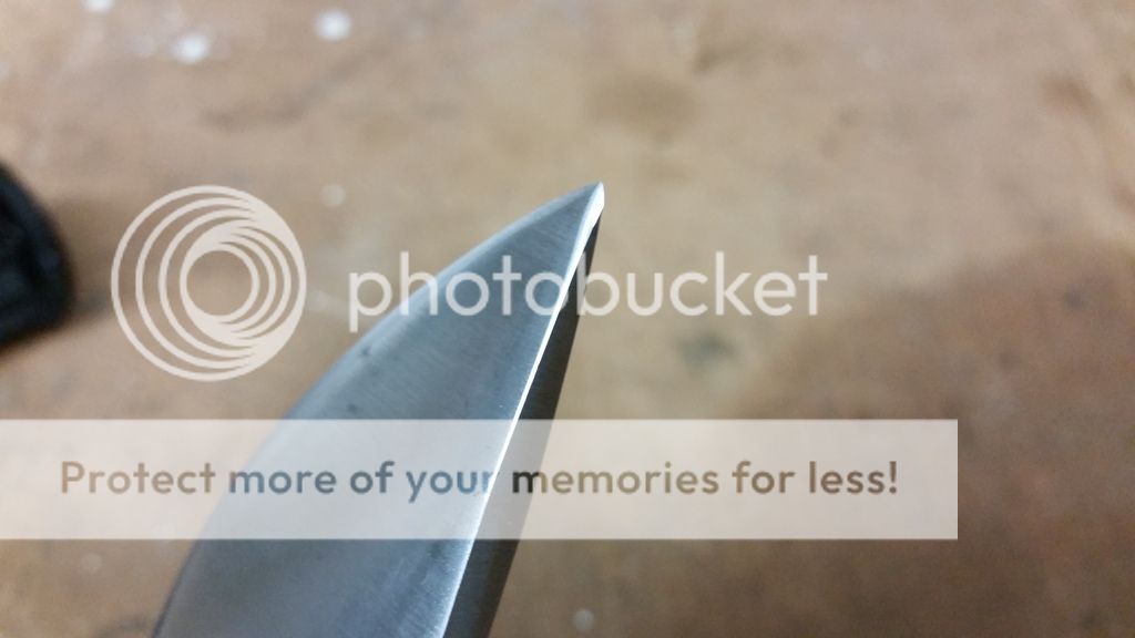

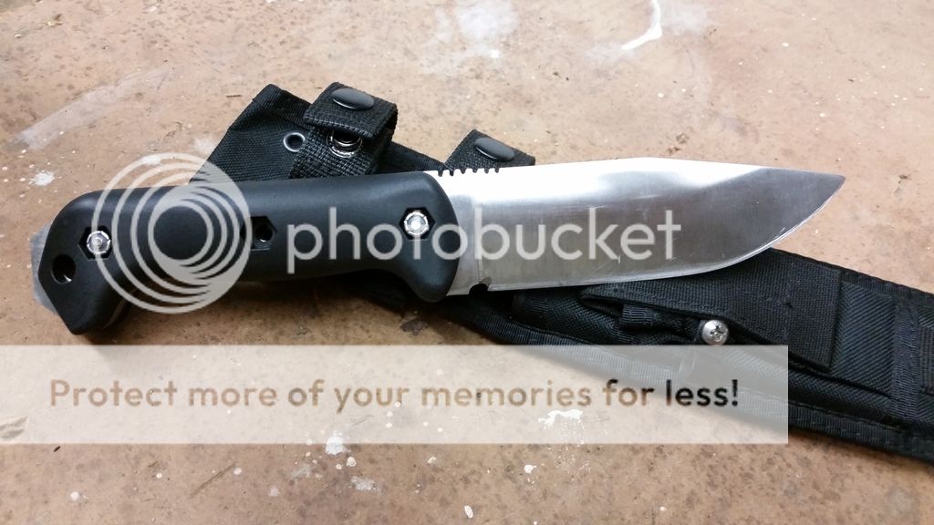

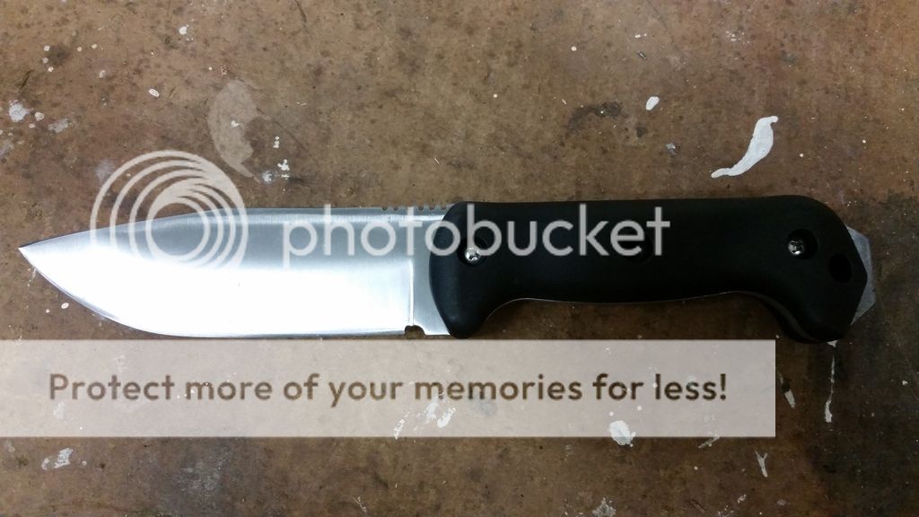

Don't mind the scales, just threw them on for the photos, don't want photos with no pants on do we?
Finally got the some of the mods finished up on the two (it has only been 4 months...)

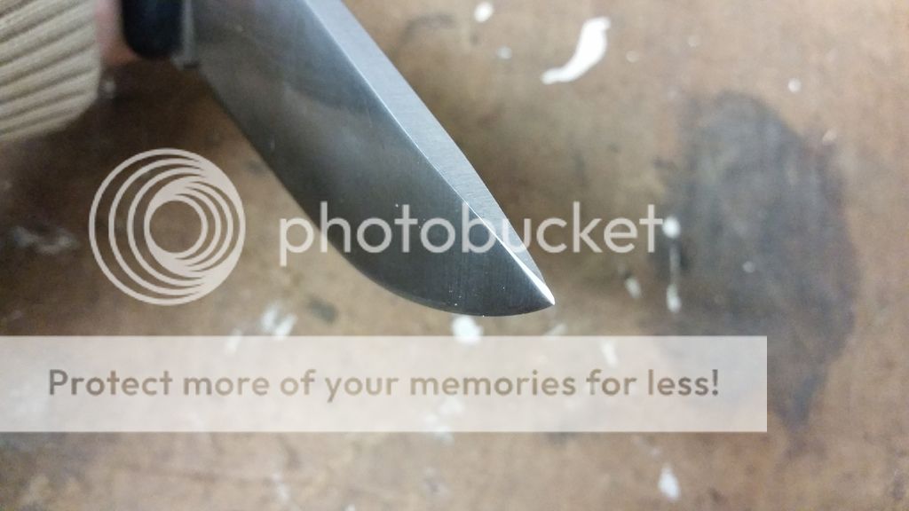

Straight clip with a penetrator tip.
The tip is just a Very small (about 1/8") tall secondary sharpened steep straight clip. It isn't much, but it allows the tip to cut through when piercing as opposed to wedging through.
Combined with the straight clip and the stout point, it makes for a good fat wood removal tool.

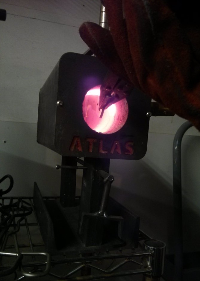

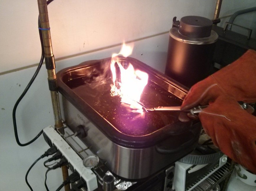

Hope this survives the fire:
Wow, ok. I thought most of them are a higher alloy tool steel and would require some soak.
Good luck and keep us updated!
I'm certain it IS a higher alloy, but I'll be treating it in a small forge. There's a pretty big risk of grain growth if I over-cook it by that method. It will likely come out just fine as far as any user is concerned, but I won't be able to make any claims about exact hardness. There's a reason I don't generally sell mystery alloy blades. Which means I may get to keep this one. :D

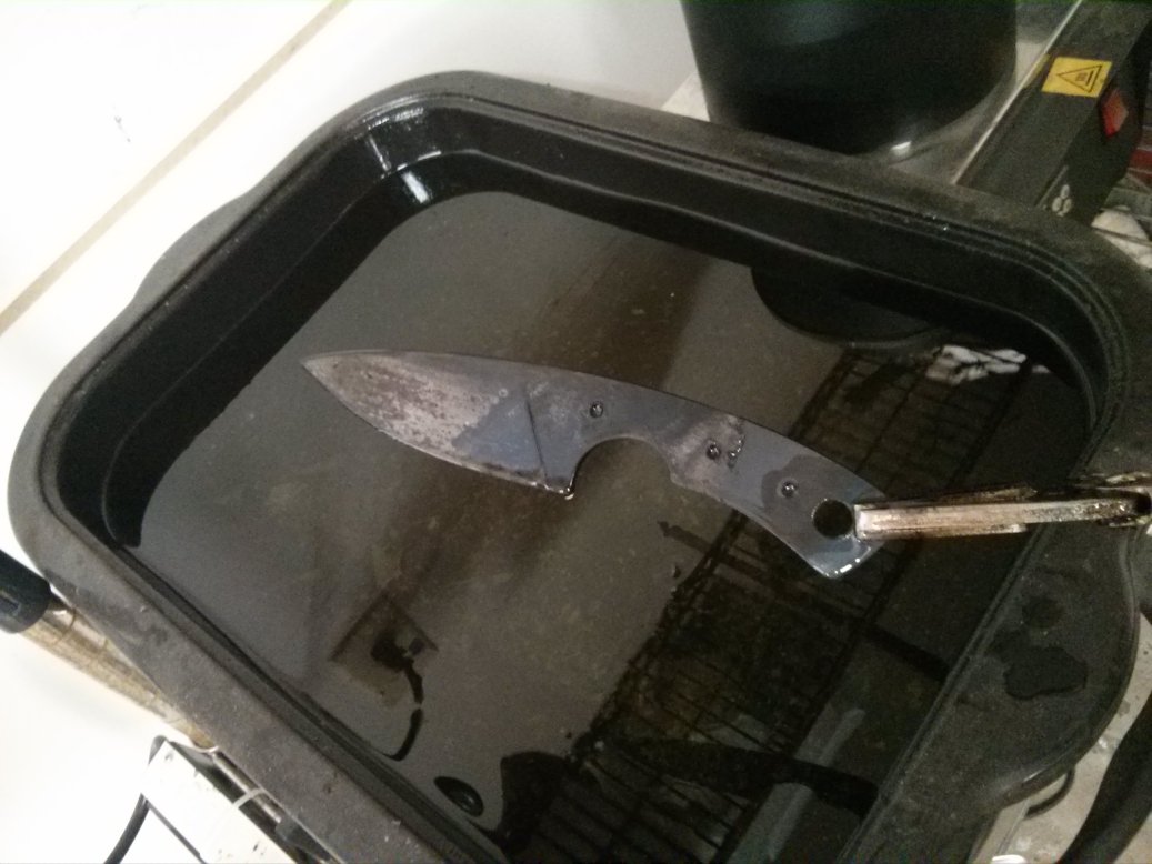

For those who were keeping score, the file knife took overnight to harden fully, which suggests to me that it's O1 or similar. It turned out wicked wear-resistant (discovered when polishing) when tempered at 1084 specs, so it's gonna be pretty sweet. That one is still in progress, but the scrap knife is done.
post heat-treat:

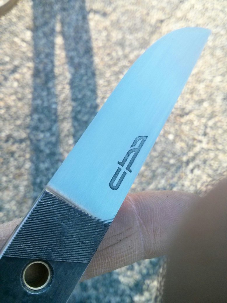

Daiz, nice, do you have an estimate on hrc? Have you used the scrap enough to notice any chipping?
I am loving the shape of that, I will be making a mini version from some scrap 1084 I have laying around instead of another kiridashi.
The scrap is 1084, and I'd figure it at 60hrc or so, which is my usual target. I haven't cut anything serious with it, but 1084 treated this way is pretty tough even at that hardness. Rolls are more likely than chips.
I haven't cut anything with the file knife yet - it will get an edge after the handle is done. But it's certainly harder than the annealed 1084 I tested it on. I could feel the hardness change dramatically about halfway up the handle (when sanding/polishing) where the quench really took effect, and as I mentioned it's very wear resistant like a good tool steel. As such, it probably isn't at it's 'best' not having soaked for a long time at temp, but I expect it will be at least as good as the 1084 with longer edge holding if the grain isn't too coarse at the edge. I'll feel how fine the grain is once I get an edge one it.

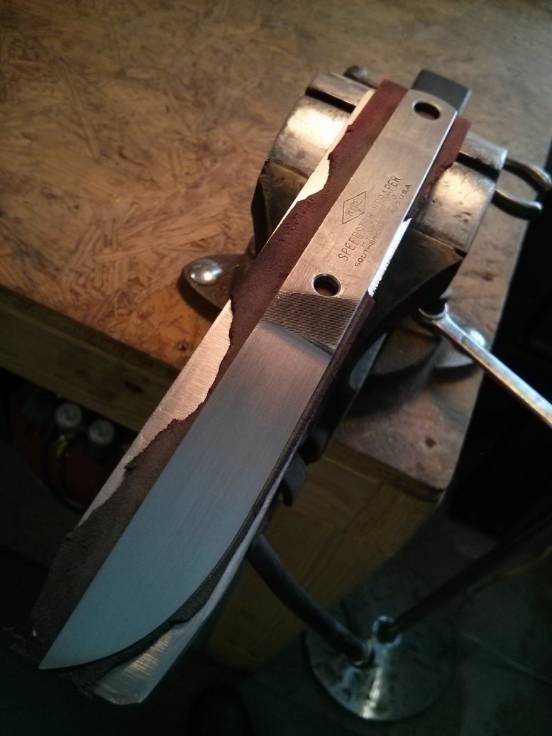

Flat is where it's at today: kwaikenesque Hyde Speedster Scraper annealed, ground, re-heat-treated, single linen micarta scale. Everything is at 600 grit.
Giving my 5 a good 'ol Fisking!
Taking it down to around .020 behind the edge and thinning the whole flat down along with it.
There were some depressions in the side that is shown as sanded, one about the size of a quarter around was dished in to the point that I had to run my 60 grit blaze to get the surrounding material off... It was as if someone took it from the temper cycle and leaned on it against a ball hitch...
It wasn't noticeable until I hit the flat with the marker and started sanding it flat, but it was a bear to get passed.
