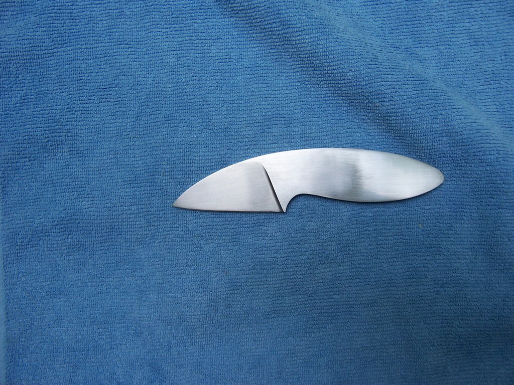

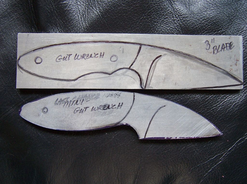

Speaking of scrap knives, here's a piece of 1084 I am making into a neck knife. I still have to drill and skeletonize the handle then comes backyard heat treat. LOA: 5.375", Blade: 2.25", thickness: .187".

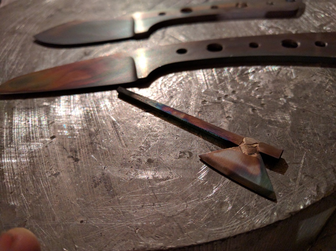

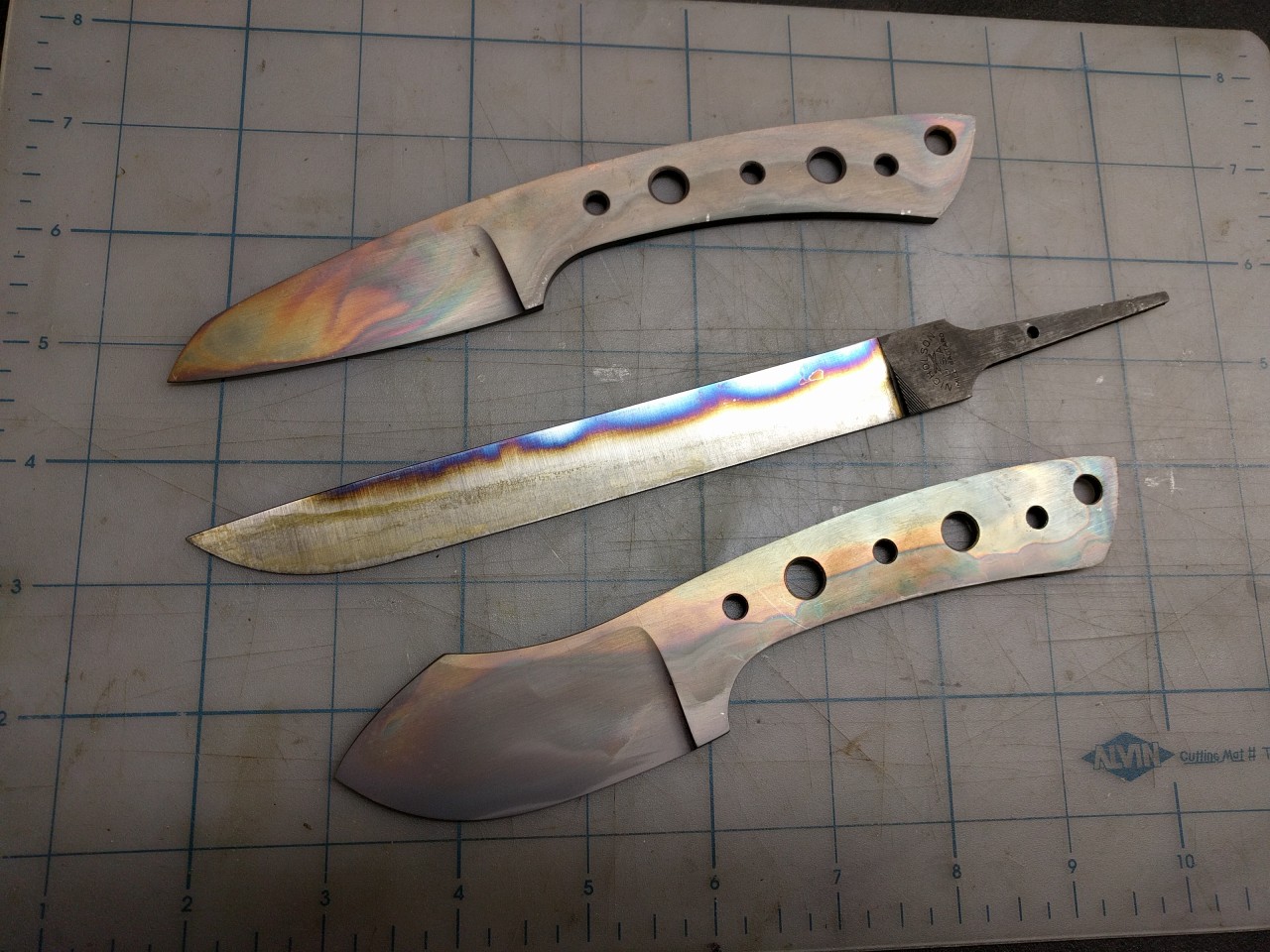

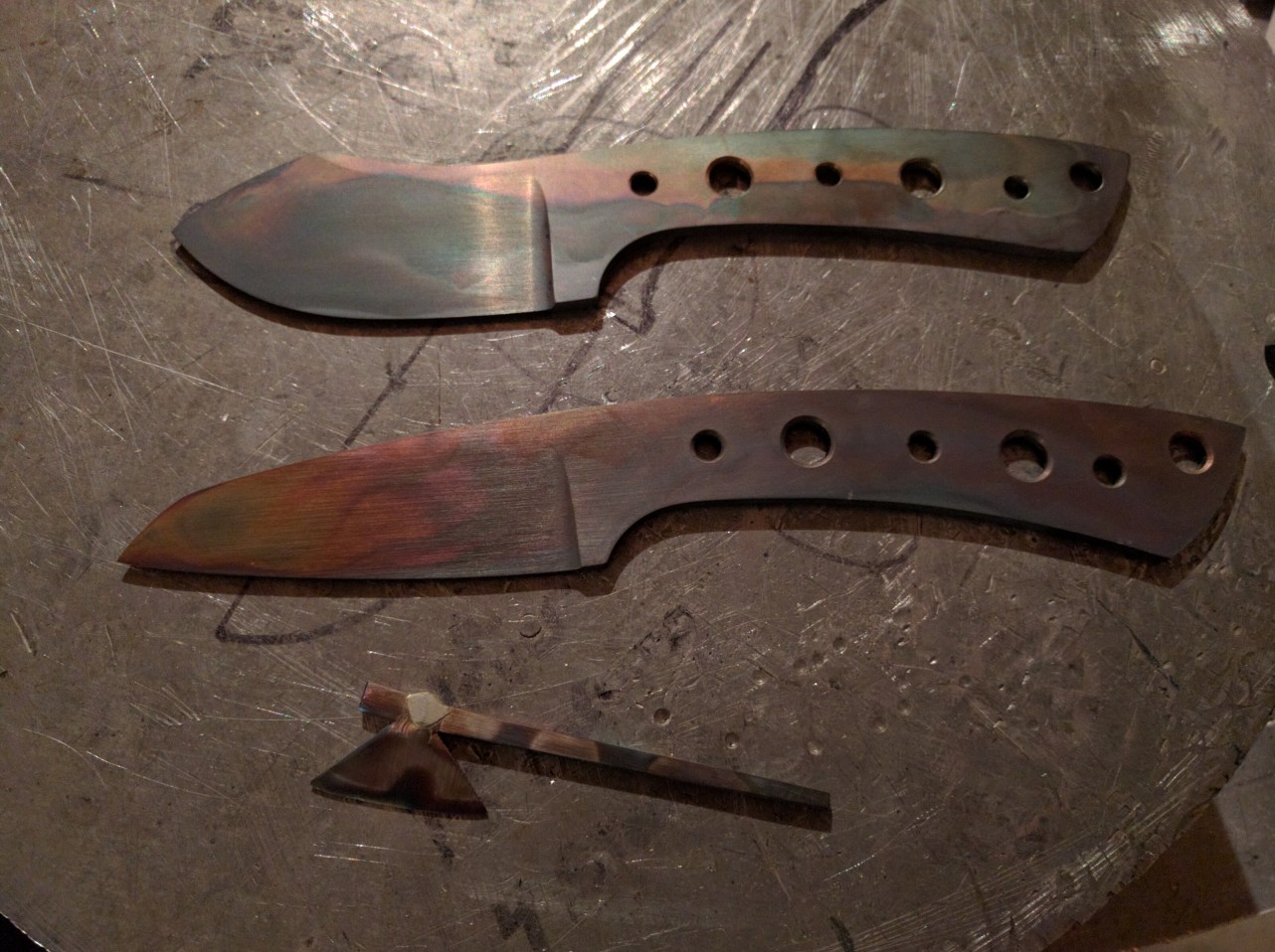

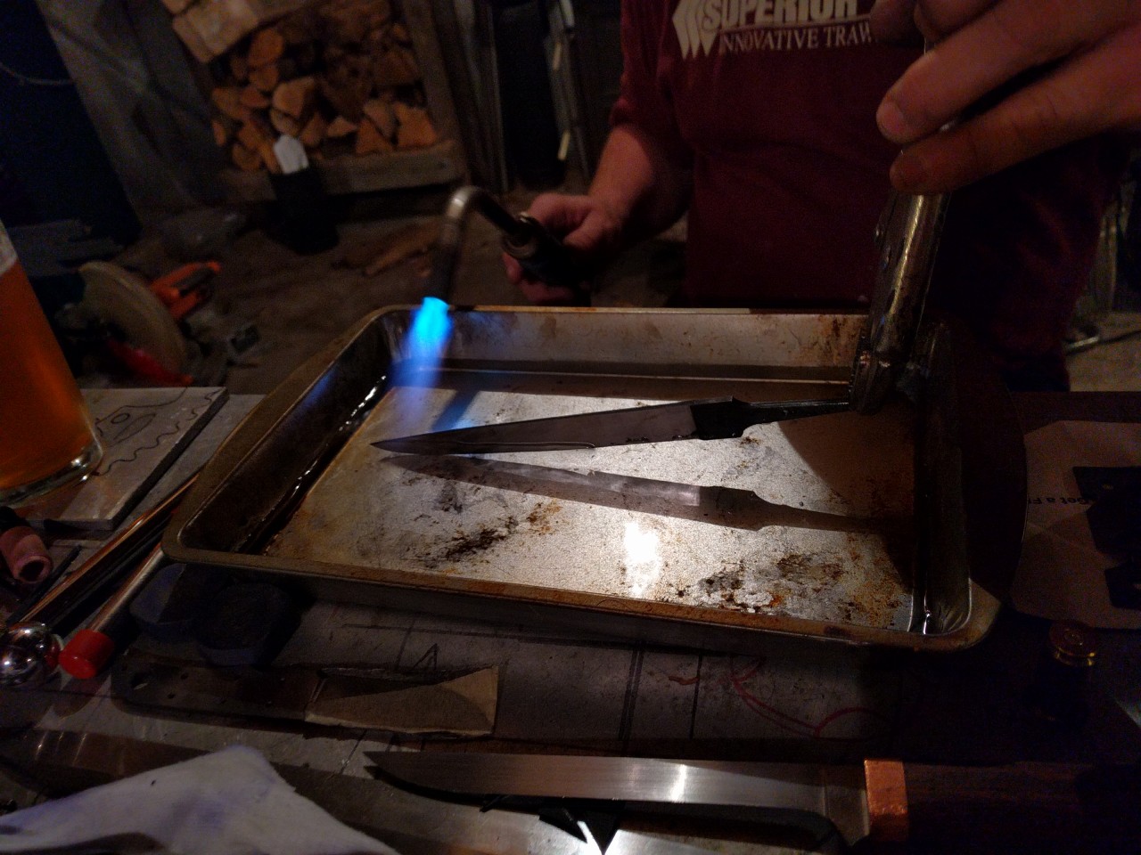

Cooked some knives tonight.
Hans made a mini battle axe out of CPM154 scraps, and then wanted to try a differential temper on my file knife.
Everything's in cryo now, finishing the temper cycles tomorrow.
Cool micro hawk. Is that a weld?
If the color line matches the hamon on the muk, it will be awesome.
Yep, that's a tig weld. The two pieces were leftovers.
The other blades will be polished. That's not actually a hamon, just surface colors from the oven. Sometimes I leave 'em on for stick tangs, and almost always for 'dashi, though.

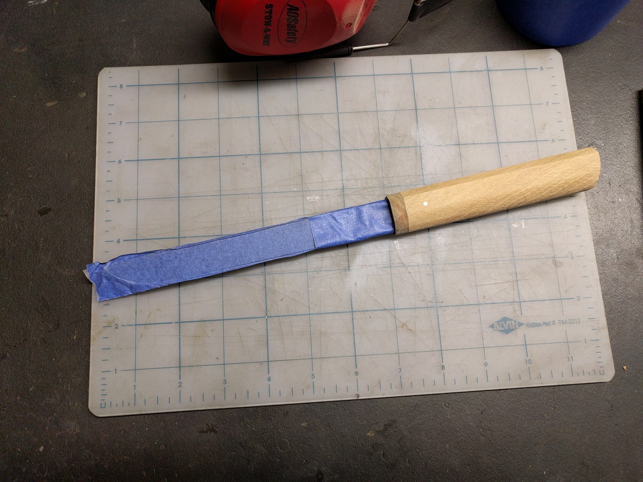

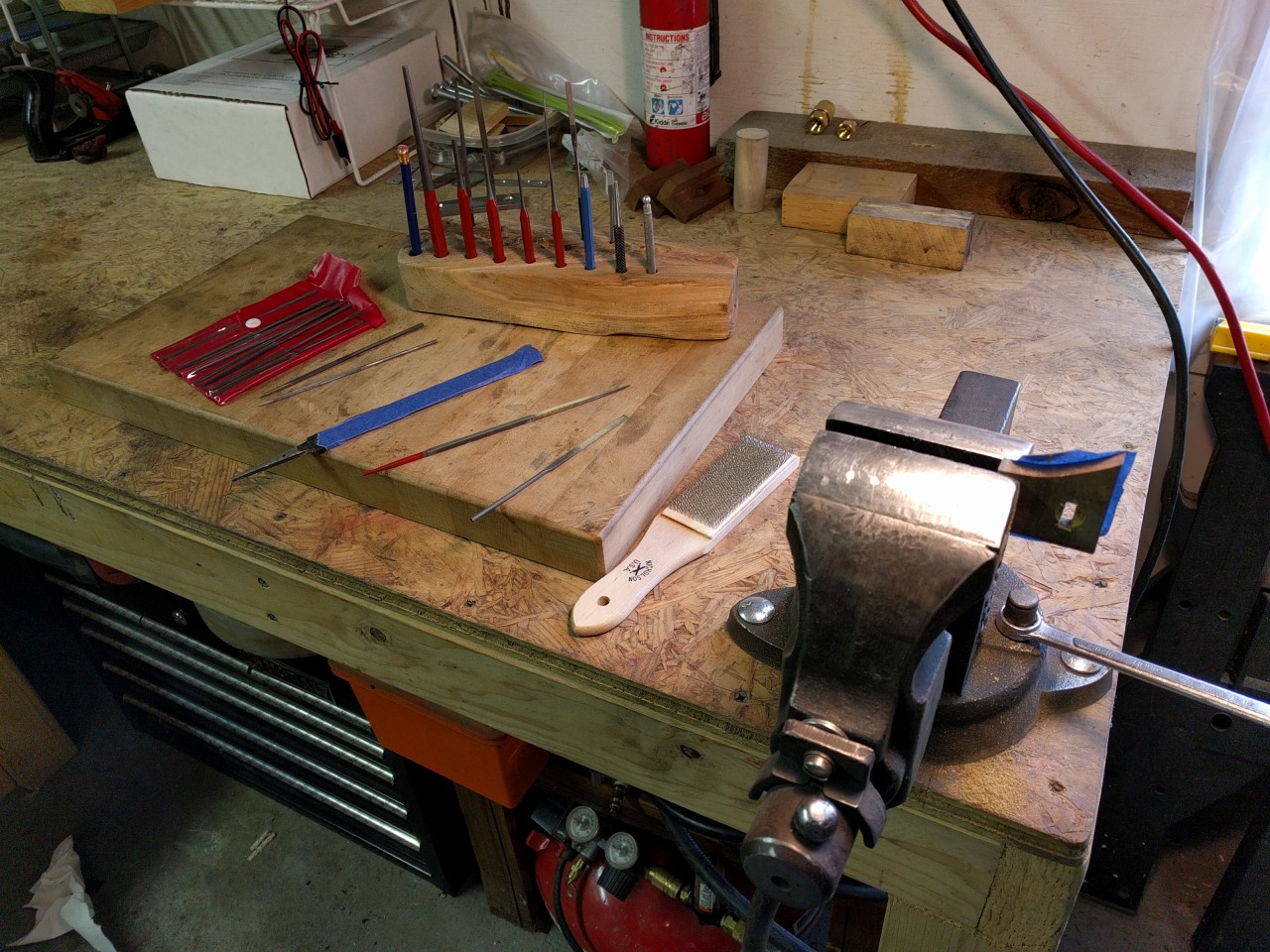

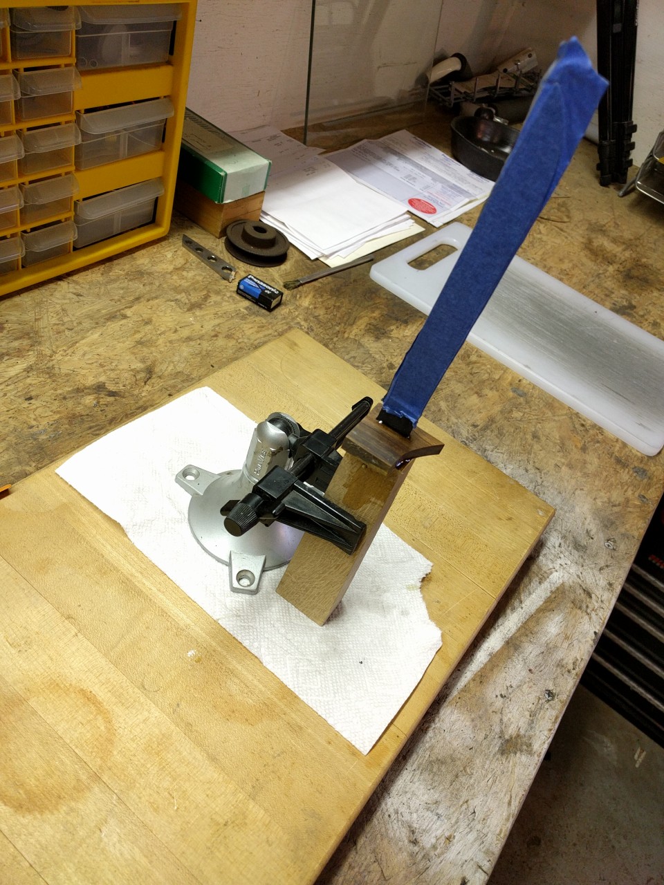

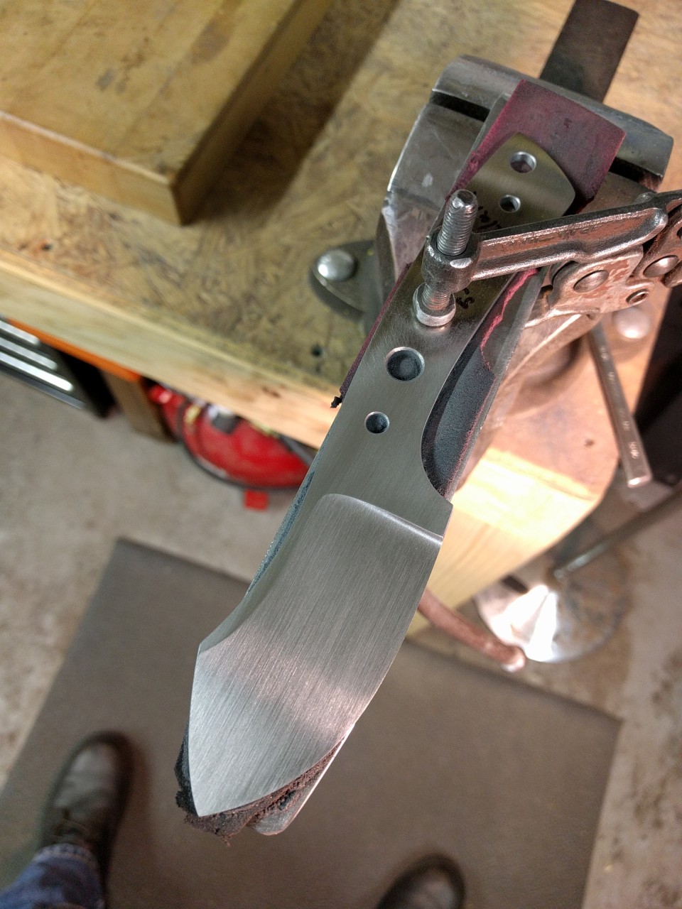

A build-a-long, sorta. Recycled materials and mostly recycled time, spent while waiting around for stainless blades to heat-treat. No hand finishing steel here:
