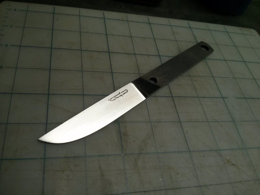

MMmmmm.... file and scrap knife.
For those who were keeping score, the file knife took overnight to harden fully, which suggests to me that it's O1 or similar. It turned out wicked wear-resistant (discovered when polishing) when tempered at 1084 specs, so it's gonna be pretty sweet. That one is still in progress, but the scrap knife is done.
post heat-treat:

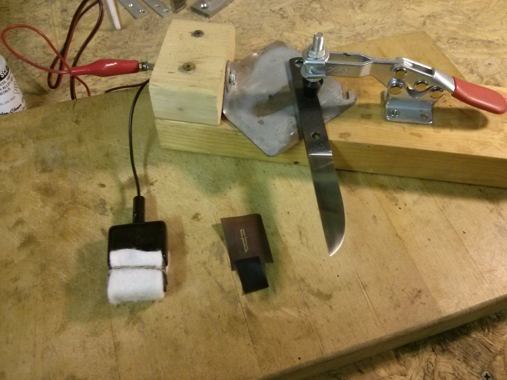

preparing to etch:
boo-yah:

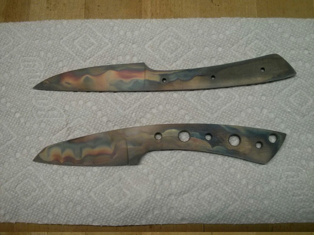

Couple blades finished tempering tonight:
Also did some cleanup, prep, and ground some bevels:

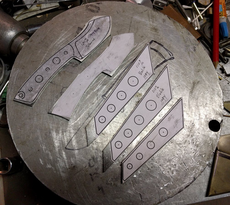

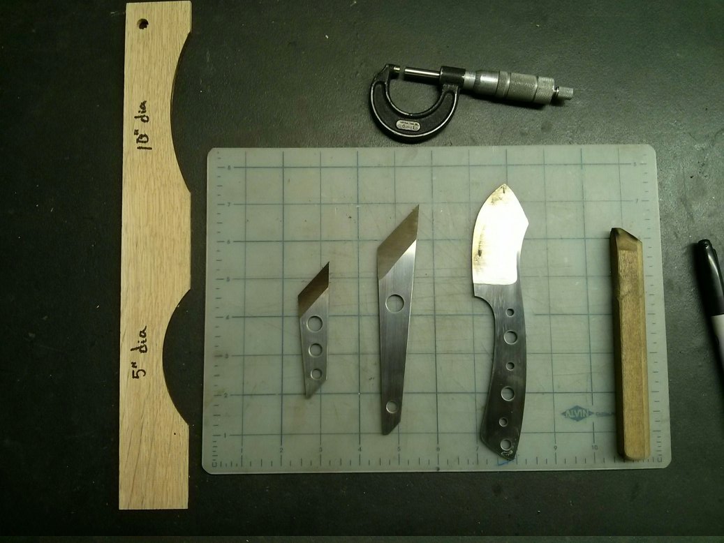

Wasn't ready for heat-treating at Knife Night, so I cut out some rough patterns to refill the beginning of the queue:

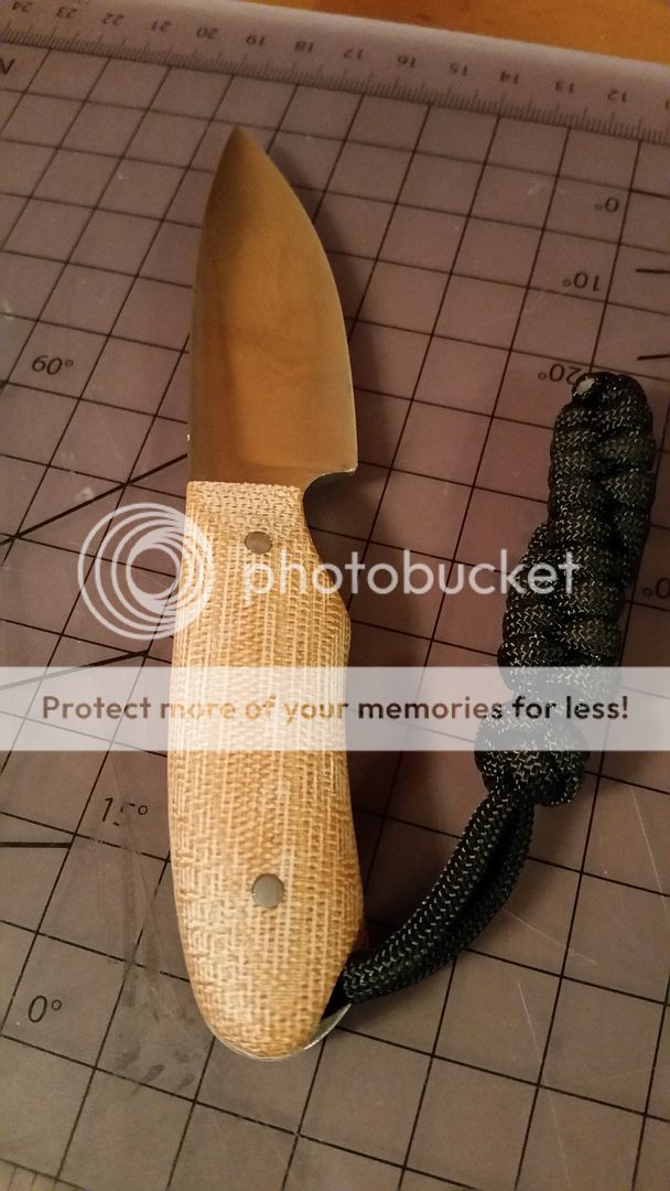

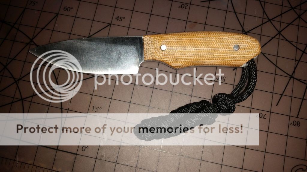

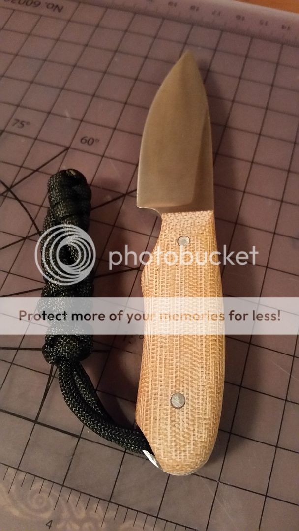

A guy I have been working with wanted a smaller knife to be able to work deer, small game and be able to choke up on for use on birds. On top of that he wanted a 3 finger grip but still be secure in hand.
He wanted the choil, which helps out nicely for indexing and wanted a lanyard but wasn't sure how comfortable it would be jutting out into his palm. So I figured I would use a hidden. Lanyard hole and a finger loop to get all 4 fingers incorporated and allow him to drop the knife and use his hands while keeping the knife at hand and reducing the risk of loss.
1084, natural canvas micarta and stainless pins.
Thanks guys!
Yep, home HT with a machine shop buddy tested my regimen to 60hrc avg over 10 knives.
Cut from 1/8" stock, 3 1/4" x 1" flat ground and 6 1/4" oal.
Finish is 600 grit then VF Scotch-Brite and a 400 grit wet sand on the slabs. If he wants to roughen it, that is his call.
Next up is some kydex I am going to bend for it tonight and then it is headed to its new home.

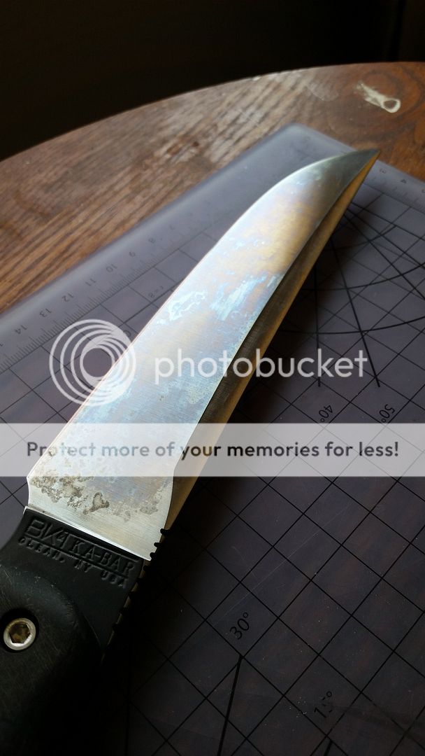

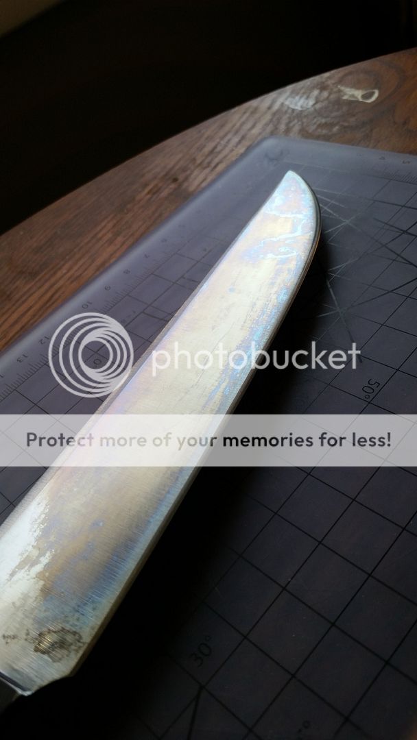

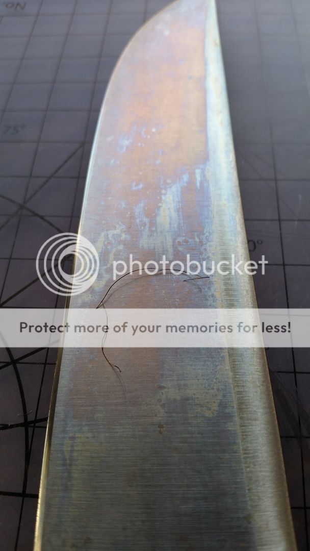

Gave my 5 a good ol Fisking. Thinned it behind the edge and flattened the flats.
In one spot right in the belly (on the flat, not the edge) there was an indentation that looked like someone took it out of a tempering cycle and leaned against a ball hitch with it.
It was nearly symmetrical in its circular shape, about the size of a half dollar around and deep enough that 120 grit would just barely miss making contact.
I took it up to 400 grit then to my medium Scotch-Brite belt. I have since picked up a few 600 belts and a very fine Scotch-Brite belt, so I might refine the finish a bit still.
But as it stands now, .025 behind the edge with a convexed edge and as you can see it is hair whittling sharp.
On to the pics.

You sir are one sick individual...
I like it!!!
I like it!!!
Thank you Sir.
It took a little bit of time with having to keep it cool and my belts not liking water (3m Trizact). I would take a pass, dip then dry, pass, dip, dry, over and over...

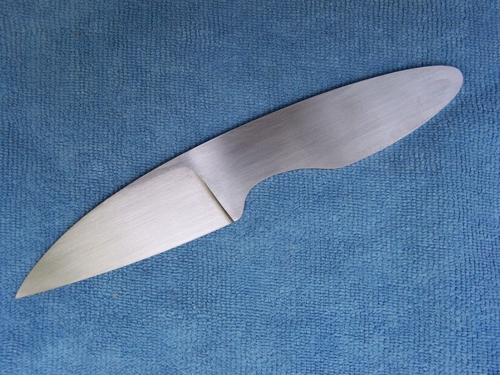

Knife #8 from scratch. 1084 from Aldo. .156" thick, 3.5" blade length, 7.375" total length. Profiling and grinding done on my Wilmont LB1000. I am getting a group of knives together for heat treat. I am slow, but who cares? I'm not a pro, although I do want to design and make a good knife. Next step, drill for pins and maybe taper the tang. My next Wharncliffe will definitely have a tapered tang.
You don't have to be a pro to make something nice....and you've definitely got the chops, pro or not. That blade looks good, slow or not. I've still got blank steel waiting for me to make something knife shaped. That is the definition of slow. Nice to see you are still able to pursue this, HH.
That looks gorgeous, Hawk, and I am not surprised. Though I'd drill before all that nice pre-heat-finish work!
1084 is a snap to heat-treat at home. I'd offer to do a one-off for you, but my availability is crap in the summer.
