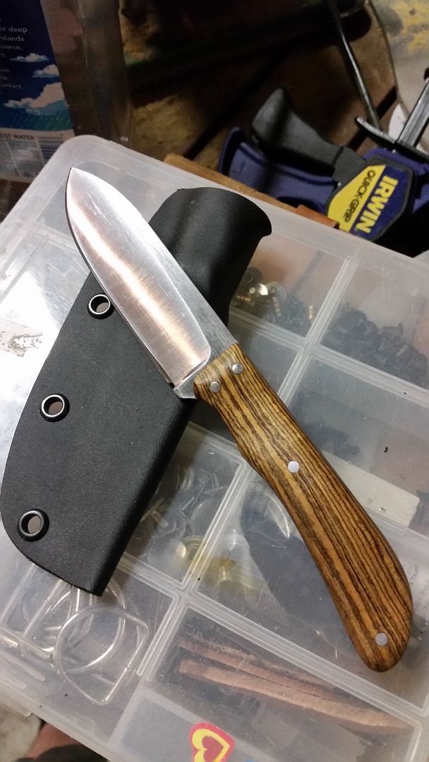

so far I like it, first time using it. Easy to work with, next handle I do with yellowheart I will take it to 800-1200 grit. The ones I've done have been left at 200-400. The little necker was "muddied" with oil at 200 and felt very nice.

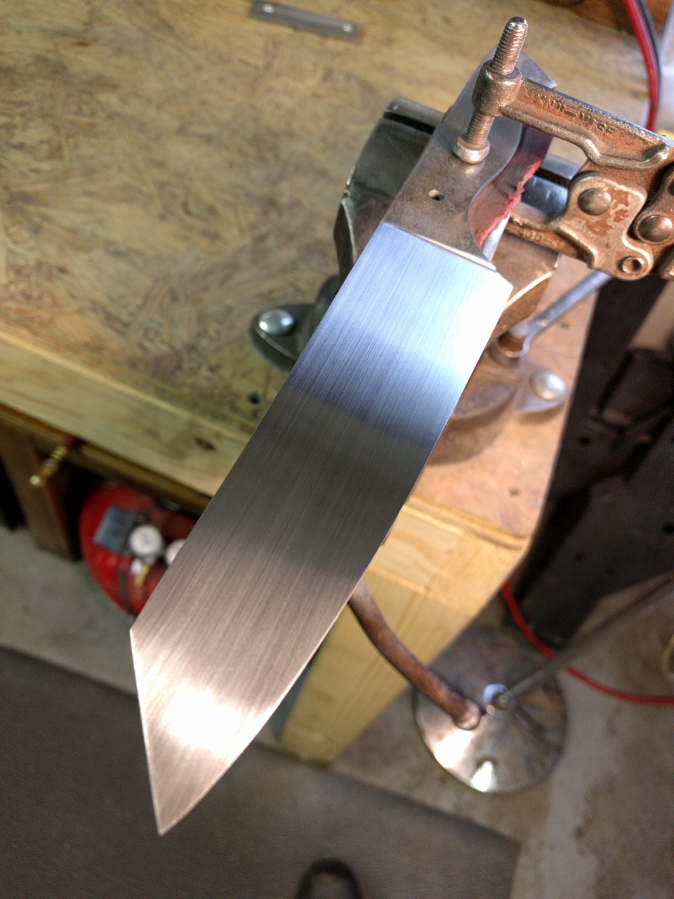

Dangit, Bladite, I can't seem to make one without that darn flaw on the underside!

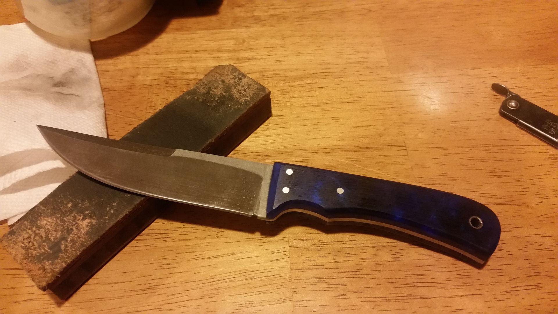

In my shop I've been playing a lot with the 1084, I've also got a little O1 I've been struggling with this time. I don't think it was properly annealed so it's been super hard and a pain in the backside to work with.

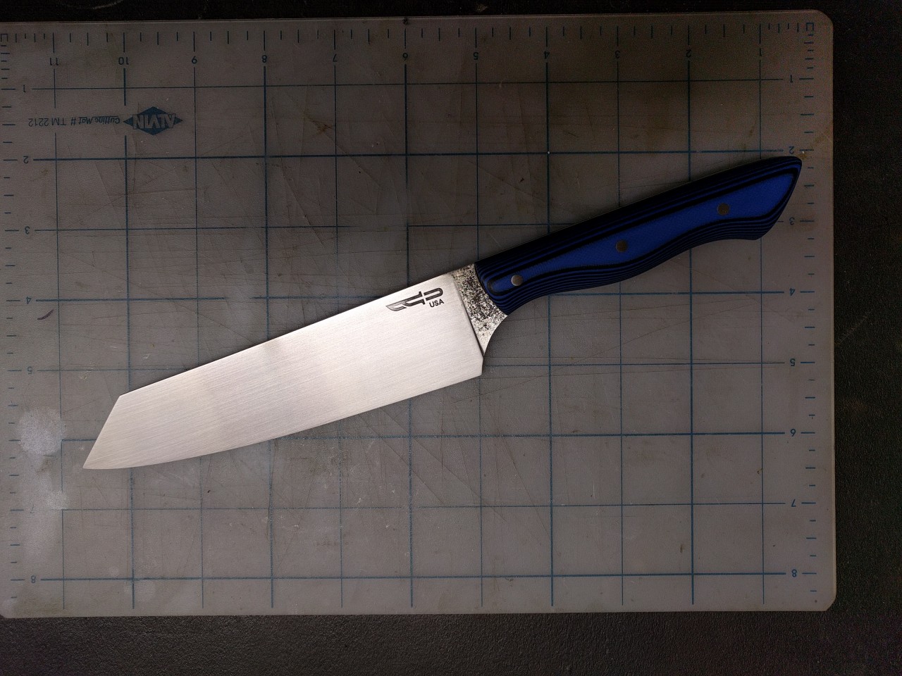

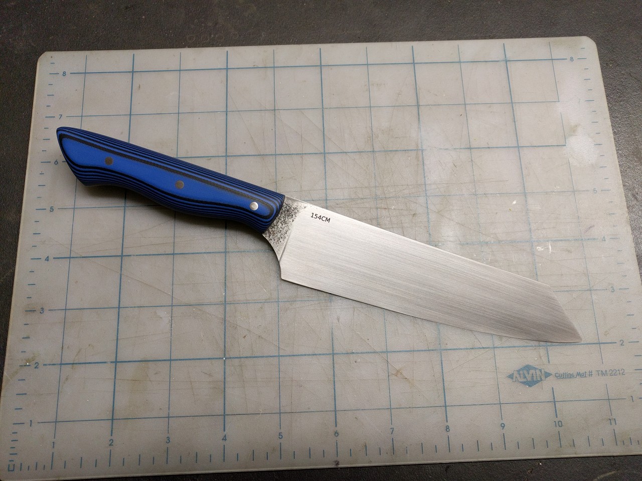

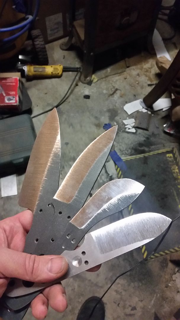

I tried my hand at a swedge; Bk15 style. I'll need a lot more practice with that! Damn. I've been refining my grind lines; learning how and where to apply pressure.
I recently added a ceramic plate to my platten so my flat grinds are a lot flatter; which makes me happy.
Anyways, progress pictures.

That swedge was ballsy. I still haven't attempted one of those yet, though do have one planned...
If your O1 is too hard, you can bring it up to a dull red and stick it in an ash bucket or 450F oven or something to cool it SLOWLY. O1 can air-harden a bit.

The swedge was crazy hard! It's not even but it's close.
I just don't get any O1 from the supplier again that for sure.
