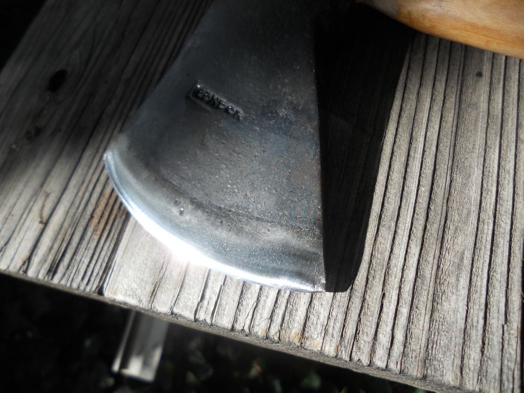

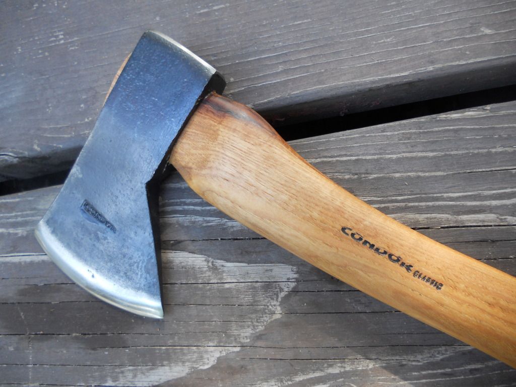

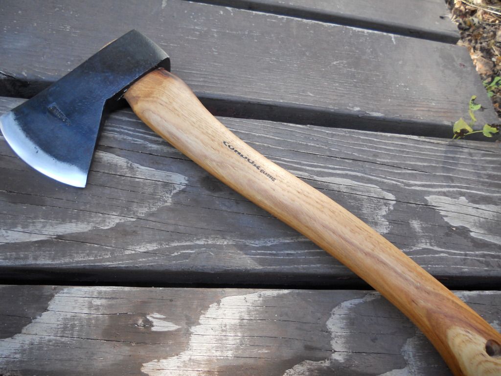

Got myself a Condor Greenland Axe this week.
Like all of the Condor line, it needed a bit of work to be really great. That's not exactly a deterrent to guys like us, though, is it?
The handle was a bit rough on one thin section on the left side. Not bad at all, but not totally smooth. I hit it lightly with a sander and smoothed it right out. Took the logo out too, a little, but I don't really care about that. Then I went over the whole handle with some more sandpaper to even everything out. Now it's nice and smooth. After sanding, I gave the handle three coats of natural Danish Oil. It darkened the wood a bit, but mostly left the color unchanged.
The grind was pretty good and the edge geometry is well done. Some of the reviews I've read from a couple of years back said that the Greenland's cheeks were too thick and the head came loose easily, but it's obvious that Condor has been working on its quality control. I only needed to fix a little bit of a rough angle at the toe, and of course to sharpen it up. The edge wasn't horrible, but it needed to be honed some. There was some kind of lacquer coating the head, I assume to protect it from rust while it's on the boat, and I needed to take that off too.
I used my Work Sharp to hone the edge. I actually used the 80, 220, and 6000 grit belts to do the work. Didn't take very long. I finished it off with a worn 6000 grit belt with some Brasso on it, then stropped the edge. Now it will slice paper cleanly.
Shiny.
I took it out back and did some chopping on some hard, seasoned wood, cutting through a log about 7 inches in diameter. So far I can't tell the difference in performance over a higher-priced axe. It chops great, and the handle stayed rock solid. I even tried to do the preliminary steps towards carving a spoon with it, and it notches and carves just fine.
It also comes with a nice leather cover. Very thick and supple.
For fifty bucks or so, you get a lot of axe for the money.
