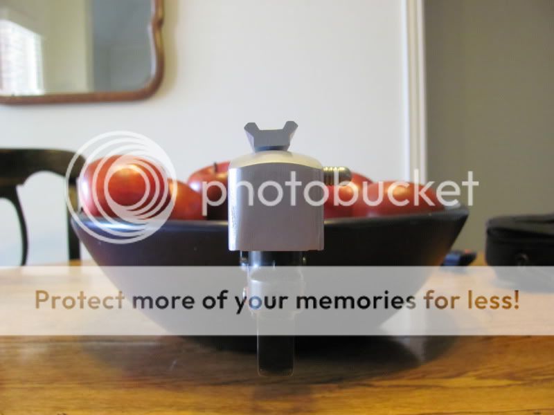

Apologies for any confusion, CA. I was assuming the pics were self explanatory. According to the best assessment of my gunsmith, and myself, the taps in the barrel for the scope rail were not drilled in the proper location, causing the mount to cant off center. The stock was also inletted badly off center, causing the barreled action to cant to one side, and the magazines to hang up instead of dropping free when the mag release is pressed. The stock inletting also causes the forearm to bind into one side of the barrel, whereas the design is supposed to free float the barrel. This binding is also the likely cause of the FTF (failure to fire) ~ every 10-12 rounds. The offset in the inletting is easily demonstrated my counting the layers of laminate on either side of the magwell. The gun was at my dealers for ~ 7 days before I picked it up, and spent another 12 days in my safe before I took it to the range where the problems became apparent. Realizing that I should have noticed the issues immediately, I offered to pay return shipping on top of eating my transfer fee. Instead of working with me on a solution, Md 25v immediately mentioned his lawyer, then proceeded to call me a liar. I continued to be professional, but did let him know that he would be exposed in order to warn the online community about his dishonest practices. Before the deal went south , I had asked him for his username so I could leave positive feedback on the forum. After it went bad and he had deleted the ad, he still refused to give his username, and informed me that any future emails from me would go to his spam folder. I can only assume that since most forums prohibit the posting of personal info, Md 25v assumed that he wouldn't suffer any consequences since I didn't have his username. Md 25v has claimed I bent the mount, and the pics show that the mount is not bent. He has never addressed the stock issue, instead he blocked my emails. I discovered his username yesterday, and began to make good on my word. I think the real question is whether Md 25v is the type of seller we want on our forums.

The rail in the pics is what the seller claims, in his own post on pg 1., that I bent by dropping the gun. This is the reason he gives on why it sits crooked on the gun. I posted pics of it to show that it is straight. If your going to post, please read the thread.

1) To me, and I'm no expert, this is the only pic that appears to back up your point. If you wanted us to see what is wrong, it would have been better to show a bunch of pics of that, instead of a bunch of pics of what is not wrong on the gun.

That mount is not bent. It is the design of it being a very long cantiliver that sucks. Since that 10/22 is a more than likely a put together kit gun from components that are bought separately I am not surprised that you could have a less than perfectly straight mount. That Green Mountain barrel might have the holes drilled a few thousands off center in relation to the centerline of the action. The action, due to its own manufacturing tolerances could be off a "hair" to the opposite side, still within its allowable manufacturing tolerance. This tolerance stackup, in conjunction with the slip type fit of these barrels in these 10/22 actions could easily cause a cant like that shown in the OP's picture. All of that thus not necessarily make the gun any less accurate. It just looks crappy. The stock is definitely inletted off center but even that should not affect the accuracy of the rifle other than possibly having to sand a little bit on the part of the wood touching the barrel. If the stock manufacturer is going to replace it then at least that is once issue resolved.
