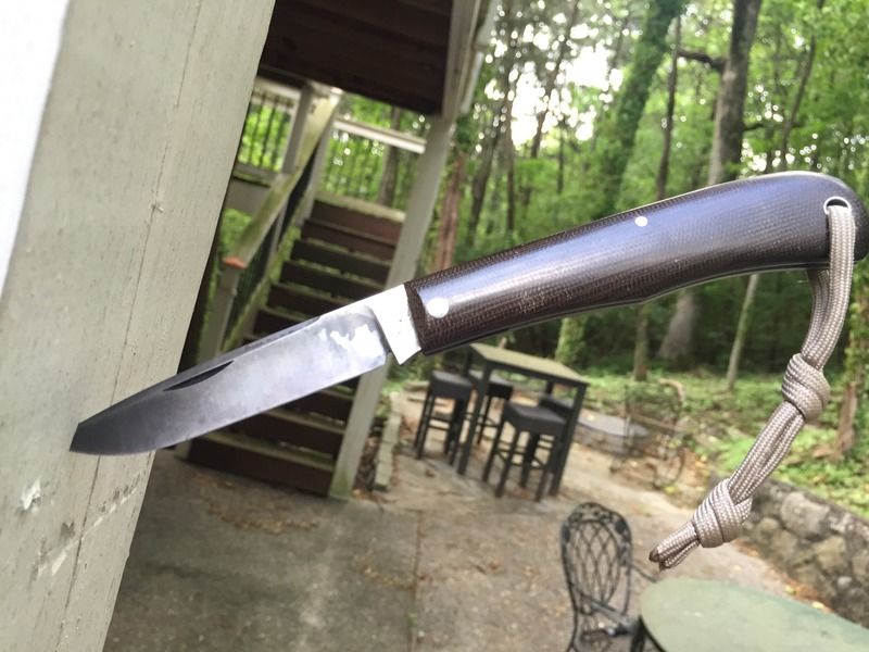

I just got this one back after a buyer returned it. I'm debating on selling it again....but isn't it perrrrrty. I've used this one so many times over the last several years and there has been 0 blade loss. The edge has held up so well that I have only had to lightly touch it up with a ceramic stone. I think CMP10V is some of the best carbon steel out there. This stuff is made to be used, and not kept in a safe. It's the toughest folder I own.

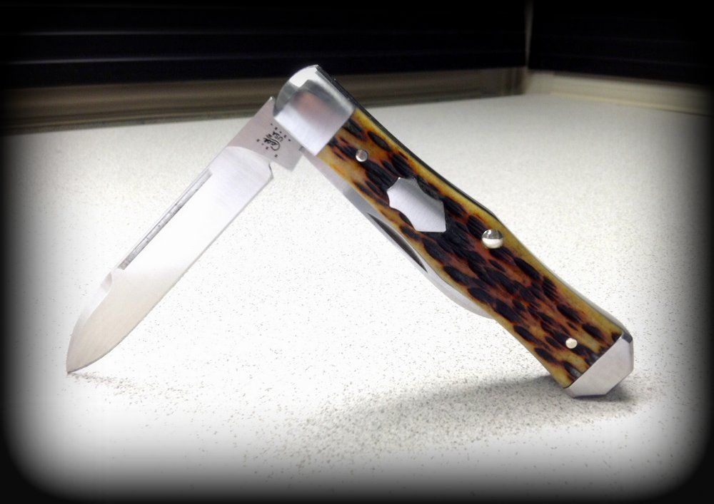

I've owned a few of the Bose/Case collabs over the year, picked this one up recently, nearly lost it but came to my senses in time ;)

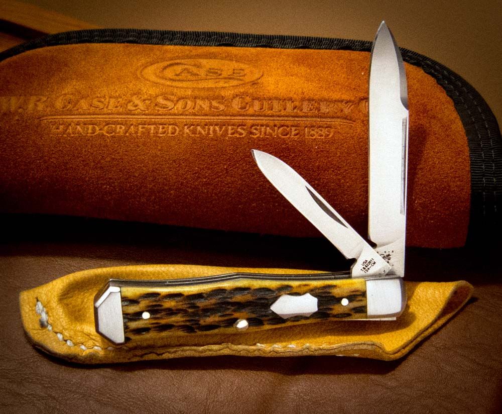

What Primble said. What a svelte little knife! I bet that would disappear in your pocket and do 95% of everything you'd ever call on a pocket knife to do.
