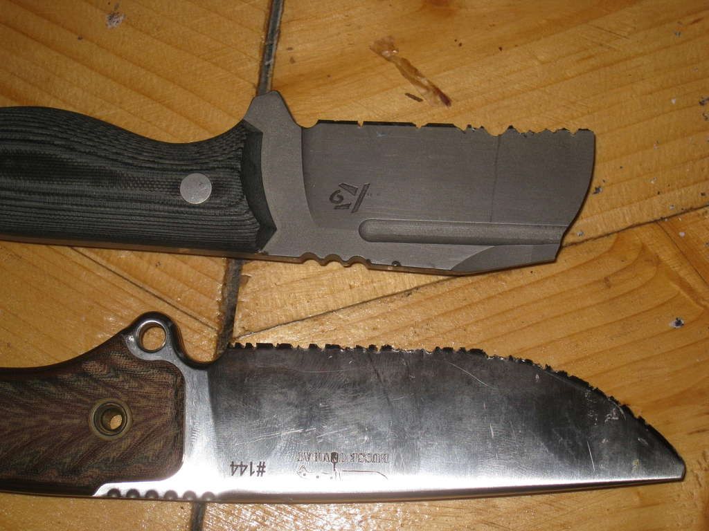

This pic demonstrate the superior toughness of INFI very well.
The Busse is SAR4 with FFG and 0.22" thick INFI... the another knife is K9 Dingo made of 0.25" thick CPM-3V heat treat by Paul Bos to 59-60RC
I know geometry play big role in this kind of destructive test but at least you get the idea.
^^^what's the source and context for that? What the hell did they do to those knives?
