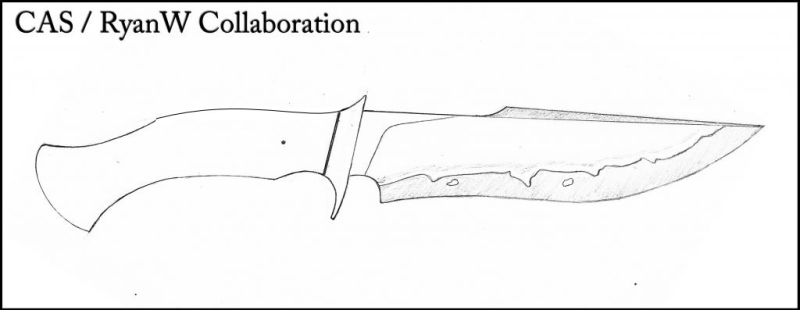

I like the top hump of the handle but the distinct angle of the front section to the back is better in Ryan's.
I prefer the lines on the underneath of Ryan's.
Your butt could be interesting though. :D
How about S-curving the top of the handle? Following the guard curve down into the handle then back up to fill the hand?

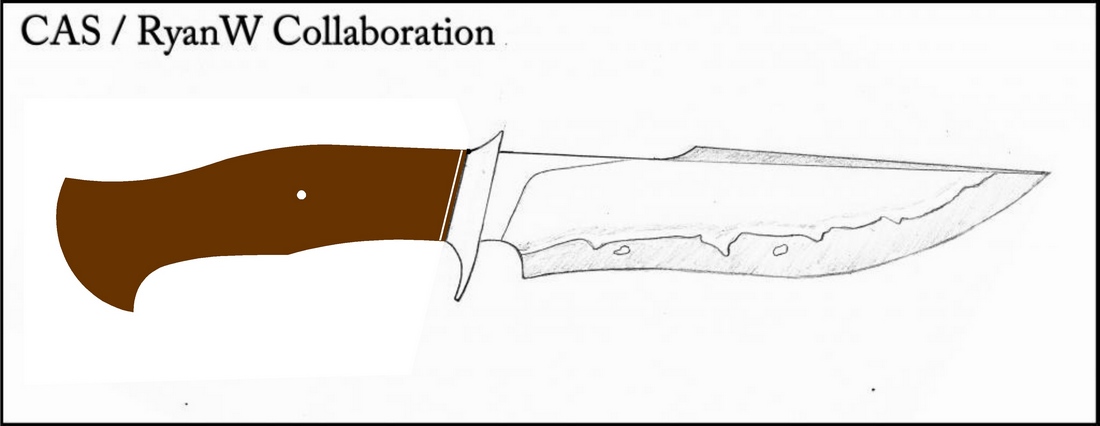

Looks like fun. Have you thought about some Amboyna as another wood option?
Sorry I somehow missed your post Matt. I love Amboyna, but don't have any on hand. Thought about KOA but that has been played out a little IMO.

Here is the final design, I want it to have the CAS look so I based most of the handle design on his version with a few personal preferences.
Looks great! If I might ask, being a novice on design and such, what's the function of that curve at the bottom front of the handle? Aid in chopping? Lock it into your grip better? And the flat at the top is an indexing aid, right?
Thanks everyone for the comments, Mark you CRACK me up!
Crimson, This knife won't be for chopping. If you are at a knife show and see a knife with a contoured handle like the ones on a Wheeler, Knight or Claudio (Many others out there) ask to pick it up. You will find out how comfortable they are. The only way I can describe it is the entire handle makes contact with the palm of your hand. It gives an amazing amount of control and is very hard to get right.
