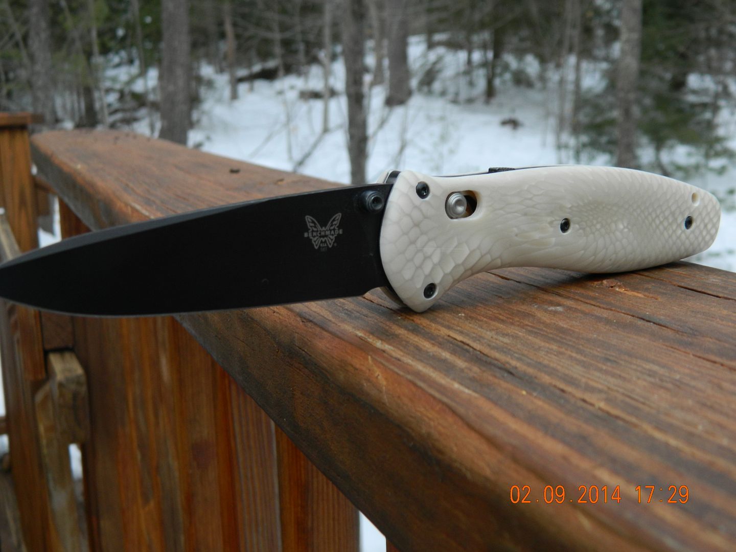

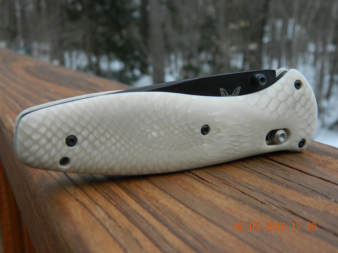

I have to admit it was quite a lot of work over the past three days pretty much non stop. I just have very simple hand tools and a dremel. Quite a lot of sanding and threading standoffs. I will be doing one or two more of my personal knives, but I will have to wait a while to rest up. Hand and back took some punishment.
You may notice I did use a different technique for fitting the mini-griptilian liners in the scales. The metal liners sit in the G-10 (black) liners. I simple cut out the shape in G-10 using the liner as a template. The axis lock recess is in another G-10 liner (orange) along with very minimal inletting of the linen micarta scale. This particular approach reduces the need for extensive milling and keep the metal liners sitting square in the scales. I thought it was a pretty novel idea and I was apprehensive about milling out the liner shape one slab of handle material. Pretty stoked it all worked out.

That's an awesome Idea, I was typing up my previous post at about the same time you posted, and I was contemplating how much work the milling takes, when the liners are embedded into the scales. The way you worked around it is brilliant. I like the way your scales turned out. :thumbup:
Also, It does take a lot out of you, especially when your using hand tools and a dremel. what gets me after a while is filing. my arm feels like I jumped off a 3rd story and landed right on it. :(
Just once you get the g-10 cut for the liner and the other for the omega spring recess, you have to glue the lines to the scales aligned just about perfectly. I drilled alignment holes in the waste space of the liners and used pins (old drill bits) to hold the alignment while the glue sets up.
