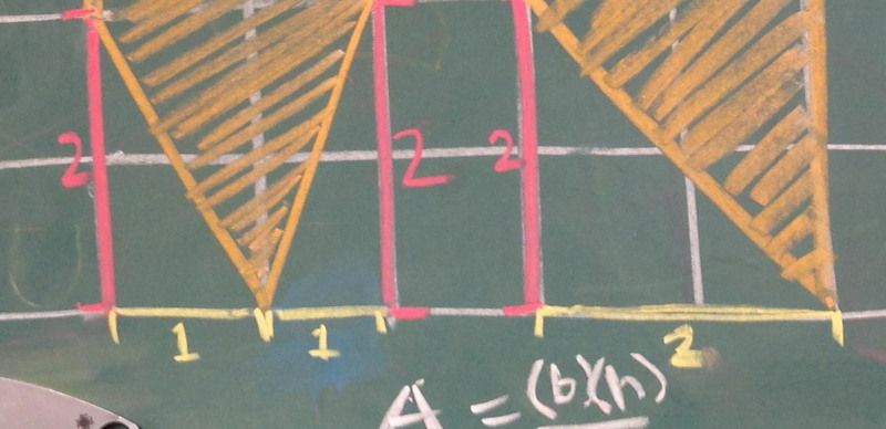

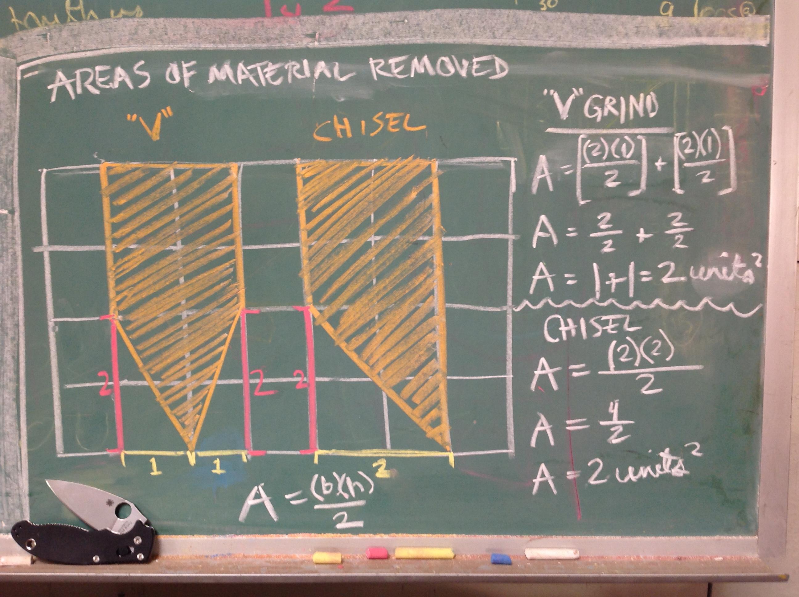

Someone please explain how more material is removed with a v grind.
That's a Scandi grind, now make it a FFG with the same example in your pic, draw a line on each side to see how thick that would be.

Hmmm...just measured my Emerson Karambit (chisel grind, with chisel edge) and my Emerson Mini Commander (V-grind, with a reworked V-edge).
Same stock thickness, same thickness the same distance behind the edge.
And, it's the same thickness at the same spot on my Emerson Super CQC-8 and CQC-12 (V-ground with chisel edge).

As for BLADE strength: obviously given two equal blade blanks, one ground on only one side, the other ground away on two sides, the one ground the least is going to have greater strength; be a "stronger" blade (and resulting tip), having had less steel removed. This has been my experience over time in using both.
If one of them has less steel removed, then yeah, sure, it'll be stronger. It'll also be thicker and not cut as well as a result. If included edge angle and stock thickness are held as constant, there will be no difference in the amount of material removed, nor in edge strength.
As to EDGE, I see no reason a chisel ground edge would be any weaker than a V-ground edge. IMO, the opposite is true if anything. And if an edge does chip or roll, it's going to be recoverable a hell of a lot faster and easier on a chisel grind. Easier for field touch-ups too. Simpler.
How so? There's no difference in strength for equal edge angle and stock thickness, and because the amount of steel that needs to be removed to restore an edge remains the same, it will not recover faster nor be inherently easier for field touch-ups. If anything, greater care is required when deburring to avoid forming any bevel on the flat face of the blade.
