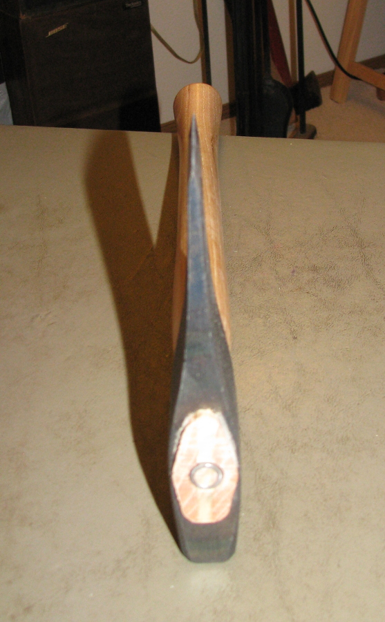

The bit is perfectly aligned to haft.
It's easier to control this alignment in cast steel than in forged steel. And cast steel can be just as good as forged steel it the heat treat is done right. I haven't file tested this yet but I will and I'll report back when I do.
The hang is extremely good with the eye filled tightly top and bottom. If it wasn't for the round wedge I'd be proud if all my hangs looked like this. I'm impressed.

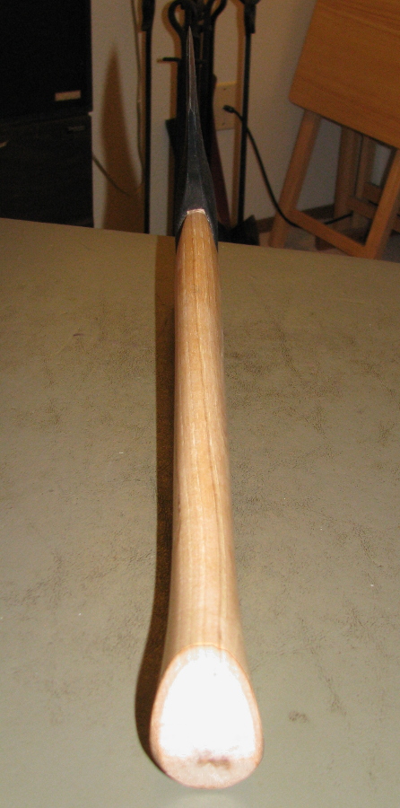

The grain alignment in the handle is good. Not exactly perfect but nearly vertical and good enough that it gives me no concern whatsoever on this size/weight of tool. The handle wood is solid and rings like a piece of flawless hardwood should.

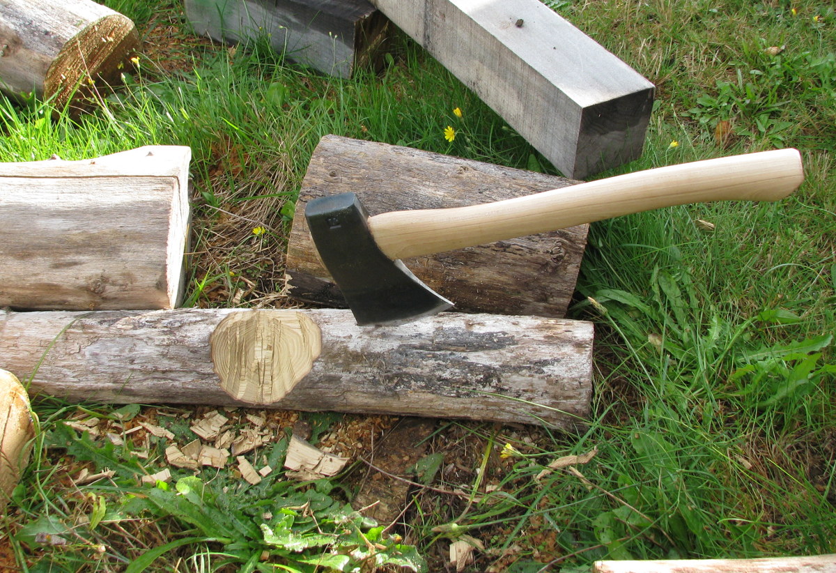

I took it out back and did some chopping on a piece of fully seasoned black locust - a good solid hardwood. The bit experienced no chip or roll. Nor did it stick in the wood as many thin-bitted hatchets would.

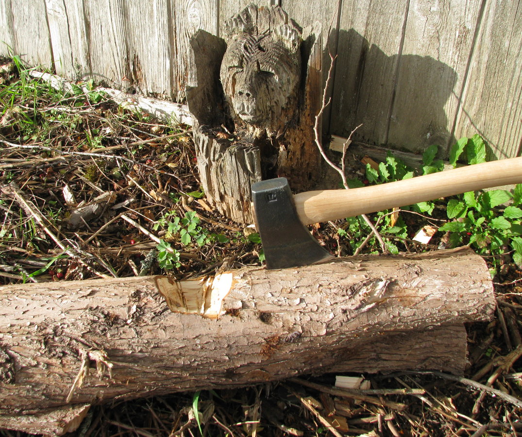

Next I tried it on a semi-dry softwood, a piece of arborvitae. It didn't stick while chopping this softwood either, which is what I was testing.
Council has made a very good compromise in the geometry of this hatchet. Marketed as a throwing axe it has to be thin-bitted to stick reliably in the target. Still they've given it enough of a high centerline that it isn't sticky as a chopper. It's a fine balance but I think they've struck it well.
If I were going to use it as a thrower I would resharpen the bit with a very slightly concave bevel to give it the maximum stick. As a camp utility chopper I will file the bevel back just a little further in the center and I will blend it in along the the entire bit. It will chop better after this.

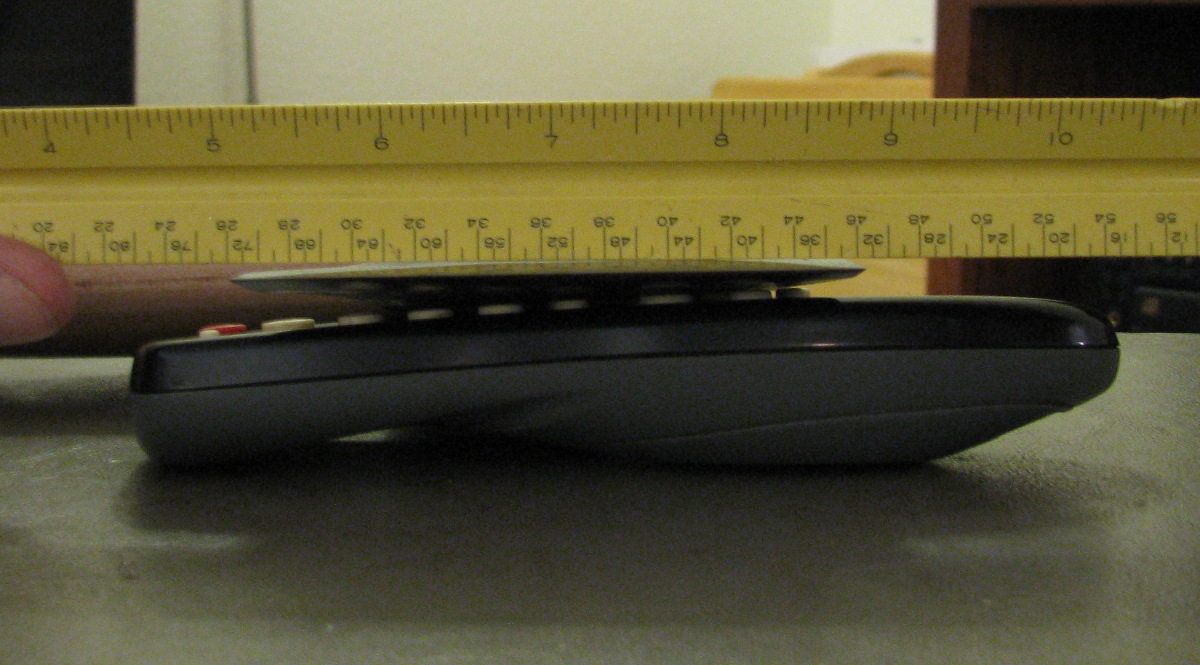

It's not a chisel grind. It's a convex, but the degree of convexity varies from piece to piece, with some being a little "flatter" and some being more blended. Even in the case of the flatter ones, it's trivial to knock off the transition shoulder. Probably 10 strokes of a file per side would do it.
I can try to photograph the convexity of the edges tomorrow, but it's very easily seen if you put a straight edge to the bevel. :)
