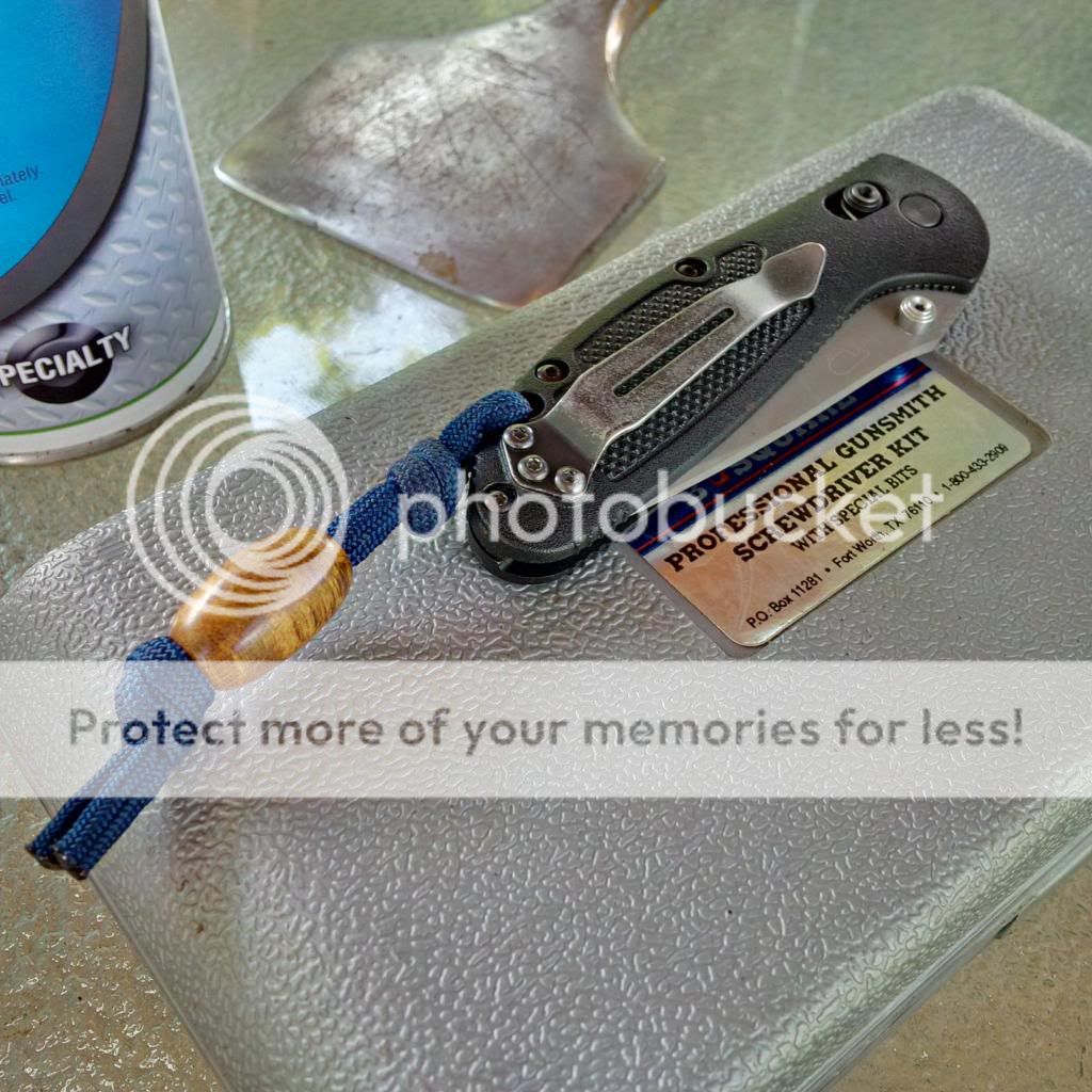

The pivot screw finally worked itself loose so I took it out, cleaned it and put a piece of teflon tape around the threads. Tightened it back down where I want it and seeing how well it holds. The teflon tape is a trick I learned carrying Emerson knives and it always worked with them. No mess of locktite and if you put it on right it never has to be replaced during future dis-assembly.

HEY, that's a great idea! I had never thought of that.
I got tired of the mess with loctite. Lately, I've been running a small bead (with a toothpick) of superglue around the head of the screw. It glues it to the g10, and I've never had one come loose after that. If you're careful, you can't even tell it is there. And if it comes time for disassembly, it breaks loose pretty easily, with the small bead. Sometimes I screw up and it gets a little messy, but hey, all my knives are users, so I don't worry about it. As long as it works.

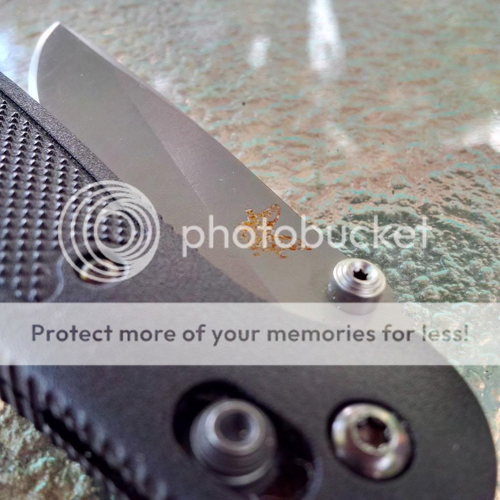

Just a couple more cell pics for the thread. Loving the steel but hating the rust. Still baffled on how this etching is reacting. The edge sure will not rust. I have tried some pretty hardcore rust preventatives at this point too.
Pocket clip wearing in

I've had the edge rust a bit on mine. However I used it hard, got it wet (not just water) and didn't clean it. So not surprising really.

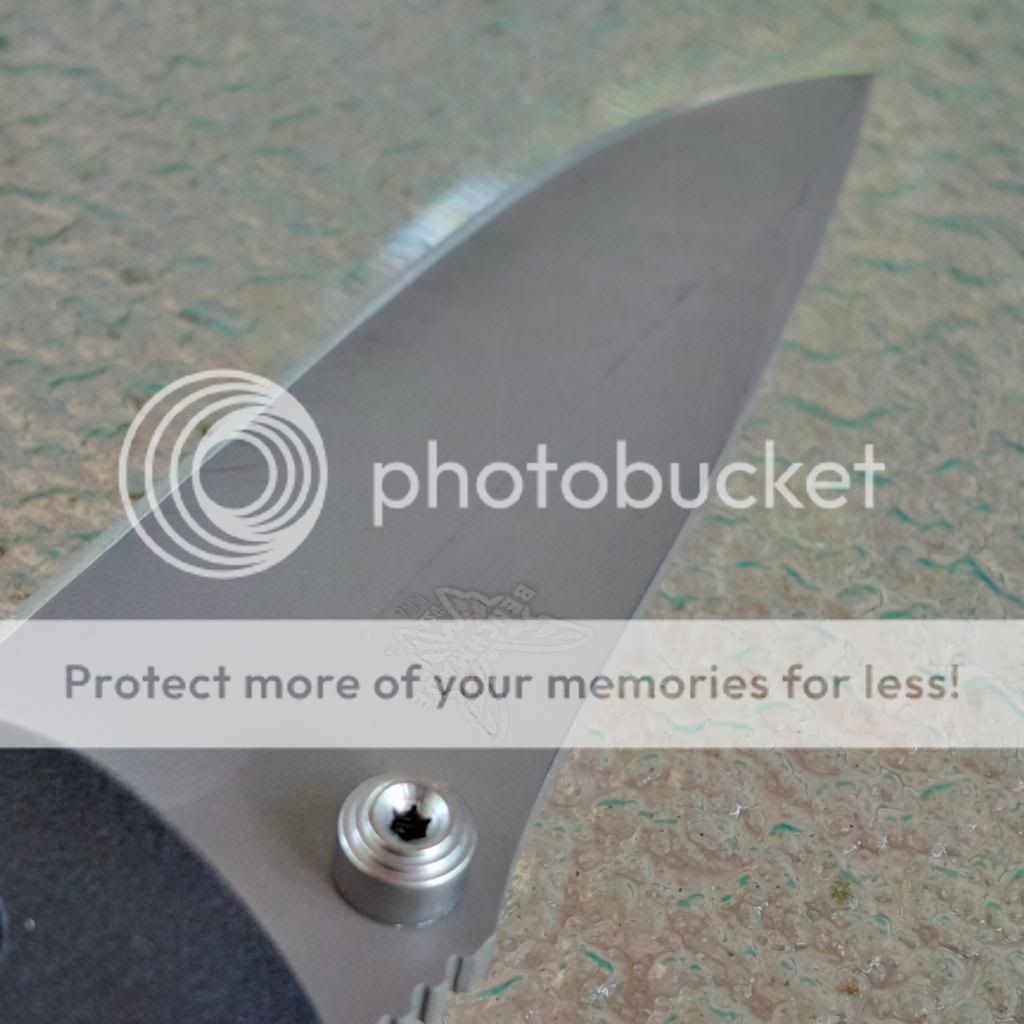

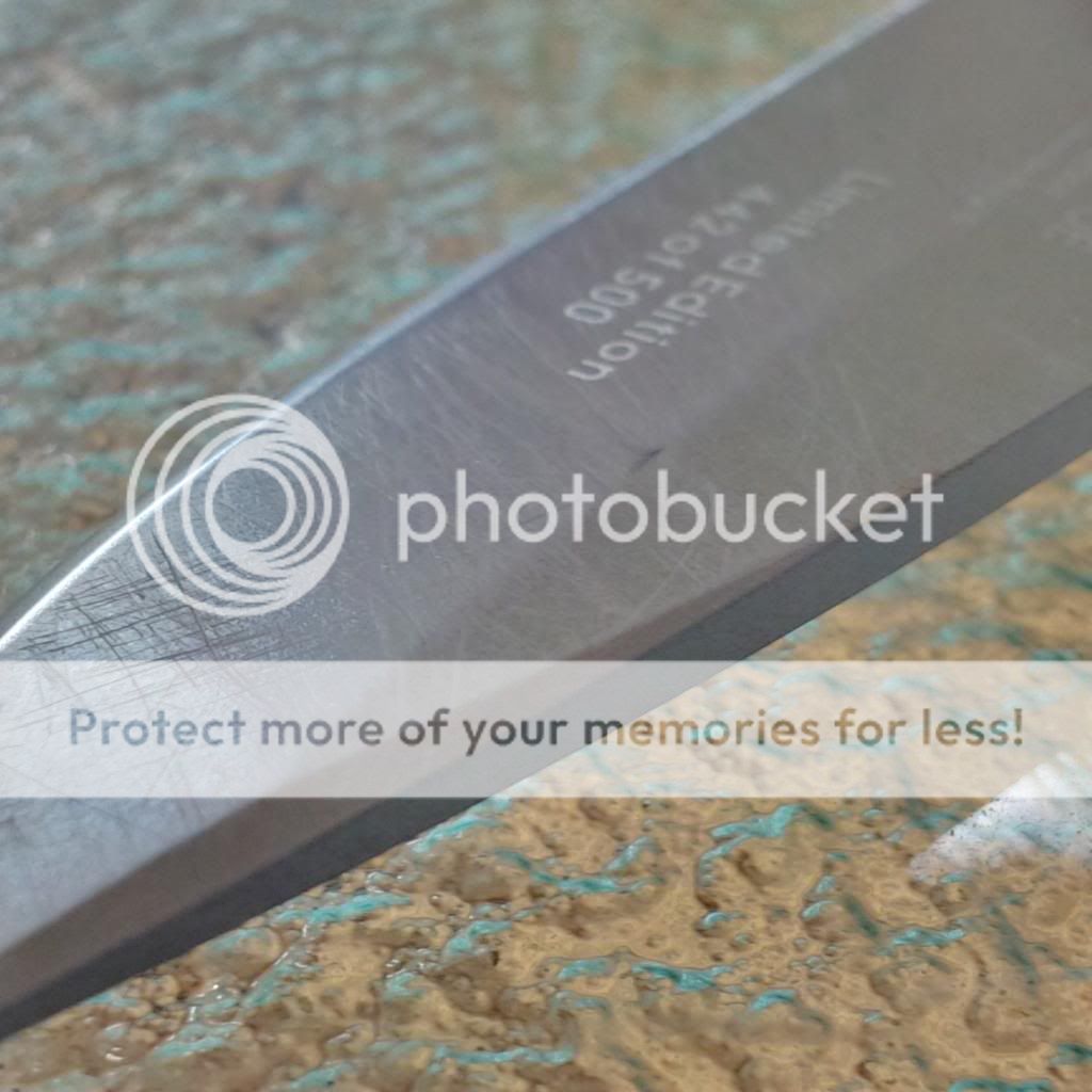

I figured I would throw in a few cell pics over time showing the progression of this knife.
At this point I am actually sharpening lower than the thumbstuds.
