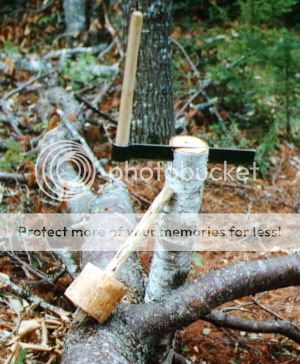

There is a tool in carpentry call a froe and maul. It is used for splitting wood usually shingles but it can be used for other things as well. It’s generally much thinner in cross section than a trailmaster. The froe is battened through the log with the mallet; some people use a steel hammer. Currently I have 2 GransFors Bruks axes out in my shop that will shave the hair off of your arm which are designed for cutting down trees. The edge profile is maybe a little thinner than my trailmaster and the edge is as hard or harder. If the trail master cannot be beat through a log with a mallet or a steel hammer then it is grossly misrepresented in its abilities. I don’t feel it’s unreasonable to subject this knife to hard use, after all this is how it is marketed.

I described knives as thin and hard because compared to an axe, they certainly are.
Ironically they are actually more obtuse and thicker at the edge than felling axes and also through the bit matching the thickness of the knife. Most high end axes are also very hard, the bit edge on Bruks and the Cold Steel blades are of similar hardness. For using metal on metal impacts you generally want other steels, or a heavy draw to spring temper, but wood on metal should not be an issue for 50100-B or similar steels.
GibsonFan said:
Nor have I ever found myself in a survival situation where all I had was a knife and a desire to split 10" logs. Why would you need material that heavy in a survival situation anyway?
Generally it isn't 10, but 2-4". Fresh wood of that size won't burn (most types) and seasons very slowly. However if it is split up into pencil sized bits then they will burn (though poorly) and they season very quickly. Splitting wood is also useful as a first step in shaping and in general construction. Often times after heavy rain then the outside of deadfall is wet but the inside is dry so splitting it allows dry tinder to be obtained even in harsh conditions.

Cliff Stamp said:
Generally it isn't 10, but 2-4".-Cliff

GibsonFan said:
Right you are, Cliff; I was referring specifically to pics ppl have posted on this forum ,where they were trying to split 10" logs, and I think that's just plain silly.
That's a difficult task with a Recon Tanto or similar. You would have to take it down piece by piece taking slabs off the sides and using them to carve wooden wedges. I don't see much reason for that outside of recreation or amusement, then again most local wood is fairly small. Maybe 10" is small wood for those guys, I would not mind living there if that was the case. I'd want a maul and at least two decent metal wedges for that size of wood.
-Cliff

Cliff Stamp said:
I'd want a maul and at least two decent metal wedges for that size of wood.-Cliff
