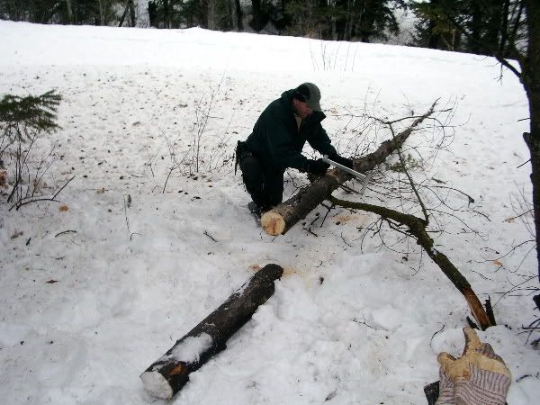

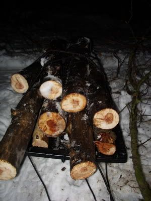

ABOVE and BELOW: Winter camping is hard work and making a fire in wet/snowy conditions takes about two hours of effort: searching for wood (found 1/4 mile away), sawing it, transporting it via sled to camp, splitting it, making kindling, and tendering to a self-sustaining stage. Add to the hard work soaking/freezing conditions, darkness, and 20 mph wind. Come prepared! No huge trees around but we were able to find many 6"-9" dead fir trees we felled and "processed."

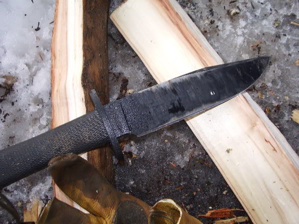

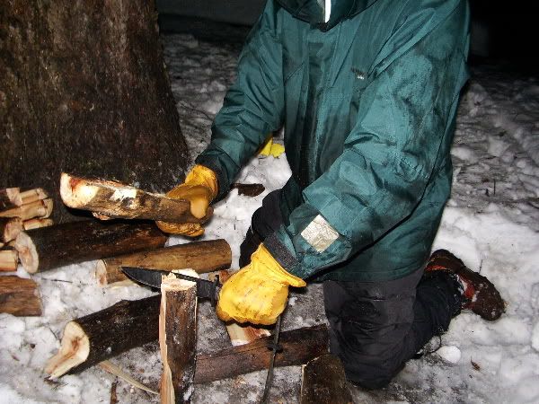

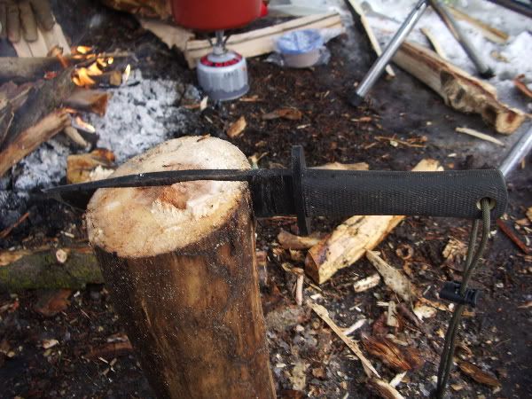

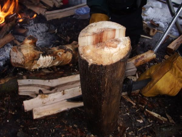

ABOVE and BELOW: What any good survival knife should be counted upon to do: batoning through logs. This was night one. Quickly remembered why I got the Cold Steel Recon Scout in the first place: I love its WEDGE-shaped blade as it nearly blasts through the logs. I'm not sure if any other blades have this triangular grind thats uninterrupted from spine to edge. Acts as a wood wedge. Most logs required one hard hit to split. A couple with knots took several good whacks but ALL succumbed.

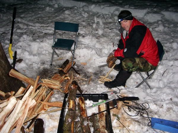

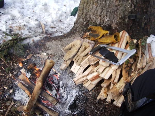

ABOVE: Buddy helps kindling piles (also a grad of USAF survival school BTW). Note split logs forming base of fire build; used to prevent fire from dousing itself on icy and snowy ground (even though it was cleared as best as possible). All wood shown split by RS. Although capable for all tasks, the Kabar Next Gen just did the small splits for kindling.

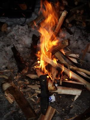

ABOVE: Hard work? Yes. Worth it? Totally. CS Recon Scout briefly stands by its handiwork as fire reaches self-sustaining stage.

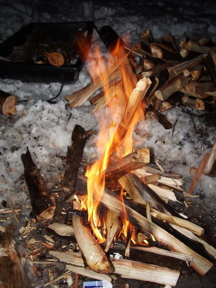

ABOVE: Fire takes off. Note aformentioned sharp, dry edges of the split wood which enables ignition. Forget the nonsense about collecting twigs and "squaw wood" to make a fire in wintertime... all small ground wood is buried in snow and even if found is completely soaked and frozen... worthless. You have to make your own fuel. Splitting wood enables a fire like this and is really the only way in a backpacking scenario.

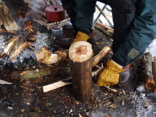

ABOVE and BELOW: Daytime fire duties: endless splitting. If you think you can throw wet logs on the fire and be ok you're wrong. They will burn poorly and mostly smolder due to exterior moisture and lack of sharp, burnable edges. Splitting again is the answer, revealing pristine dry wood inside and bypassing the 1/8" soaked exterior. Also no special technique is required: hold blade firmly and whack the knife spine HARD several times pushing on handle. It doesn't make any difference if you twist or tweak... do whatever you need to split that wood and any good knife will take it. Sorry but to say otherwise is complete ignorance from those who don't know what they're talking about (Peoria 46, Ebbtide, 4 Ranges, Daqotah Forge).
ABOVE: CS Recon Scout did just fine. Maybe first breakage WAS a lemon, may it was the cold. Hard to say. I'm not one the technicalities just the performance, thank you.
ABOVE: Firetools: a good survival knife blows away an axe as I've said. Here's your proof of a knife's effectiveness when used properly...

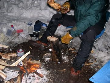

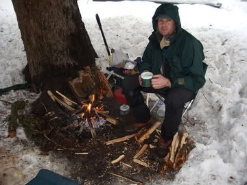

ABOVE:... and here's the reward. A nice cup of hot chocolate and a warm fire. Ahhhhh!

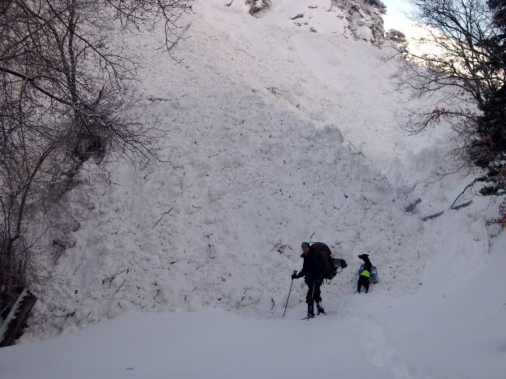

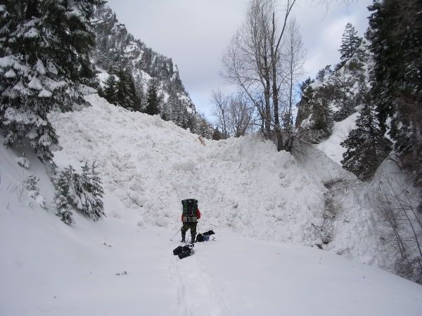

ABOVE and BELOW: Avalanche aftermaths occuring shortly before our descent in the early am... we heard them come down. We stayed away whenever terrain allowed. Above road is covered with medium slide and that's roads obliterated by a massive slide. At that point, that huge slide loomed over our only way out necissating a improvised rope crossing with the sled; took 1/2 hour for this crossing alone. You see some of its heigth but not its length: slide was over two football fields in length and ripped out 12" thick trees. Last pictures shows the slides origination chute. Having dumped it's load these areas were actually safer than other nearby laden slopes. Safely traversed them all and got the heck of there ASAP. We planned for the worst and pretty much got it.
