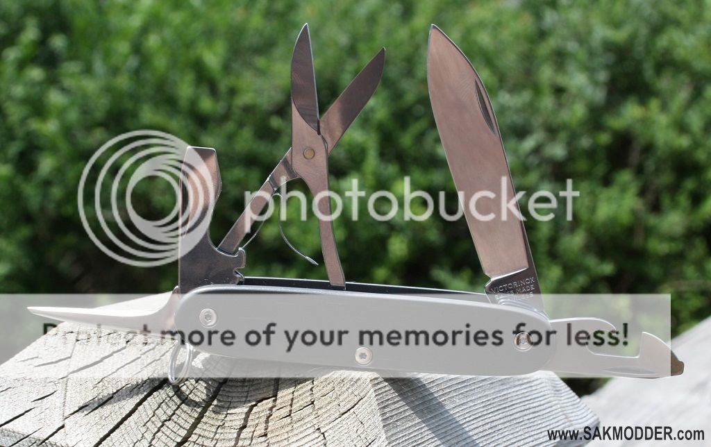

I like the silver Alox you have with the saw and scissors. I have the model with the saw, I can't remember the names of all their models, but would like to get the scissors installed on mine, or do you sell the completed modded knives? Thanks again, Jeff.
Hi I can build complete customs from my parts stock, or work on existing ones if you provide.
I do work on the 58mm size as well. Ive made Ti and brass scales from those before.

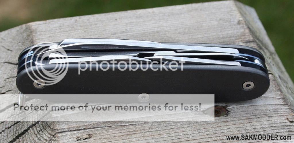

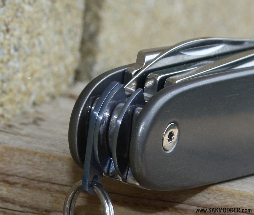

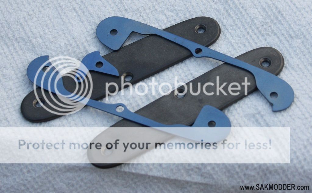

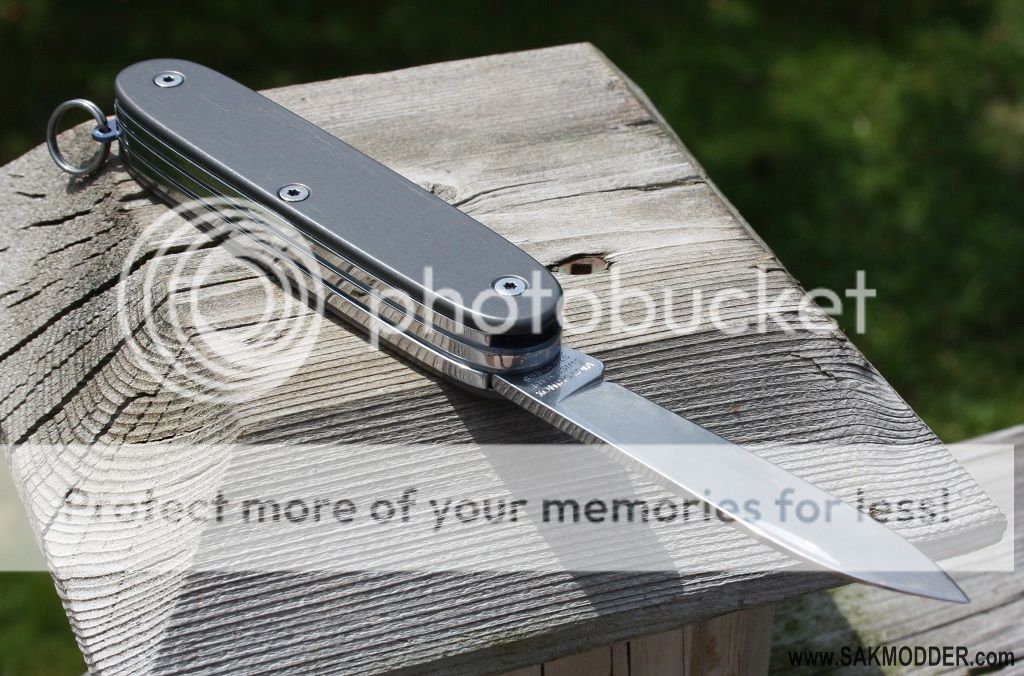

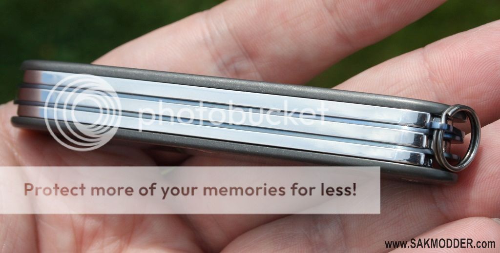

I just wanted to post some of my latest work as an update.
Here is probably the fanciest custom build I've done so far. Definitely the most hours involved in putting it together.
The scales, liners and keyring spacer are all Ti-6-4. Scales were tumbled in coarse ceramic pyramids for 8-10 hrs to get them the matte gray look. The keyring spacer and liners I anodized blue. All wear point on liners and scales have been carbidized for smooth operation.
