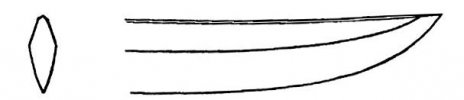

“The tip is Shobu Zukuri : Which loosely translates to Iris leaf shape. What is most notable is the absense of a yokote (border line between the tip and the cutting edge)”
A Shobu-zukuri differs from Shinogi-zukuri by the absence of the Yokote. However, this means that there needs to be a Shinogi separating the Ji from the shinogi-ji which runs full length. There is no shinogi on this wakizashi. The Bo-hi or fuller would remove a blade from the shobu designation in my mind, as I have never seen an Iris leaf with a groove. At best it would be Shobu-zukuri like.
Shobu-zukuri nomenclature:

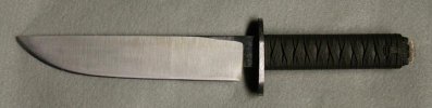

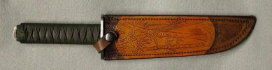

If you can refer to the last knife you pictured as Tantoish I have no problem Refering to what I have posted as a battle Tanto I just would of had better taste than to pop in on one of your threads and call you on it :)
This is why I use JSB, when talking about nontraditional Japanese blade.
Japanese Styled Blades.

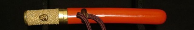

I just did get this a few days ago from another of my favorite Bladesmiths, Stuart Branson. :cool:
Stuart's photo......don't know what kind of -ish this is. ;)
I'd LOVE to have a 'real' Japanese blade but, over the years, I've collected many 'hybrid' pieces and enjoy them all very much....even if they aren't legit. ;)
