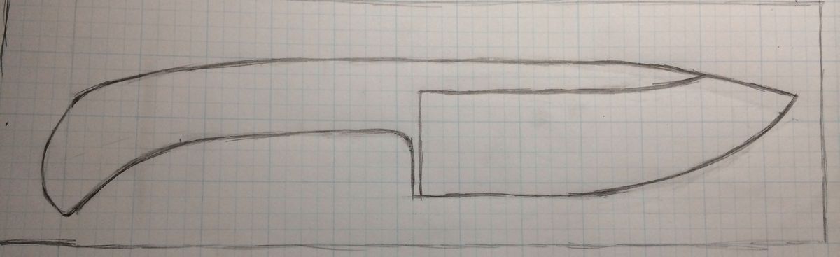

Ok weird question on the handle shape. Was cleaning off my truck after this last snow storm and choked up the handle more than normal but as I was cleaning it off I couldn't help but realize the grip felt incredibly comfortable. So on a screw around moment I made a rough mockup out if wood and really liked it. My question is should I just go with it?

To the OP, my suggestion is go with what feels good in several different grips. If it feels good to you, the end user, then you have keyed in on the whole goal of making a custom knife. If the mock-up works well in various grips, then go with it.

Yeah I haven't put down the mockup for an hour. Been watching tv and flipping it around and smacking whatever I gave on my bench. Fits like a glove no matter how I hold it. Might tweak how I have the butt set up but that's about it. I'll post a picture once I get one drawn up. Kinda just grabbed some wood and said to heck with it lol. Thanks again Eric

That is a good and very functional overall shape. I can see why you are going to tweak the butt a tad, but otherwise that shape is usually pretty useful. With a nice flat grind they are good slicers and handy in the camp, with enough belly to do some skinning out. That shape also tends to carry enough weight forward to be a fairly good little chopper.

Thanks again Eric. I may tweak the tip as well since I'll be probably cleaning more trout than hunted game. Still trying to figure out the handle as far as keeping the but flared enough to let it slide from right behind the blade to all the way at the back for chopping. That and it makes playing around with it a little easier :smile: . As fur the flat grind what kind of angle should I bring it down to?

As for the angle question... it depends on the starting thickness of your steel. Ideally you should just shoot for a thickness post HT of .010-.015 for the primary edge. Then a nice long flat grind behind it. Thin wins. If you start to wonder if its too thin, then you are probably in the ballpark, lol.
Where you drew your bevel, height wise, is about perfect for that knife. Start with 1/8"-5/32" stock. Anything else would be overkill. Pre HT the edge will depend on steel type and whether or not you are HTing your knife yourself or sending it out.
If you will be chopping much with it, leave a little length on the handle with a good butt on it so you can hang on. A lanyard never hurts either...

For that I would think you could go nearly to finished but call Peters to make sure. I can' advise specifically as I HT here. They can tell you exactly how far you can go.
Just for reference, there is another thread on here right now where someone completed a knife similar in design to yours. May check that out. I think you are going a bit bigger though. But similar functional design. I think its gonna be a good one!

I read in another thread that one of your knifes was basically used for a step Eric. Never in my wildest thoughts did I think a blade could withstand that kind of pressure from the side. I know it's not it's intended purpose but still kewl but of information on a blades actual strength. And as the handle is now I can get about a hand and a half/ two hand grip on it. Us that long enough? And welcome to the thread bladsmth. Thanks for pulling my head out of my back side on my original thoughts :smile:
