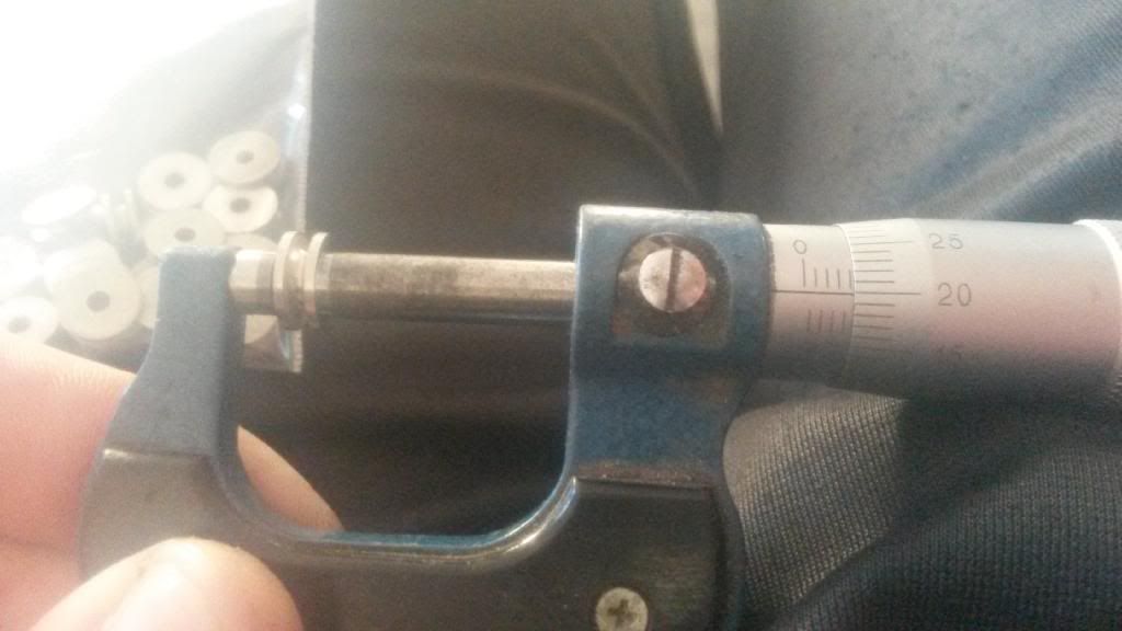

These are an important key for fitting, correct?
They're vital hey Wolf. The spacer has to be exactly the same thickness as the blade thickness plus the two washers. It's only 0.5mm to be taken off each side but I'm honestly not sure if they can do it - not having used a lathe myself. To my mind they should though. Worst case scenario is that these end up in a drawer until I find a project for them one day, I bought 3 feet of Ti from my US supplier so I still have a bar in stock.
Just a thought, Gareth — if you, or your engineers, could mill a .5mm pocket into the inside of your scales or liners, that might do the trick and save you from having titanium rolling around your sock drawer for too long.
