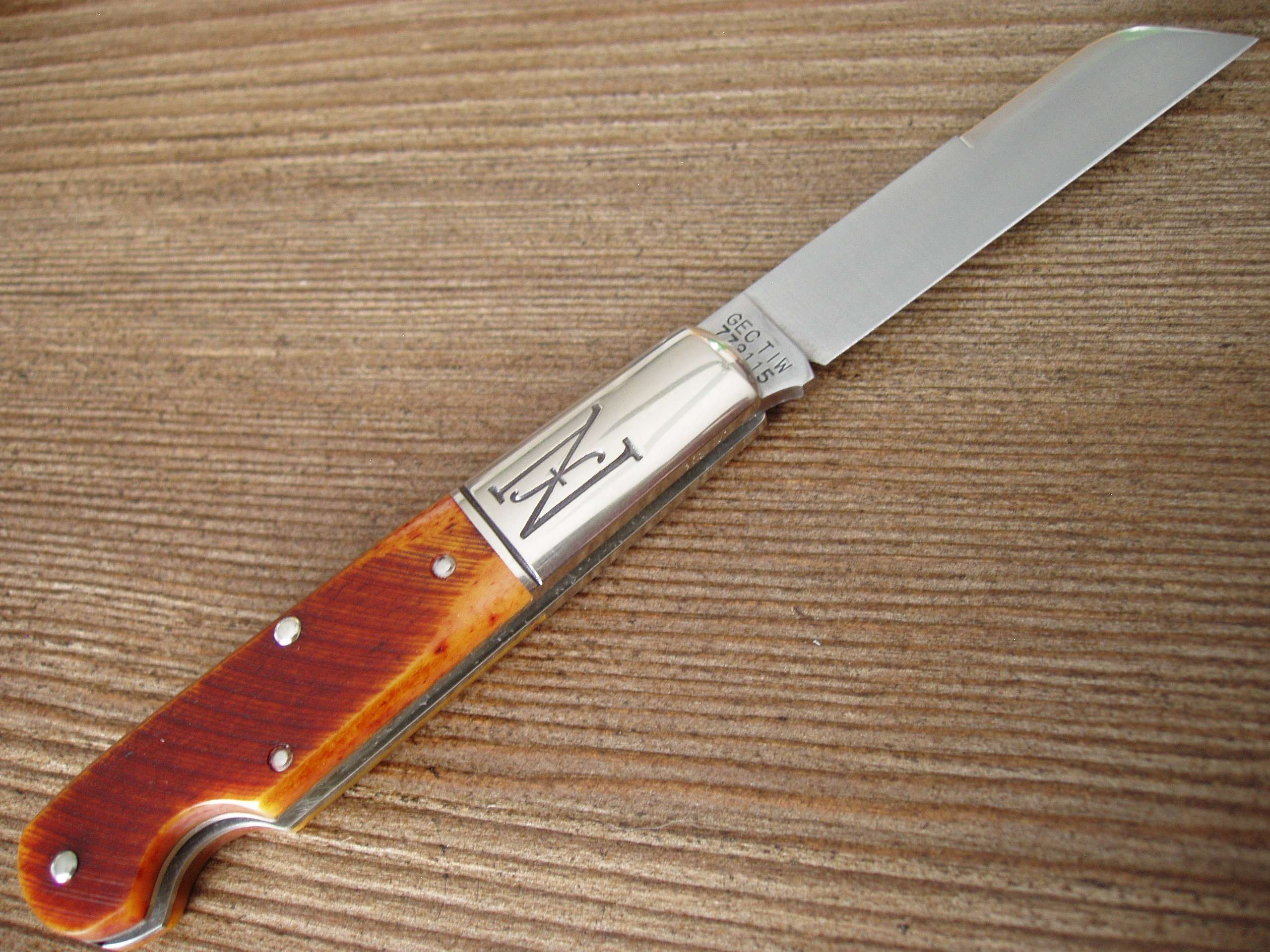

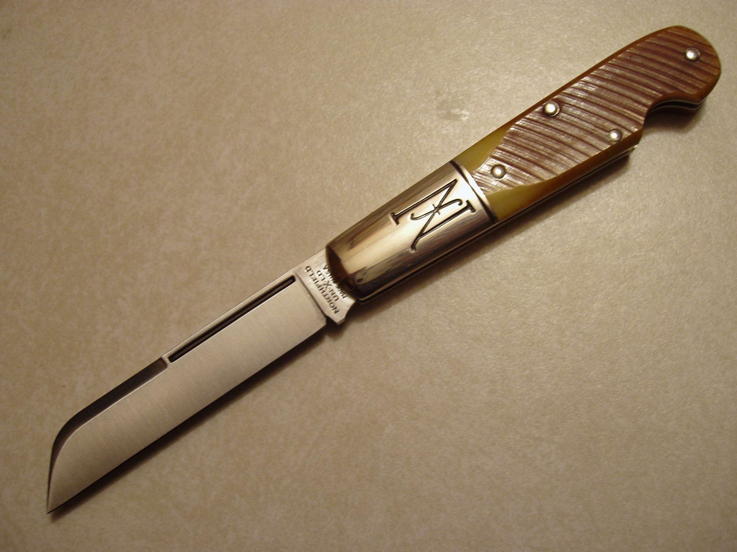

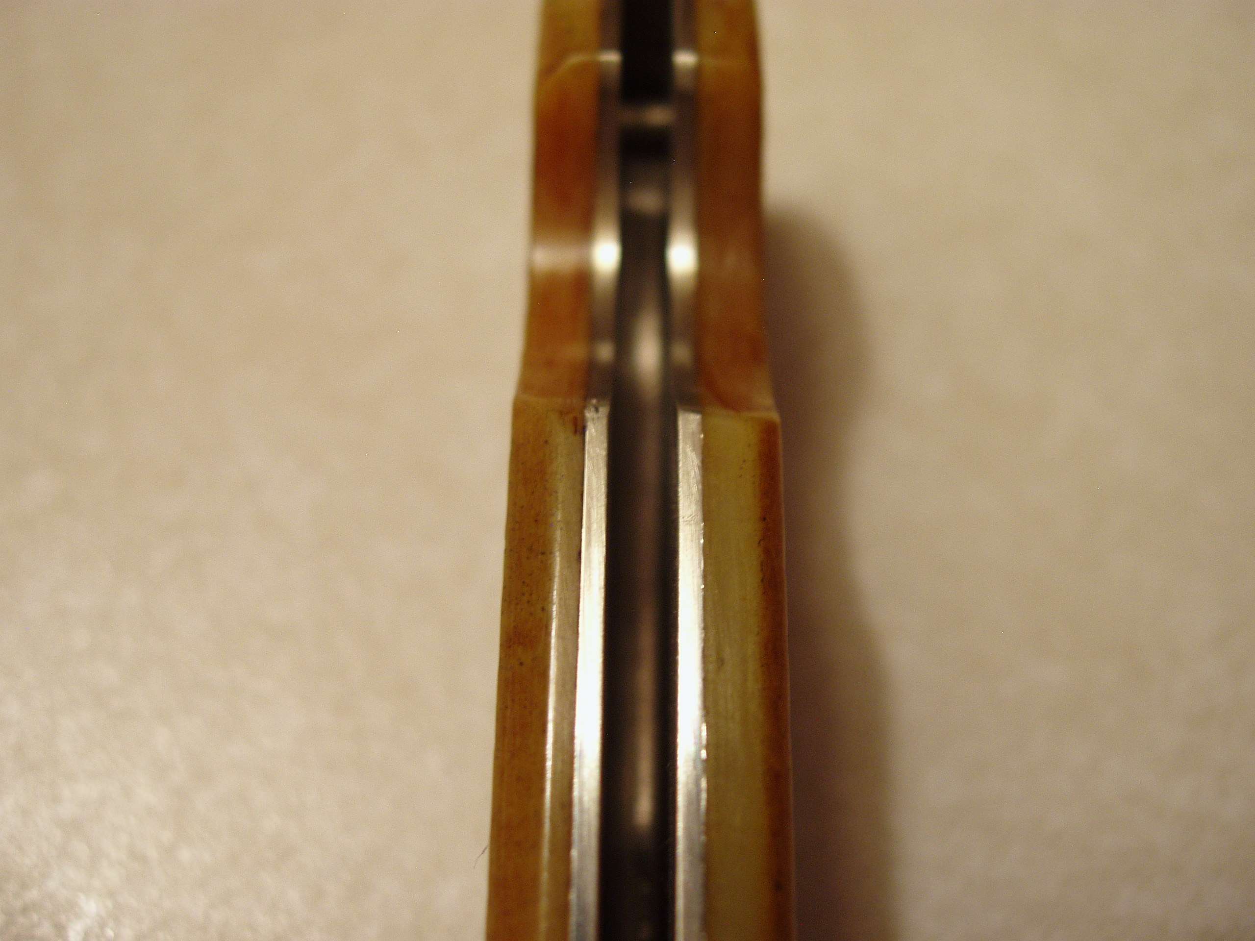

Well Lemmy threw "Caution" to the wind so I figured, why not. I followed suit. :D
I had already filed the kick down. I really like this mod. Much more pinchable and as Lemmy stated previously, the ring finger just drops right in to give a better grip.
Not the best pics. I'll try to get some better ones tomorrow in the light of day. Thanks for the inspiration Lemmy. :thumbup:

Excellent work fellas! It's really tempting to try that on mine. How'd the bone hold up? Any unexpected issues?
No issues. It started to get a little hot so I went slow and gave it a little douse of cutting oil. I then hit the burrs inside the liners with a thin Arkansas Stone.

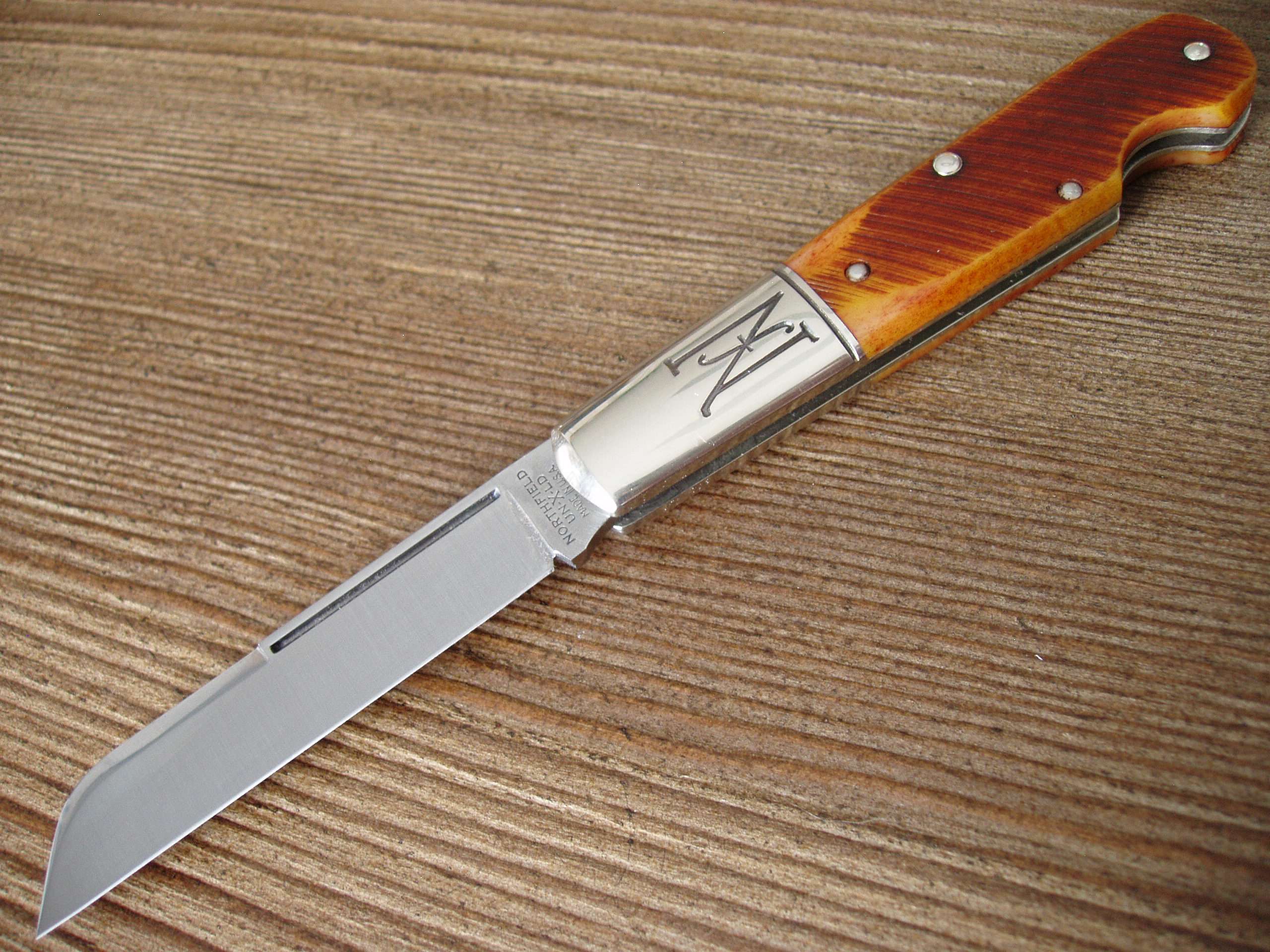

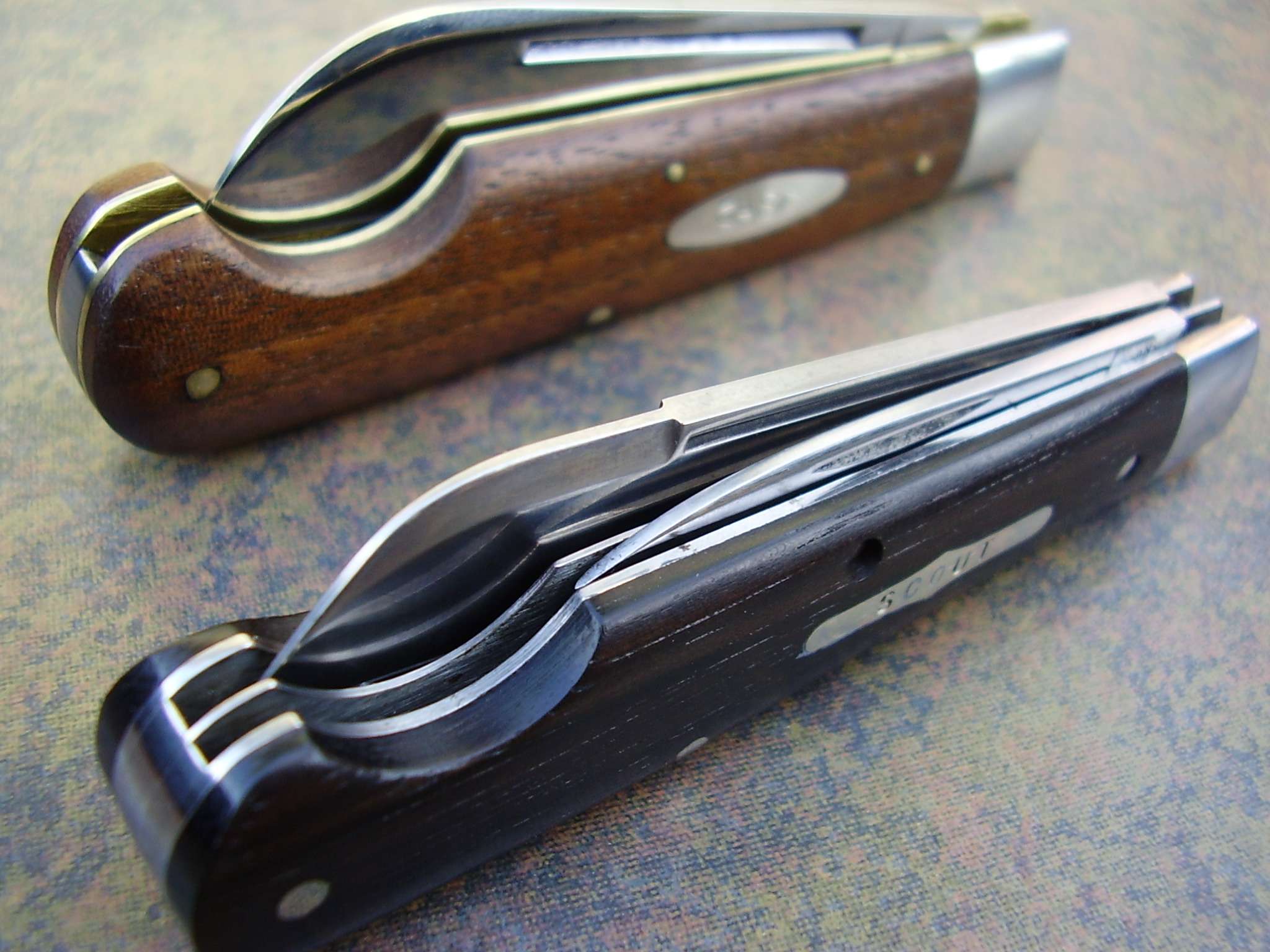

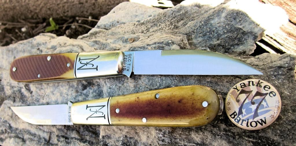

My last two to show.
The Autumn Antique Bone came out better than I ever could have anticipated.

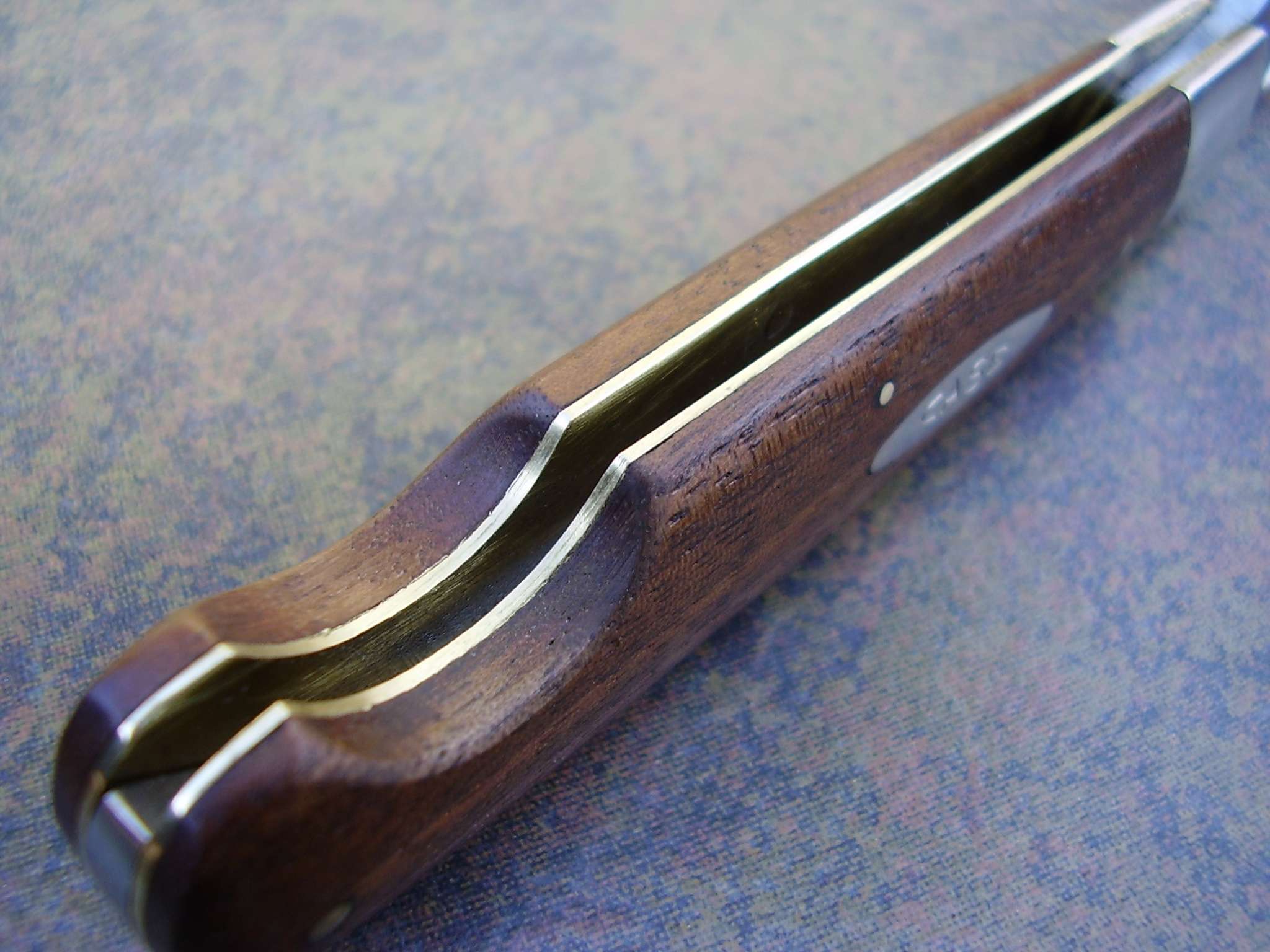

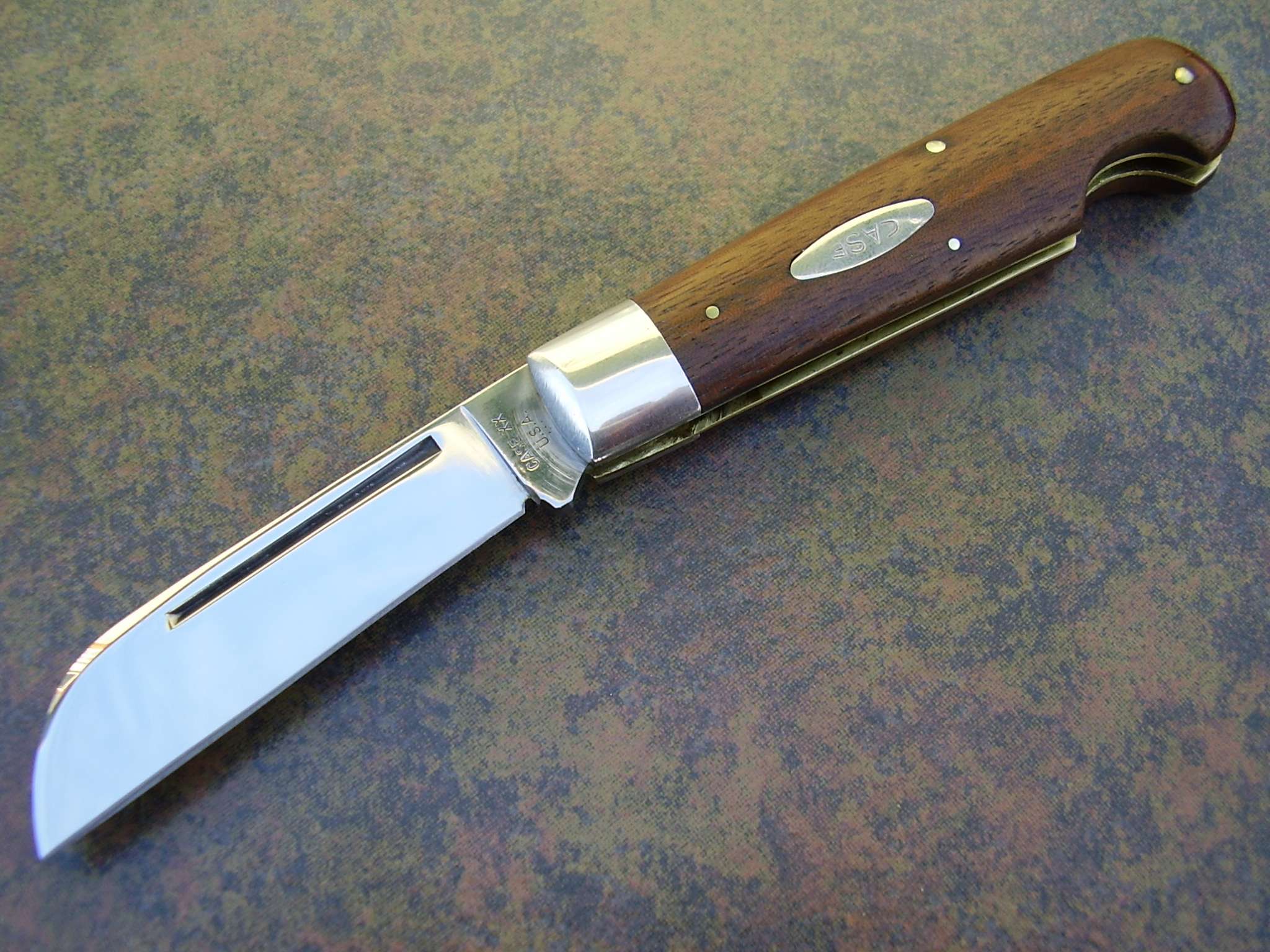

-love the Blackwood mod-

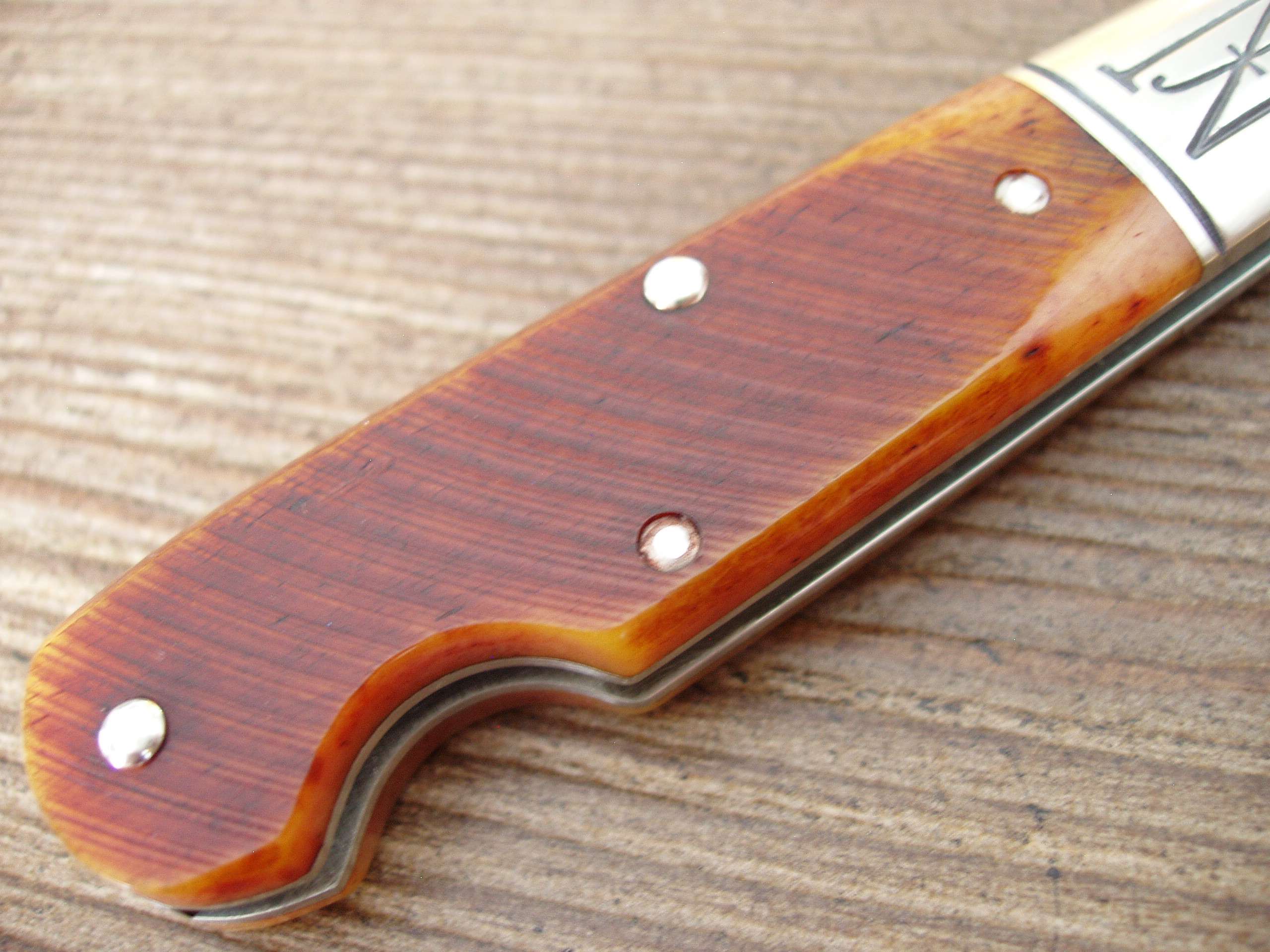

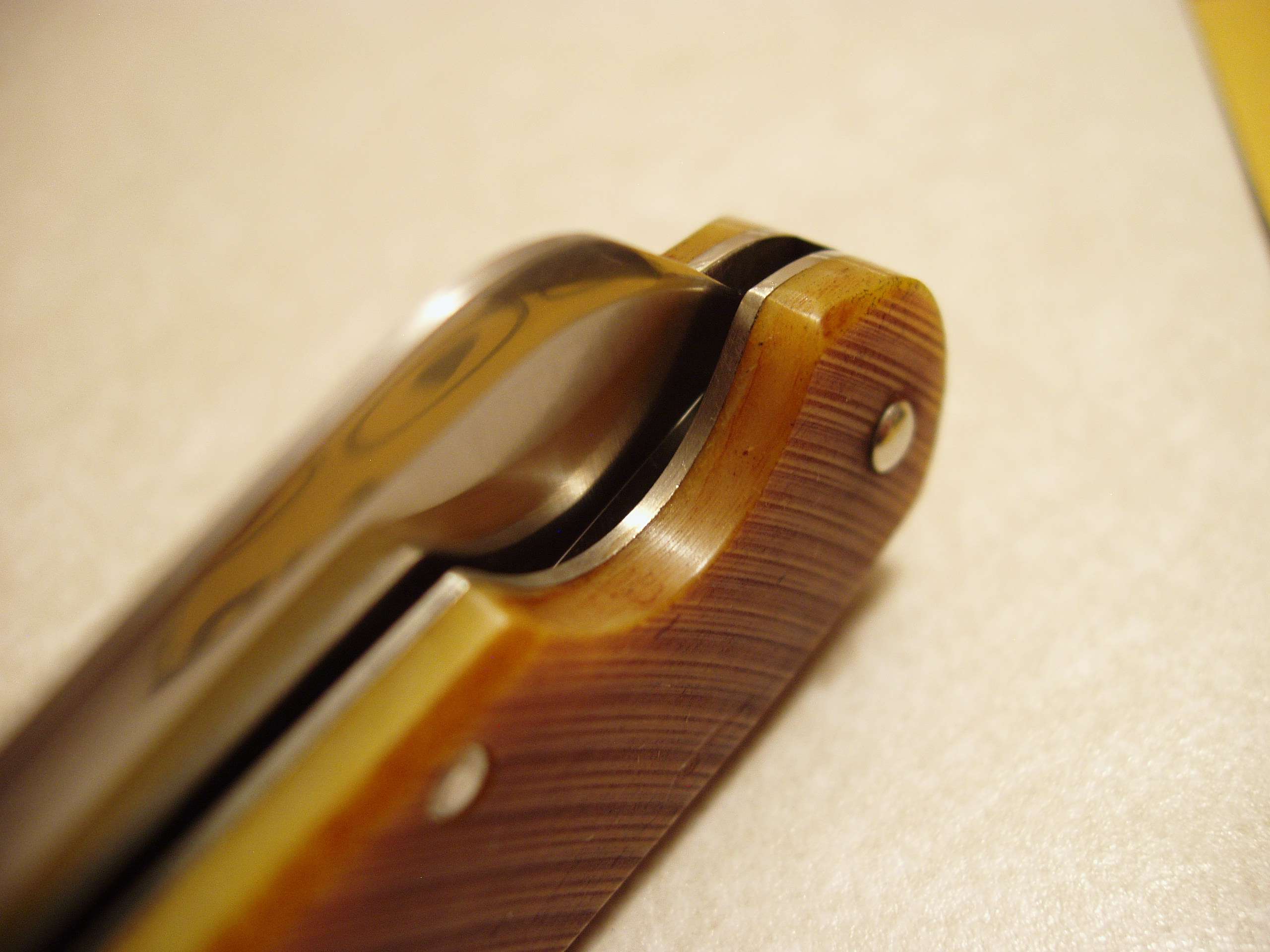

OK, Lemmy started an EO frenzy!!! I've done this before on a few knives and love the effect. I was blown away with Lemmy's earlier transformation:thumbup:
Then I saw Bob's Old Tan Bone. I was on the fence to sell my Old Tan Bone so it immediately became the candidate to do it to:cool:

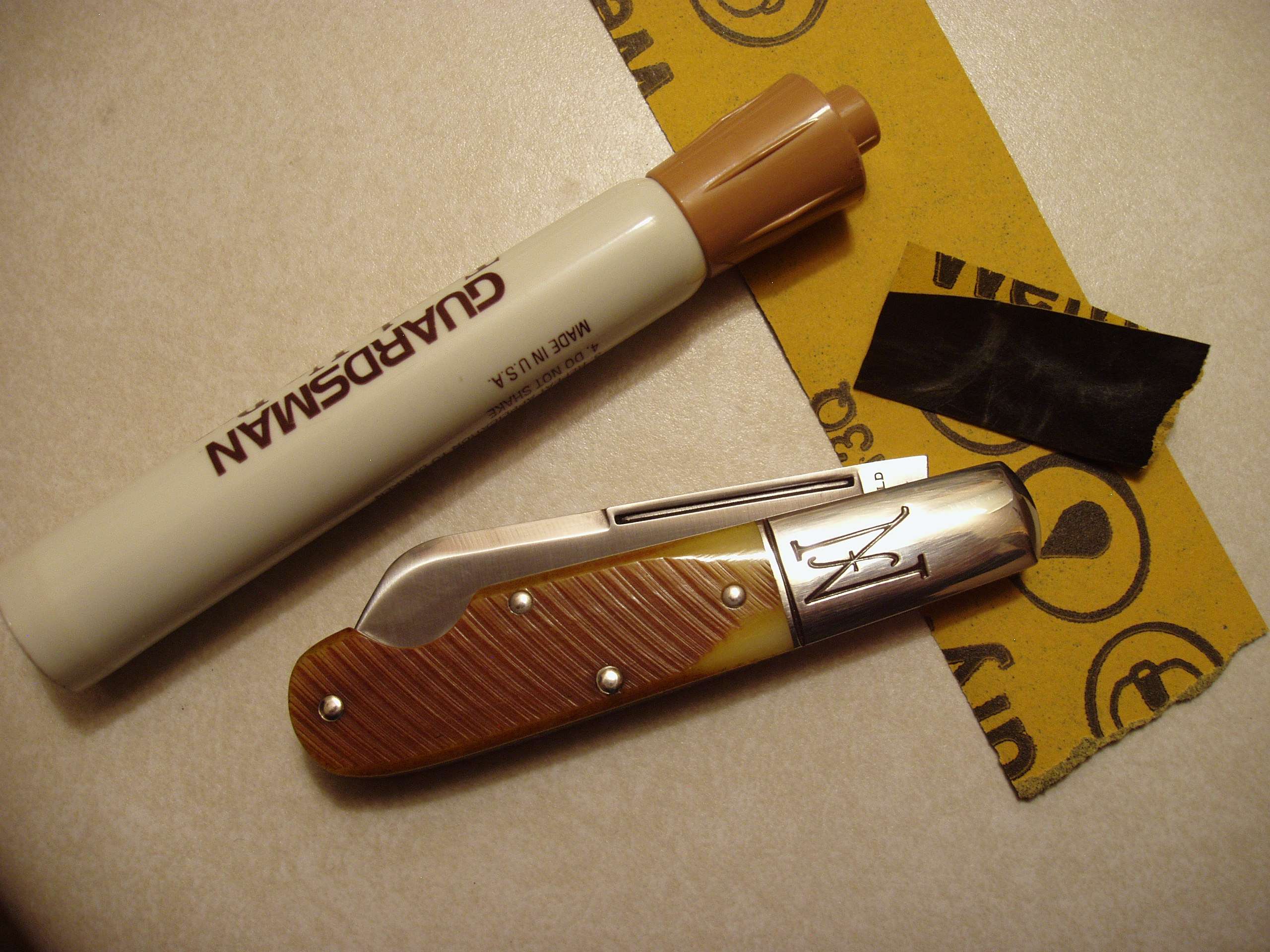

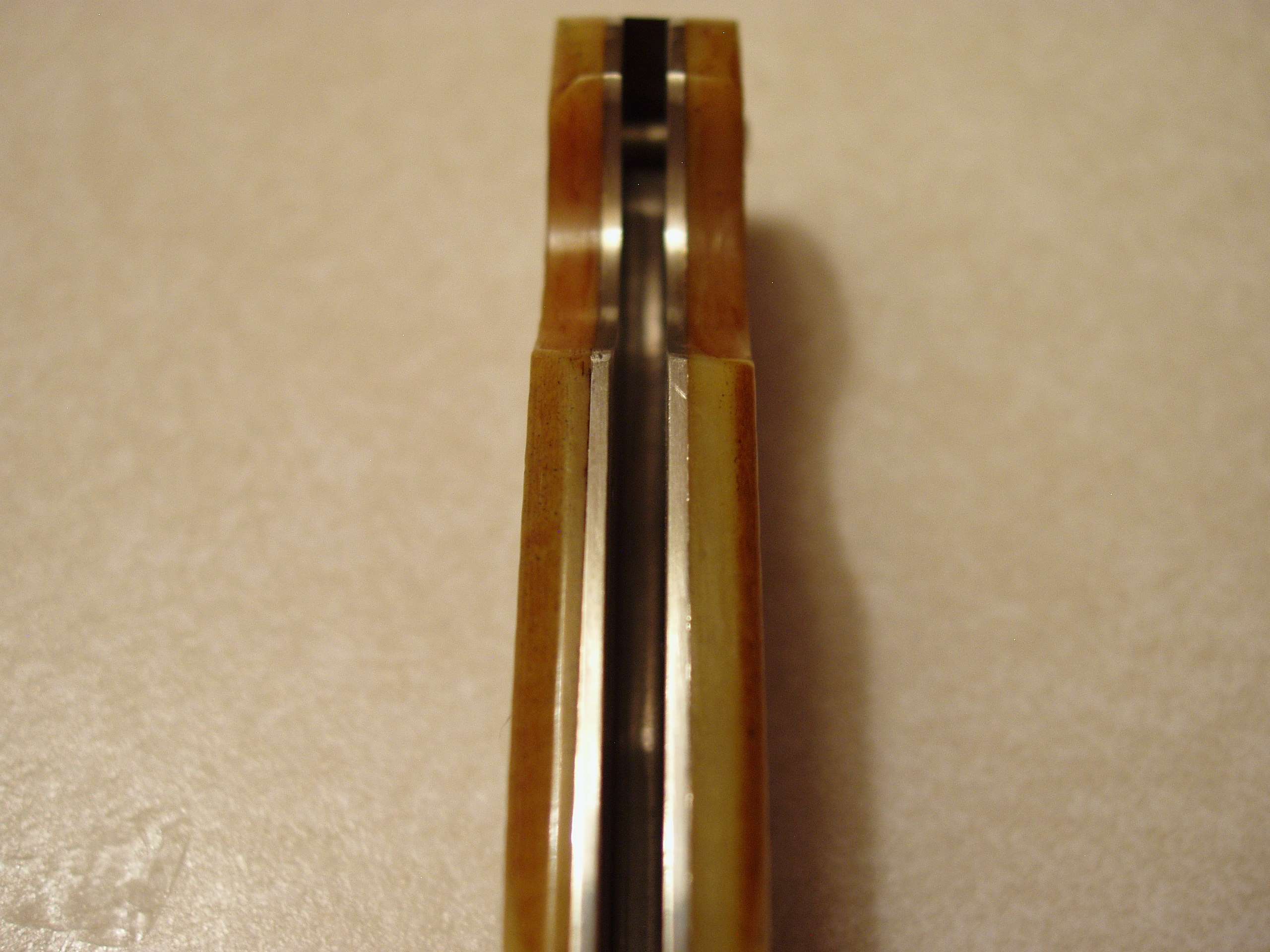

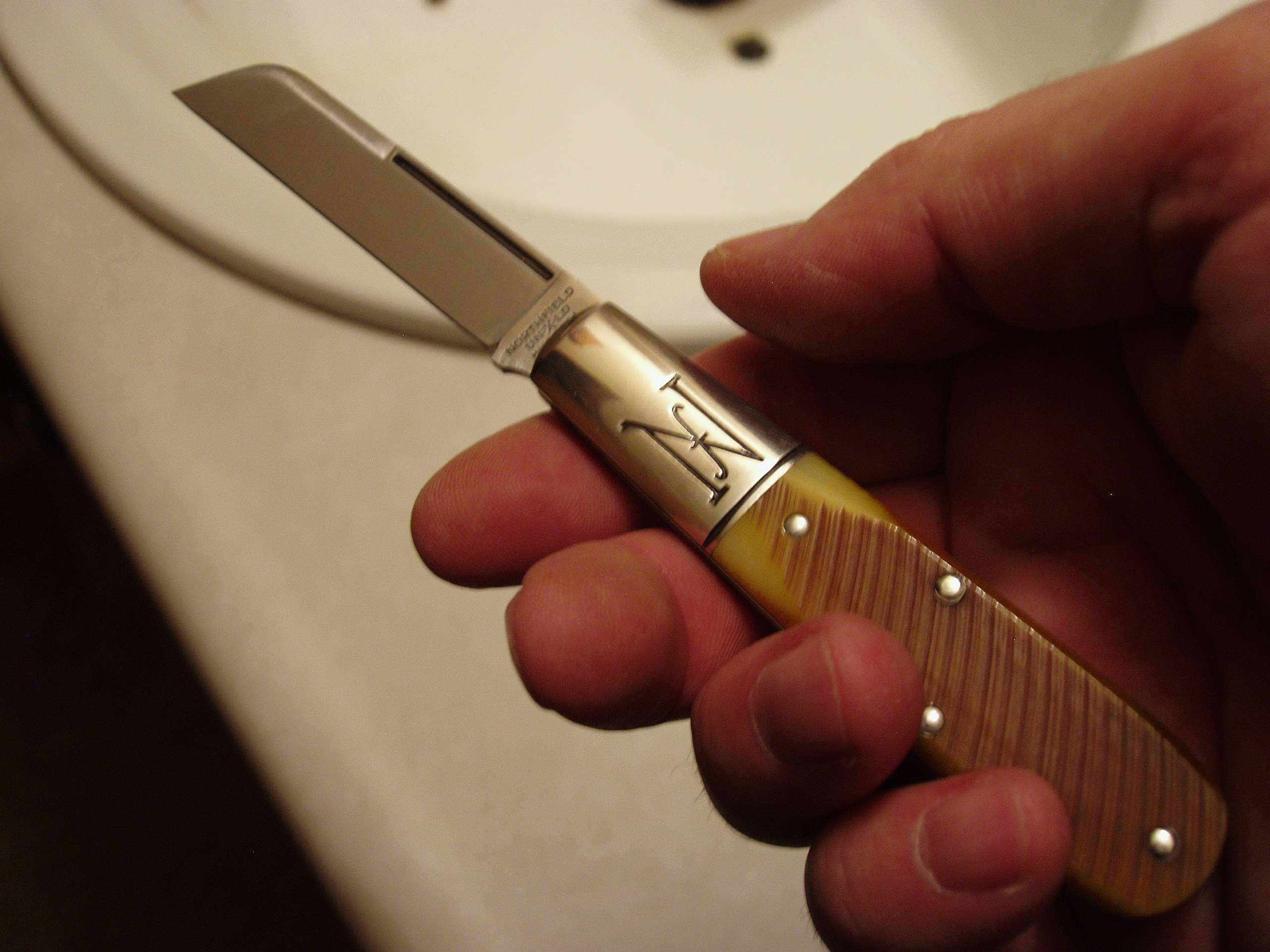

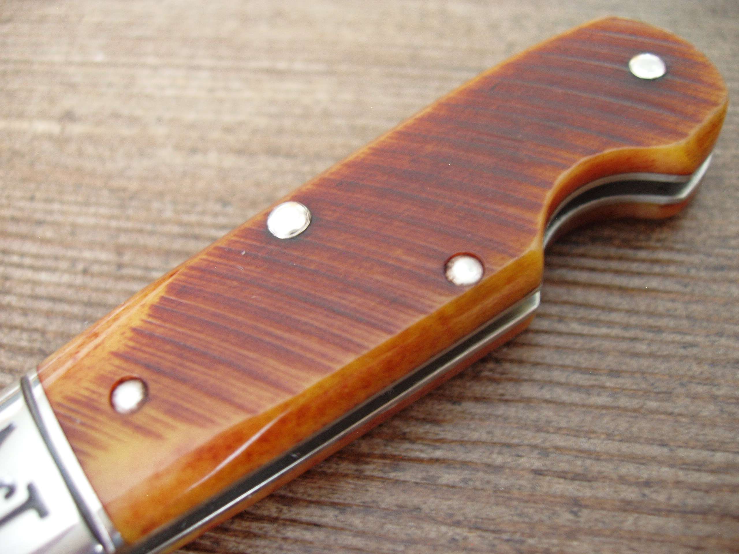

I used the 60grit Dremel Drum and ended with the 120 grit drum, then went from 600 progressively up to 1500 grit to finish it off:thumbup: I radiused the outside edges and may do additional work tomorrow but for knowI really like it:thumbup:
We used to own a Furniture store years ago and I've save the wood touch up markers for my Handyman business---so when all was done I hit the white part of the bone with a warm wood tone the blended it rather well:)
Excuse the POOR pictures but conveys the almost final poduct;):cool:
Shot of the EO once hit with the warm wood stain marker:thumbup:

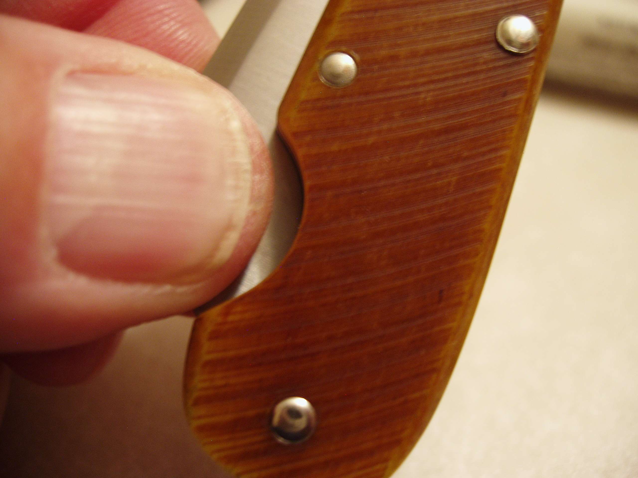

In hand pictures---the pinkie finger fits naturally;)

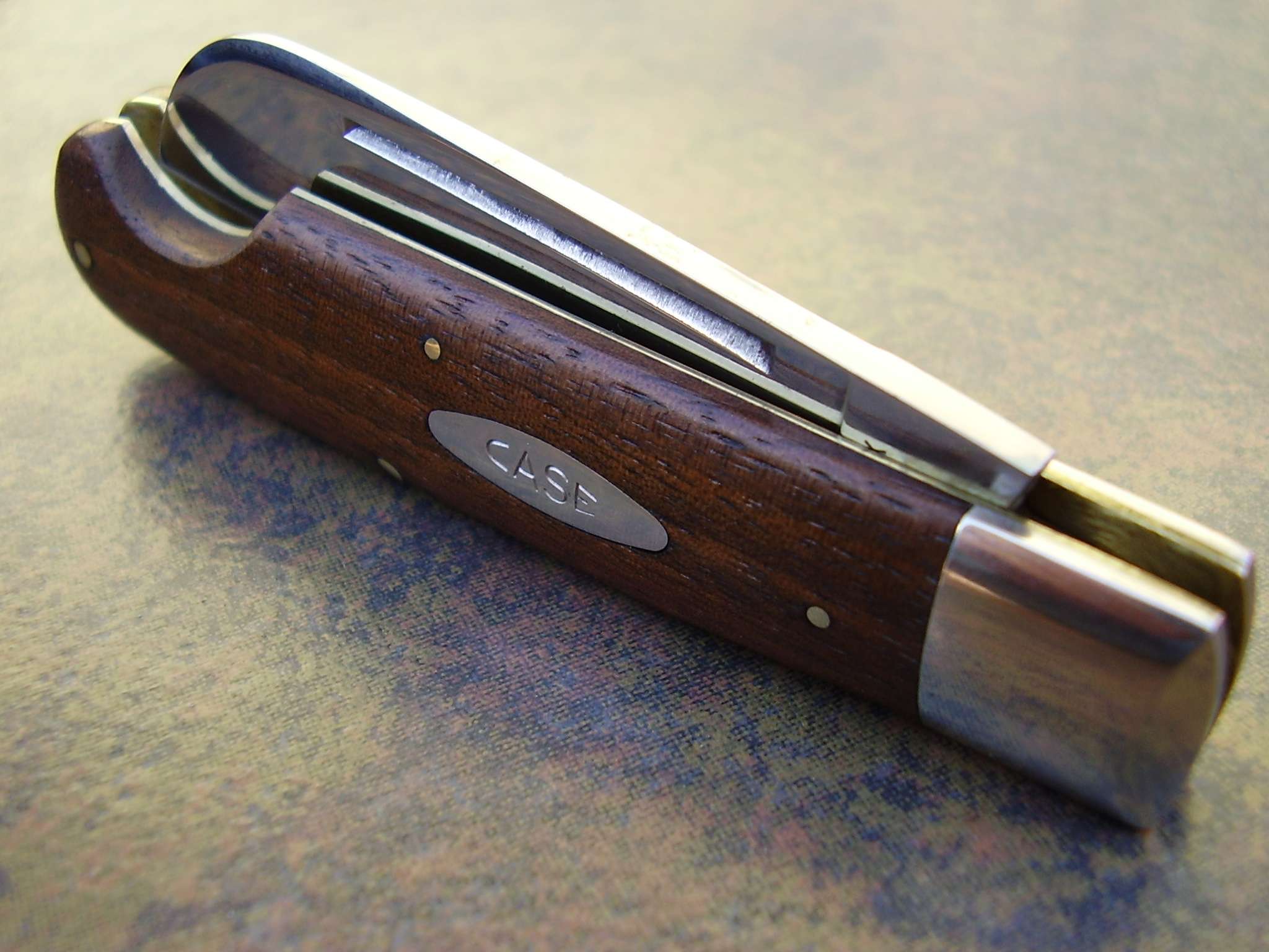

The Case Sheepfoot I converted a few weeks back---just sold it last week:o

Very professional looking work on these EO's guys. How did you figure out the depth and radius of the EO ? Then once figured out, did you mark it on the handle with a pencil or marker of some type ?

I have a vertical drum sander so I chose a spindle diameter that looked to be about the same radius as a couple of old knives that had a factory EO cut. Marked out the approximate depth and sanded it until it looked right. I gauged the depth based on the blade edge depth keeping the cutout just higher than the blade edge. You want everything to be stationary with a good solid flat surface to rest the knife on while working it into the sanding or Dremel drum. I laid heavy paper and taped it onto my work table so as not to scratch the covers.
KJ, I don't have a vertical drum sander as Bob mentioned but like Lemmy I used a Dremel, the sanding drum attachment is almost the perfect size of the EO notch.I rock it a little bit so it's just a bit bigger then the drum sander attachment:thumbup:
I actually traced the notch from another knife I own with an EO notch for a template.

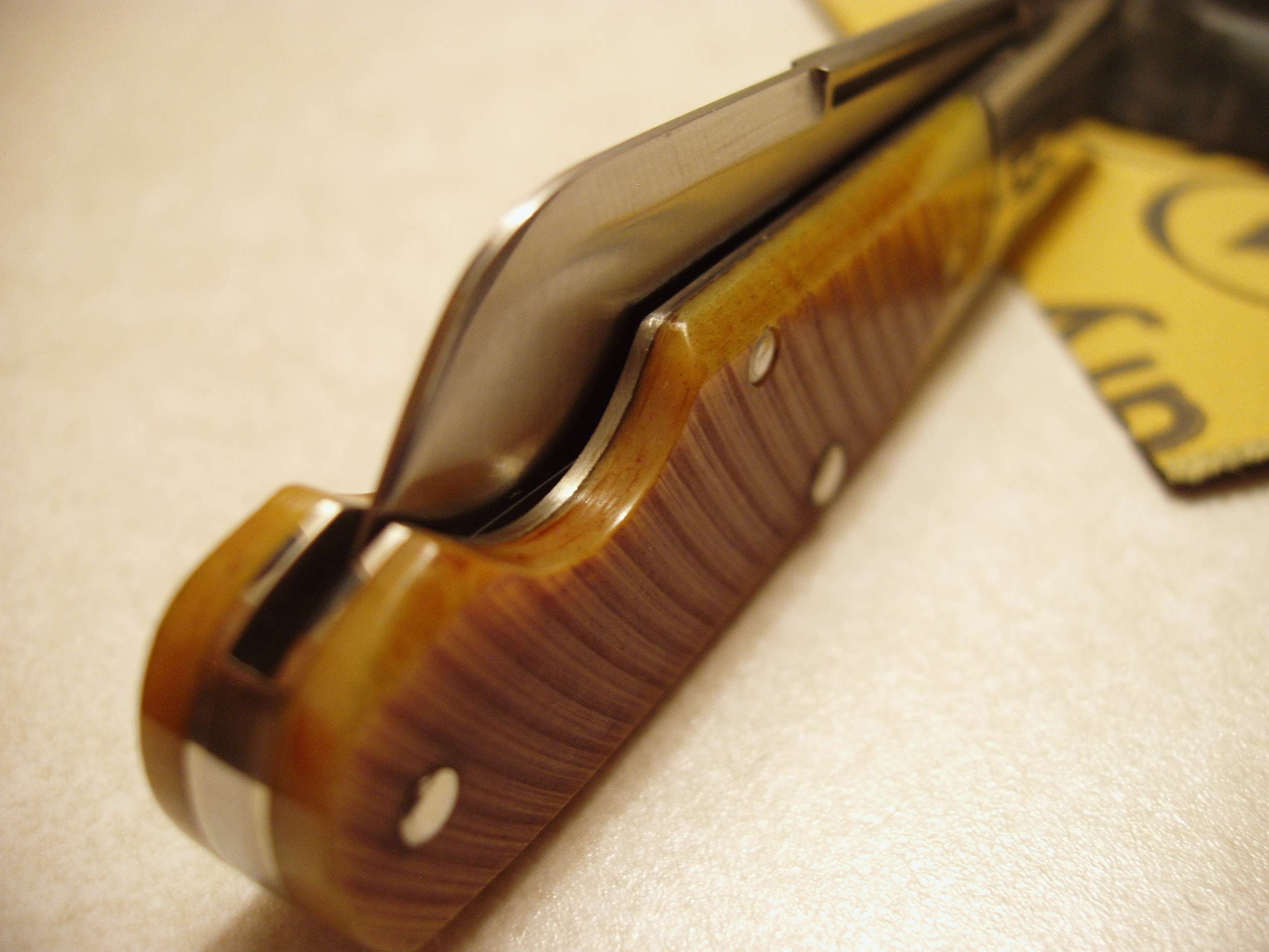

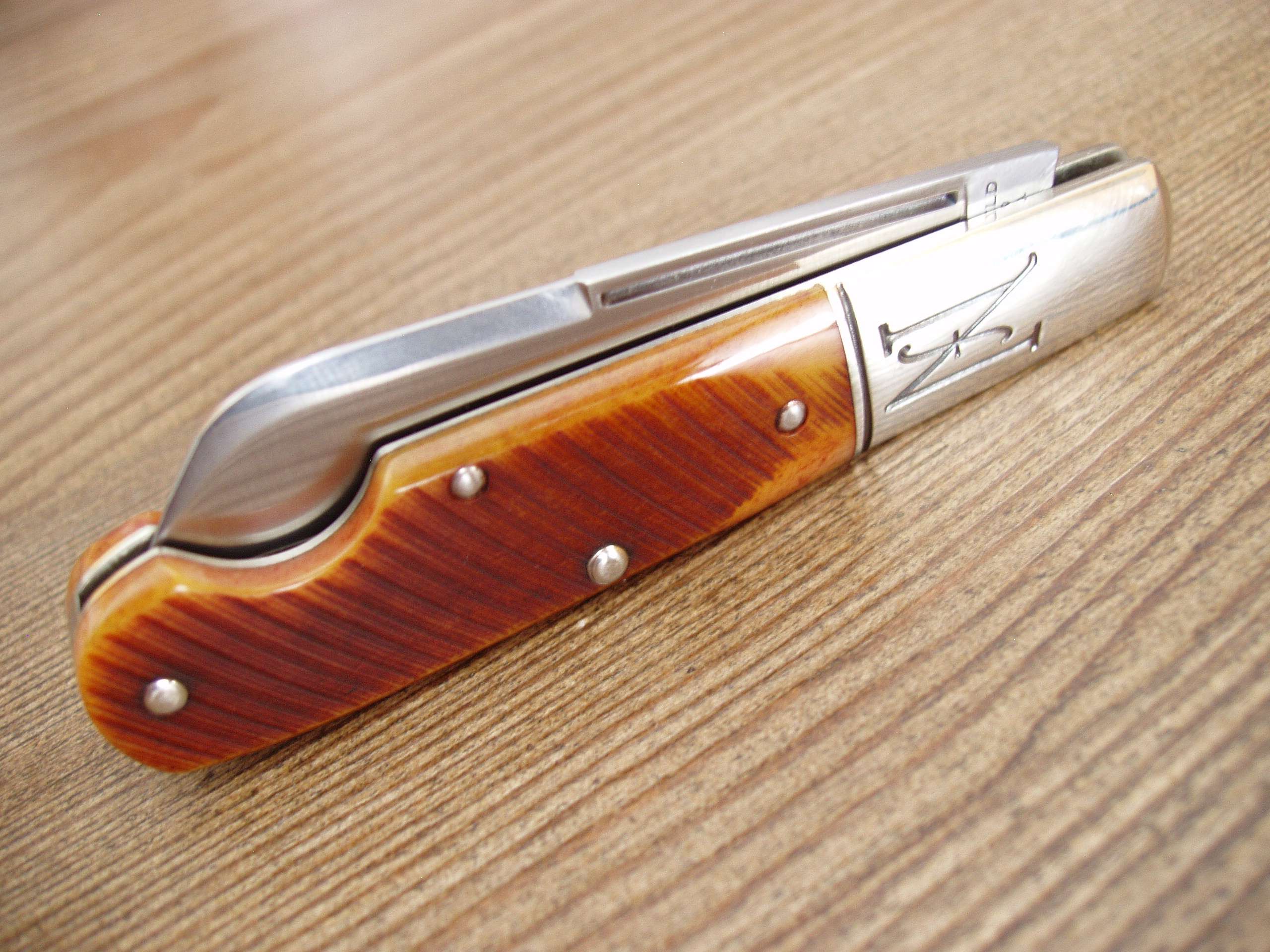

I then finished with 600 wet/dry sandpaper and progressed up to 1500 grit to radius the edges a bit. I have some touch up (stain) markers from when we owned a Family Furniture store and hit the white of the bone to mellow it somewhat. I like the result so I covered the entire bone covers. To me the "Old Tan" was to YELLOW?
I like it MUCH better the color I ended up with now:thumbup:
Before...
Darkened covers with EO notch...

Paul, I love what you did with the color! Will it be permanent? Or will it rub off with time? I agree, the Old Tan really was New Yellow. I really like your burnt yellow!
