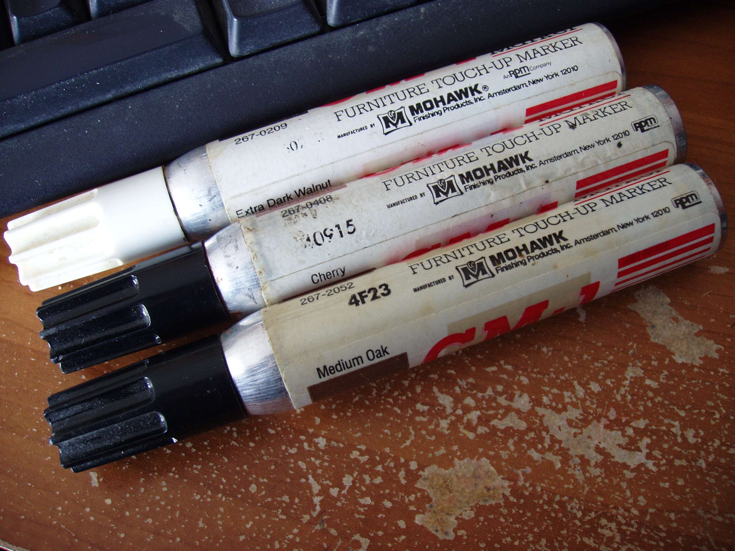

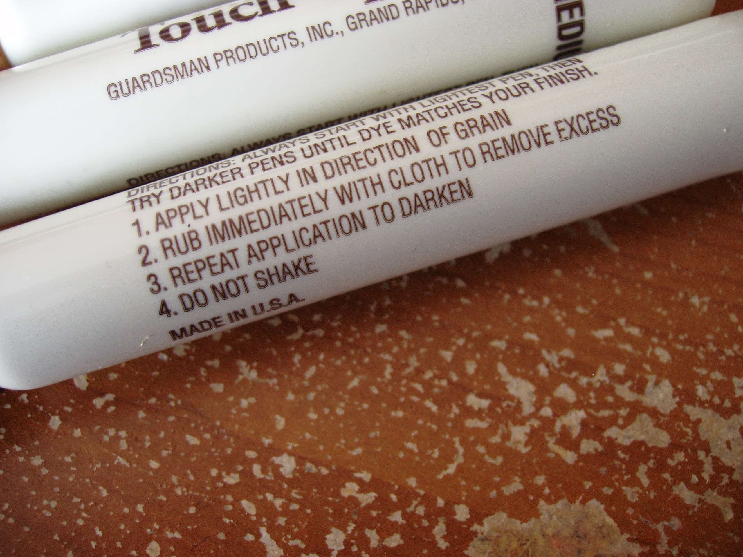

Can you give any more details on the stain marker you used? Brand/ color? Does the stain rub off or did it penetrate the bone? I really like that color.
Sean, I have a few from a couple of different companies but the ones I used were from Gaurdsman.
There's another Brand called "Mohawk" that make colored wood fill, wood colored crayons and the markers themselves.
For me it's like staining a raw door---apply, wait only a few minutes, wipe off the excess. It does penetrate each time. I used the "Medium" out of the three...Light, medium and dark.
You'll see the excess wipe off onto a terry cloth rag, then it eventually stops coming off. Once you achieve the desired color it stays that color:thumbup: I've done this on Stag as well as bone and even in the most humid of days it has never come off or left stain on my pockets, hands, pants etc...

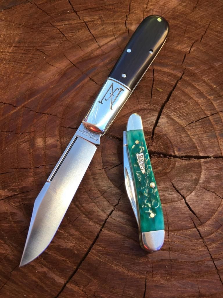

Here's what I'm carrying today...
