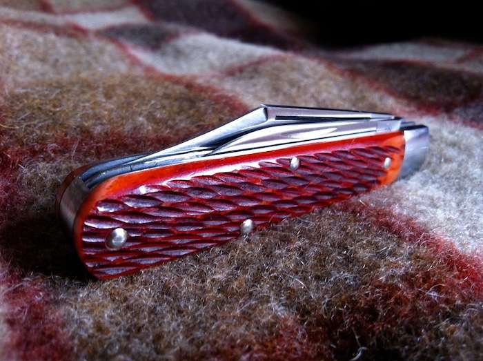

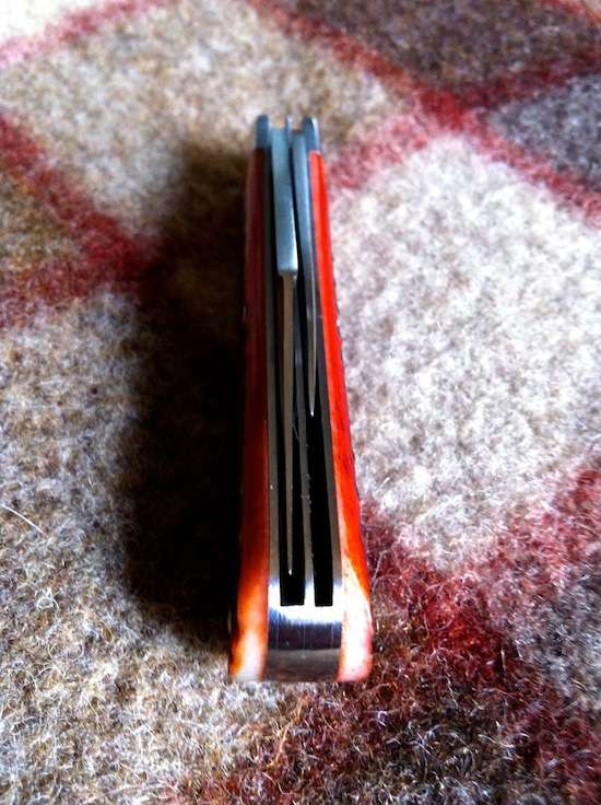

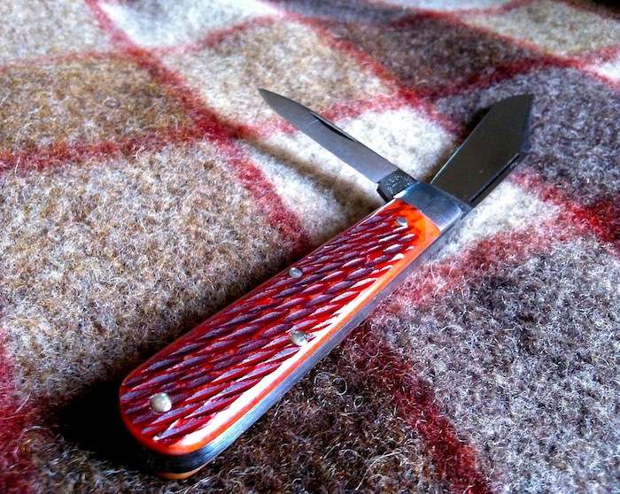

I got rather unlucky with this knife I'm afraid. GEC's UK dealer had the red-bone version, which when it arrived was an absolute beauty, except for the fact that I was unable to open the main blade without first opening the pen. It wasn't that the pull sat low, it was completely covered by the pen blade, the kick on the main blade clearly having been overground.

I don't think there's enough space for that, neither does the dealer. I have a Kabar Peanut that Pete very kindly sent me a while back, the original owner filed down the kick on the larger blade only to find that he then had to file down the kick on the pen to stop the pen blade blocking the nick on the larger blade. This means that the nick is only barely acceessible. If the kick was ground down on the pen of this knife it'd have to be almost under the covers to expose the pull, and I really don't want that. I think it's worth pointing out that, as with many other knives, GEC knives cost about twice as much here as they do in the States. It's disappointing to get a new knife and then having to think about filing down kicks, and what have you, to compensate for errors made in its manufacture.
