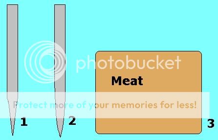

I know you understand blade geometry Sal and I have the greeatest respect for you.
If both blade points are about the same thickness at the very edge, let's say 2 microns and you intend to cut through meat that is thicker/higher than whole of the edgeprofile (for example 40 mm), than the drag should be greater in example 1 than in example 2 and thus cut less effectively, even though the blade is pointier?
The mass of the edge is greater in pic 2 than in pic 1. Thus thicker point?
~Paul~

Double the thickness of sample 2 (thicker), give both the same geometry. Will the thinner blade penetrate more effectively?

If the thickness is to be twice as big in pic 2 than the drag will of course be greater. That's obvious. Not as much as you'd think though ;). However that was not what I was talking about. I was aiming at the same point thickness at 2 microns and the same body thickness throughout this hole imaginary experiment :).

Yes, that's why I mentioned the importance of knowing what you are actually cutting and the thickness of the material.
If only the very point is to penetrate the surface of the material to be cut, than the very pointy straight edge is more effective. However, if the mass is thicker than that, the whole issue is much more complicated.

Couple things...
"Drag" refers to the resistance of material passing through air or fluid, neither of which meat is :o
Anyway, if the edges are on blades of the same stock thickness, then #2 is going to have more resistance going into the meat for quite a bit of the tip, making it worse at penetrating. What you say about them being equal at the initial penetration (i.e., "at the very edge") can be true, but getting the rest of the tip in is going to be easier with #1. Your argument effectively ignores that more than the very edge penetrates material stabbed in every real situation. Also, cutting with the very edge/tip is called slicing, not penetrating/puncturing/stabbing, so really you're changing the argument.
The drawing is not adequate. Lets look at a real pic instead. Para Military 2 left. Demko Custom Triad locking American Lawman HD folder right. Which do you suppose would penetrate easier or slice better? Not to take anything away from one over the other as both do a good job but to make the same cuts or go to the same depths the difference will be the force required. It stands to reason that more force means higher chances of there being less control. If one can make the same cuts with far more control of the cuts it stands to reason that it would be safer also.
I see inertia as being a factor. With enough inertia you could force the Demko as deep as the Para 2 but you could do it just as deep with far less inertia force using the Spyderco and with the same force the Spyderco would go lots further into the meat.
