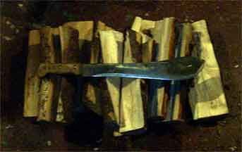

In regards to splitting with no force on the handle vs off hand pressure, here is a short comparison done with a pseudo-blind selection. I took ten rounds from the pile in the dark. I then disgarded two because they were ring knotted and would not split at all with the no off hand force.
Some of the rounds had natural cracks which were used, a couple had small knots which were either sectioned or divided depending on location and a couple were fairly clear, but these are all seasoned (1-2 years) and thus twisted and difficult to split compared to fresh wood :
http://i7.photobucket.com/albums/y269/CliffStamp/tramontina bolo/bolo_rounds.jpg
I used maximal force with off hand pressure to split three rounds and took a total of 43 impacts. I then used horizontal / no direct pressure to split three rounds and took 135 impacts, thus the efficiency was less than 30%. Similar to comparing a heavy tactical folder to a bushcraft knife on wood carving.
None of these rounds were as noted actually bad wood to split, no y-splits, no heavy knots, or no really twisted grain and the wood type isn't inherently bad (Cook rates them as "fair"). The ratio gets worse fast as the wood gets problematic and falls to zero on really bad wood where you have to chisel cut a knot.
The splitting was also slanted in favor of the off hand no force method, as the three pieces split with off hand pressure were worse (knots or wood, spruce vs pine). The time ratio was also much larger than the impact one because you are constantly putting the blade back in line every few hits if you don't lean on the handle heavily to keep it horizontal.
I used a Tramontina Bolo, simply because it was there. It is not a great wood splitter as it is too thin and binds heavily along the flats, and induces a lot of vibration with impacts through the tip which could probably crack the handle through the pins :
http://i7.photobucket.com/albums/y269/CliffStamp/tramontina bolo/bolo_split.jpg
It is a lot easier with a blade with a primary profile, flat or better yet convex. The bolo will warp in the wood rather than split it which makes it easier for the wood to stay together. It is spring tempered though so it will return to true even from 30-40 degree bends.
-Cliff
