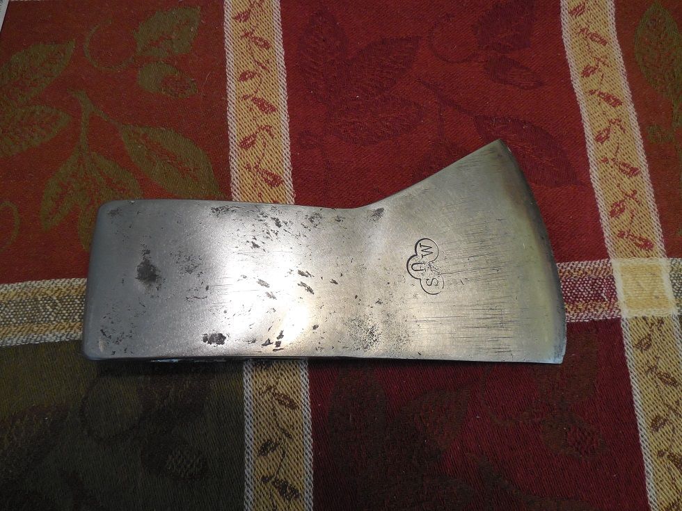

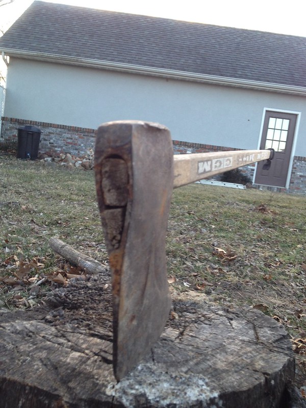

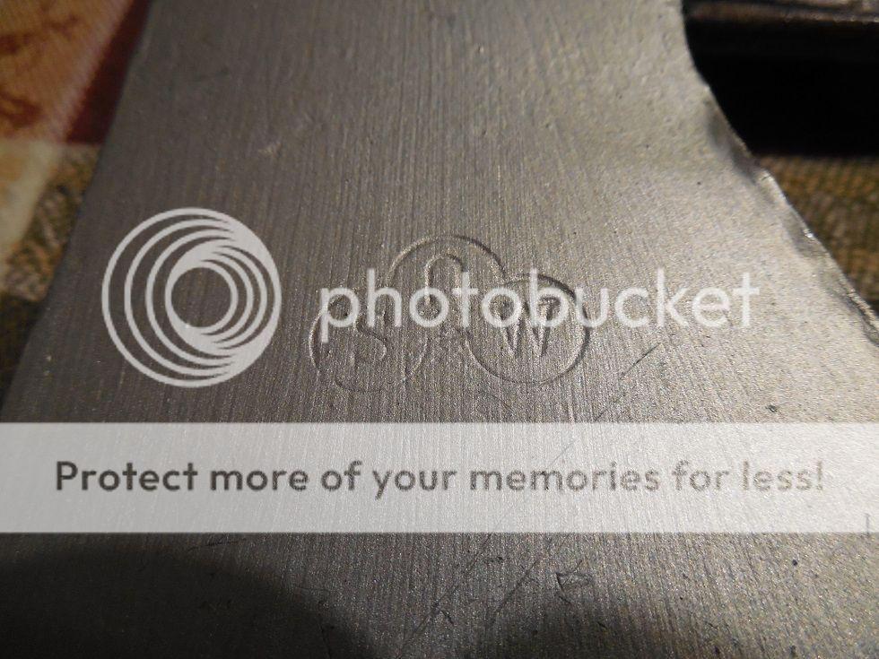

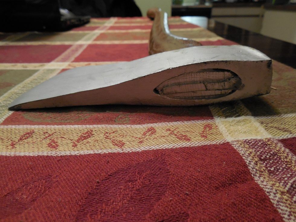

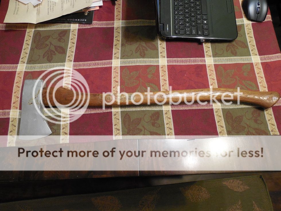

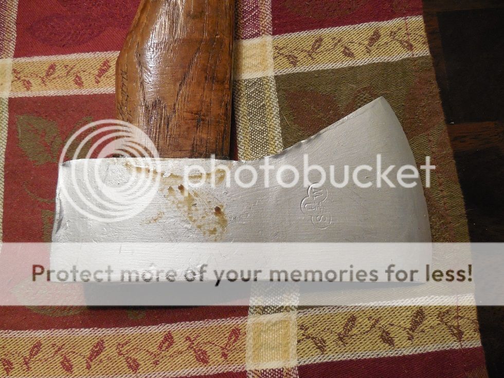

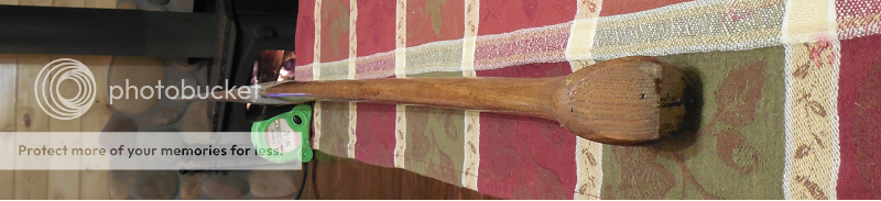

Junk store Wetterling. All credit to Steve Tall for ID'ing the brand for me. Warped handle (I'm guessing leaned in a corner for a few years), brushed on silver paint on the head. It's a safe guess it's not the original handle, both from the quality of the "hang" and the beating marks where someone removed it from a previous handle with the assistance of a hammer. Poll is a bit mushroomed too. As it sits I plan on rehanging it on a new handle, grinding off the beating marks and mushrooming (BTW I know some of you shudder at the thought of taking a bit to a grinder but I am very careful and go very slow and I am not breaking temper) and then sharpening it up. Mercifully there aren't any significant nicks in the edge. It's a shame the handle's warped, the grain is damn near perfect.
QUOTE]
Looks to be a decent prize to me. If the handle can warp over time in one direction then for sure it can be coaxed to go back in the other. I have no experience with steam bending but that's how canoe ribs and snowshoe frames were shaped years ago. First off maybe if you just soak the handle in hot or boiling water for awhile (overnight?) and then clamp it in a jig until the wood dries out it may come out straight.

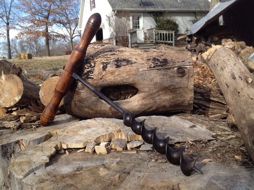

Nice looking auger! Must be about 1-1/2" or 2". It's surprising how fast a good auger cuts.
I've had no trouble sharpening mine with regular mill files and small stones. Once you get it sharp then do some test cuts and see that each blade is cutting equally. If one blade is doing most of the work then file it down a bit to get the blades even.
I'll try out the regular mill file but don't have any stones that small.
