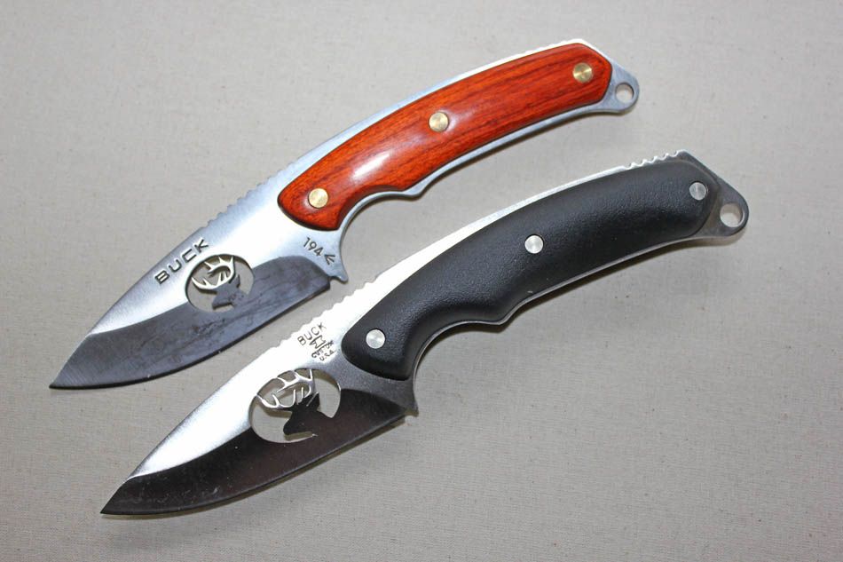

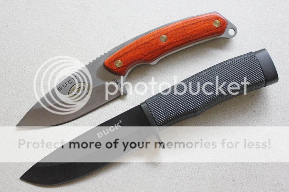

Two more fakes. The Alpha is about the best I've seen. The blades are actually stamped instead of etched. Even the Bos symbol on the other side is stamped.
Here's a comparison photo showing a real Alpha Hunter (the bottom one) with the fake. You may be able to see that the jimping on top of the blade extends further towards the butt on the real version and the deer cutout in the blade is larger (and more oval) than on the fake. The topper is that the fake measures 7 7/8" long vs 8 1/4" for the real version.

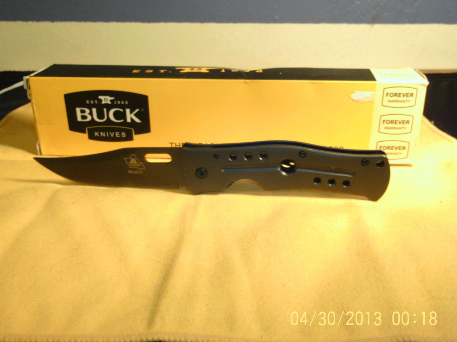

Seller is out of Yarnell, Arizona.
No tang stamp.

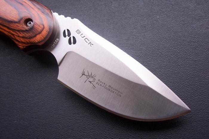

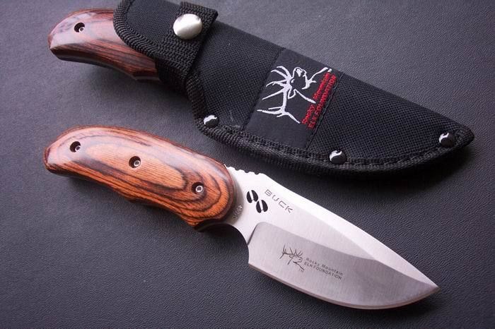

Here's another one that's common. There was a thread a couple of years ago where Bill Keys said that this one was a problem because the original was made for Buck for the RMEF in China.
"This may or may not be legitimate. We did have these produced for the RMEF a while ago, and they were manufactured in China. However, these have also been a favorite of the counterfeit sellers. We have seen these pop up on numerous sites (many in China). The problem is, since the originals were made in China and they do such a good job copying, the counterfeit ones look exactly like the legitimate ones and both are made in China. Best thing to do is to ask how the person selling it acquired it. If it was from a web site, I would be leary. If it was from a "brick and mortor" store in the US, then probably ok, or if from the RMEF itself, then ok.
Bill Keys
Director of Manufacturing and Engineering
Buck Knives, Inc."
Counterfeiting a charity knife!
Why don't you just kick me in the groin... Is nothing sacred?
