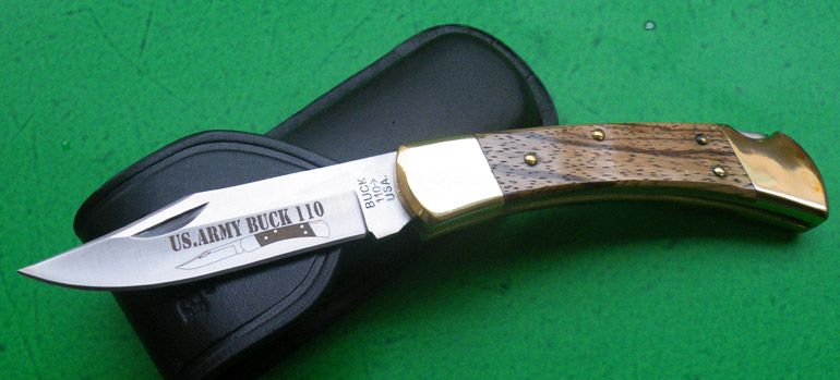

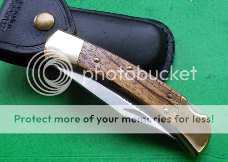

US Seller in Brownwood, Texas.
No tang stamp.

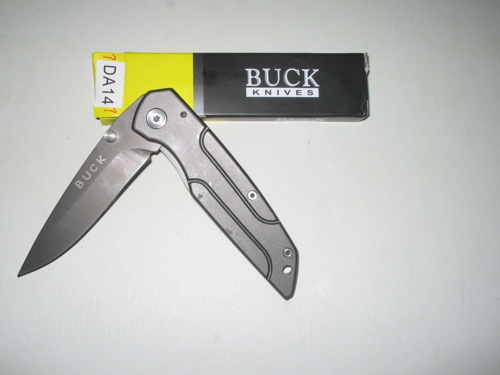

Seller located in Bradenton, Florida.
No tang stamp.

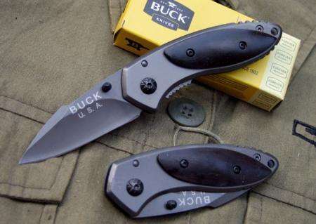

Note the differences in the grooves on the scales, the pivot screw and no Buck stamp on the pocket clip. I've yet to see one of the fakes that has a Buck label with the model number and bar code either.
Pictures of the real thing are posted below each picture of the fake for comparison.

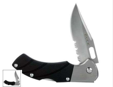

The Buck Talus does not exist. No tang stamp.

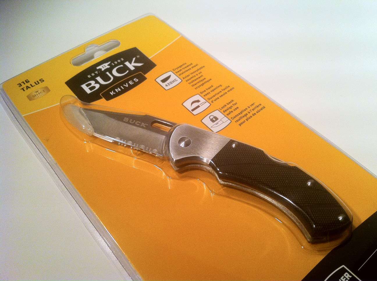

I assure you sir that you are completely, utterly and totally wrong.
http://www.canadiantire.ca/AST/brow...5P/Buck+G10+Black+Folding+Knife.jsp?locale=en
Canadian Tire is a massive hardware chain in Canada with hundreds of stores across the country. They would not sell fake Buck knives.
The Talus most definitely exists.
Edit: You might notice that the second picture you posted is the ad copy from the Canadian Tire website. The Talus does indeed not have a tang stamp on the presentation side of the blade. I would also point out that if this is a custom model made for Canadian Tire, it would not be the first. Buck still makes the Buck Lite 424 specifically for that retailer.
