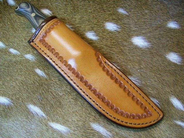

I am really liking that pouch design. I have been contemplating adding that type of sheath back to my line up. Well done.
You guys are getting too good!
TF

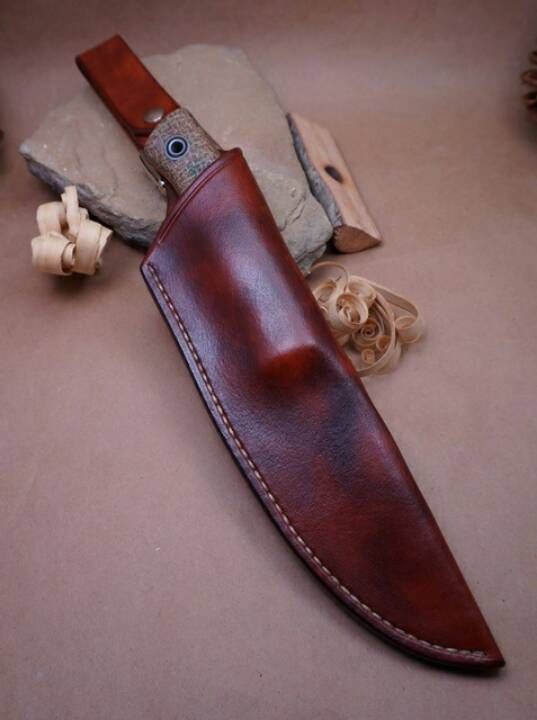

M4Super9,
I'm really liking what you did with that one, too. I've been too busy to start #2 yet, but you give me inspiration to get going. I thought you were dying them black, but now I'm seeing more of a dark burgandy; what is it? Nice job!
Rich
Feibing #124 Dark Brown, mixed 50/50 with denatured alcohol. I wet the leather with 30% denatured alcohol/70% water from a spray bottle and then spread with a wool dauber. I do a several coats at one stage and let it dry. I make final modifications, flatten edges and then do it again just before stitching. I couldn't get the holes to line up during gluing on the first sheath. This time I punched the top side and the belt loop, glued the welt and roughed the edges. I then dyed it, stitched the belt loop and glued it up. After gluing I re-punched the holes and cut the grove on the back and did the final edge sanding. Then I went back over the whole thing with dye again before stitching. I coated in Tan Kote afterwards. Color in the photos is a bit off. It's a dark chocolate brown with a red tint. Looks almost black in artificial light, but the brown really comes out in sunlight. The stuff that comes off when you rub it with the Tan Kote is almost olive green. I plan to try a third design when I have time.

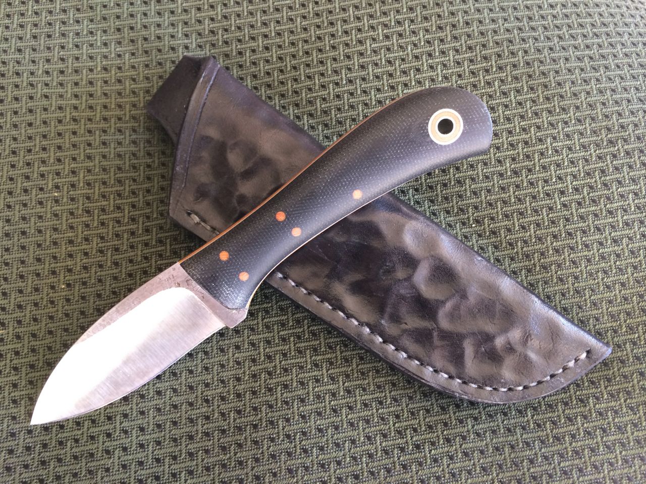

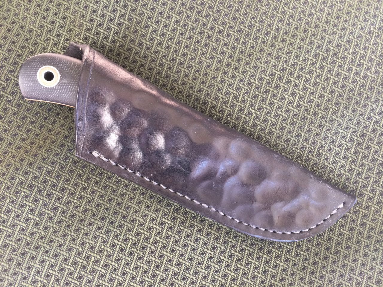

Thanks. I could not have done it this well after only a few attempts without your tutorial.
I don't ever plan to do this and sell them, but it is certainly fun for my own knives and will be great for sentimental gifts for family and friends. It most certainly has made me think a lot more about sheath designs and appreciate how much work goes into the leather. I probably won't ever evaluate the sheaths construction same way again.

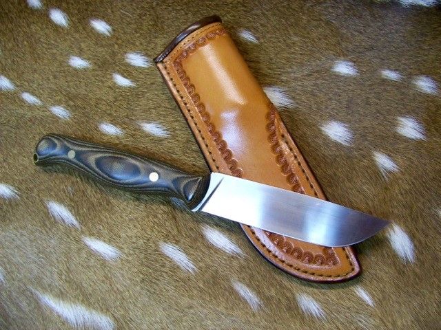

Oh - one last thing. Your initial stamps you use are generally 'self spacing'. Here is what I recommend for what you are doing. Tape your two stamps together and tap them both at the same time. With some practice on scraps they should always be aligned to one another.
OR - use the round border of your makers mark to follow as a guide and stamp them individually. In this way they will always be a bit crooked - but that will be a design - not a mistake. ;)

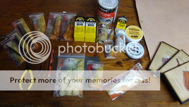

I’ve had the good fortune to come to own a few sheaths from some talented makers and had decided long ago to try my hand at making my own when I found the time. My schedule was expedited this December when my loving wife bought me a shoulder from Tandy’s for our third (leather) anniversary along with a few tools.
Having owned a few Fiddleback’s I was already eyeballing Tal’s sheaths and was lined up to purchase one. Then, along came the apprentice thread, which I jumped on and followed up with Tal. As fate would have it I was traveling through his part of the country at the beginning of this year and had the amazing opportunity to stop by and help build the sheath I wanted to buy for a Fiddleback Bushfinger. It turned out as I had hoped and dreamed, plus I learned a great deal firsthand along the way (thanks AGAIN Tal!). Here is a picture of the finished product:
Around the same time, luck brought me to Paul Long’s backyard where my father has a ranch. I had given my father a knife for Christmas, my third to complete, and we stopped by Mr. Long’s to have a sheath fashioned for it. He was a gentleman and a scholar, taking the time to educate and turn around a wonderful sheath in short time. Here is a quick peek:
So… after these amazing experiences I did my homework as advised and have watched all of Tal’s videos as well as a couple from Chuck Burrows and the great Paul Long. I also made a return trip to Tandy’s to pick up some “essentials.”
I would have hacked at the leather anyway, but due to the type of folks we’ve got here I’ve gotten sage advice and guidance along the way. I’ve also been happy to help support those teachers wherever and whenever possible. For my own first sheath I’ve decided to go for a butterfly pouch style sheath designed to fit a Fiddleback Recluse. Thanks again to everyone involved and any/all feedback is appreciated :)!

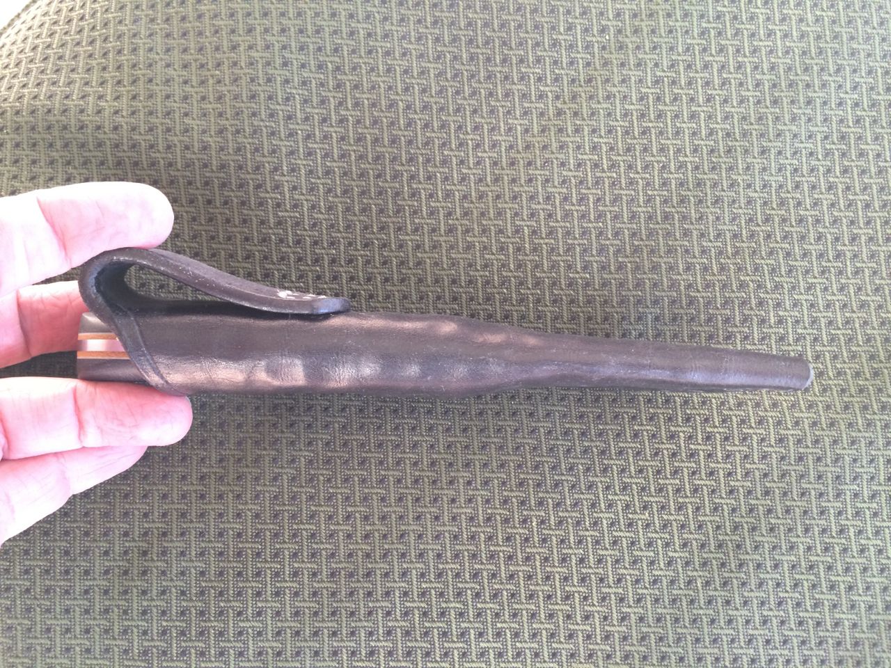

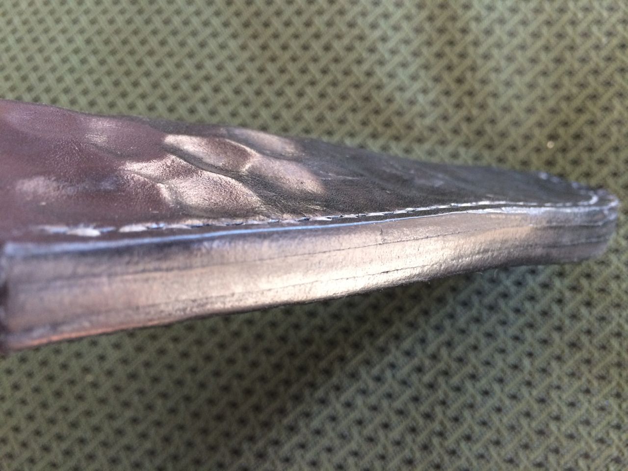

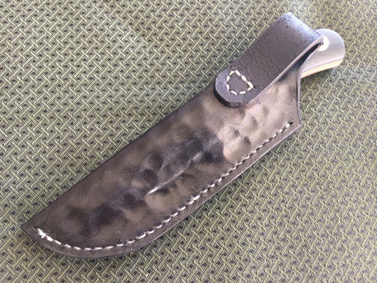

Finally got around to making a second sheath. This is my first attempt at one using Tals pattern. The sheath will work fine but it does have some problems, most of which were from me not taking my time and trying to hurry and get the sheath done. The most pesky problem is that I did not get the thread for the belt loop recessed in the groove enough on the inside so I have to be careful when sliding the knife in or it will catch the threads a bit. Gotta figure out how to get a better groove, went over it a couple times with the edge groover but it dosent seem to put a good groove in that flesh side of the leather. I also am starting to see how better leather would make for some better sheaths.
Thurin:
1) If you want to redo the edging - tape the sheath through the belt loop to protect it from anything silly. Blue painters leaves no residue. Sand back the edges a bit more and burnish them again. Then with a q-tip redye the edges. I think they look pretty good.
2) Use the q-tip on the welt on the inside too.
P&G: It could be that the flesh side is clogging up the hole on your groover. Try pushing the hole clear with a pin and give it another shot.
Both of you guys are doing good work. Practice on that leather you have - you can always give away a sheath or two - or make beaters for knives around the house.
I think both works look great. Your stitching is mostly straight, your detail work is great - the pair shader use on Thurin's and the P&G's groves I like a lot.
Well done you guys.
