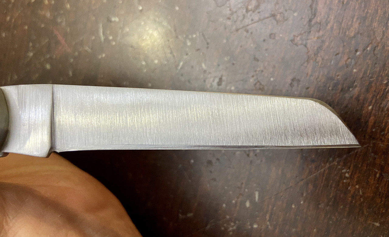

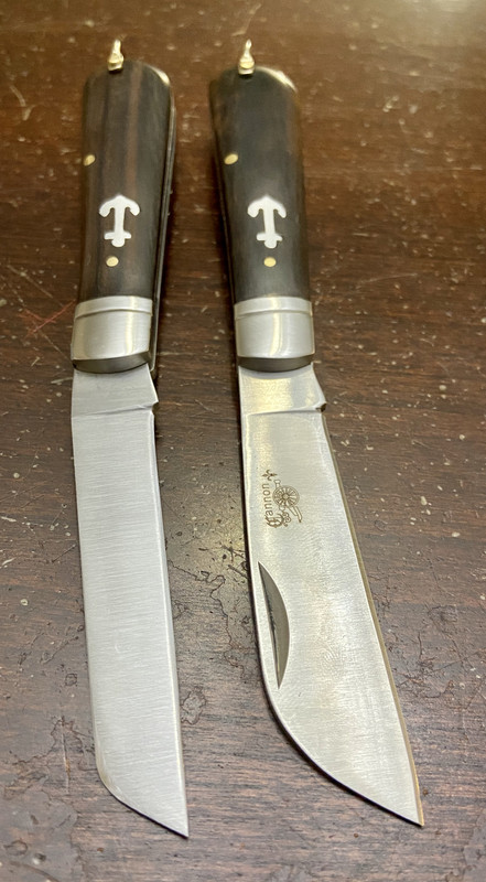

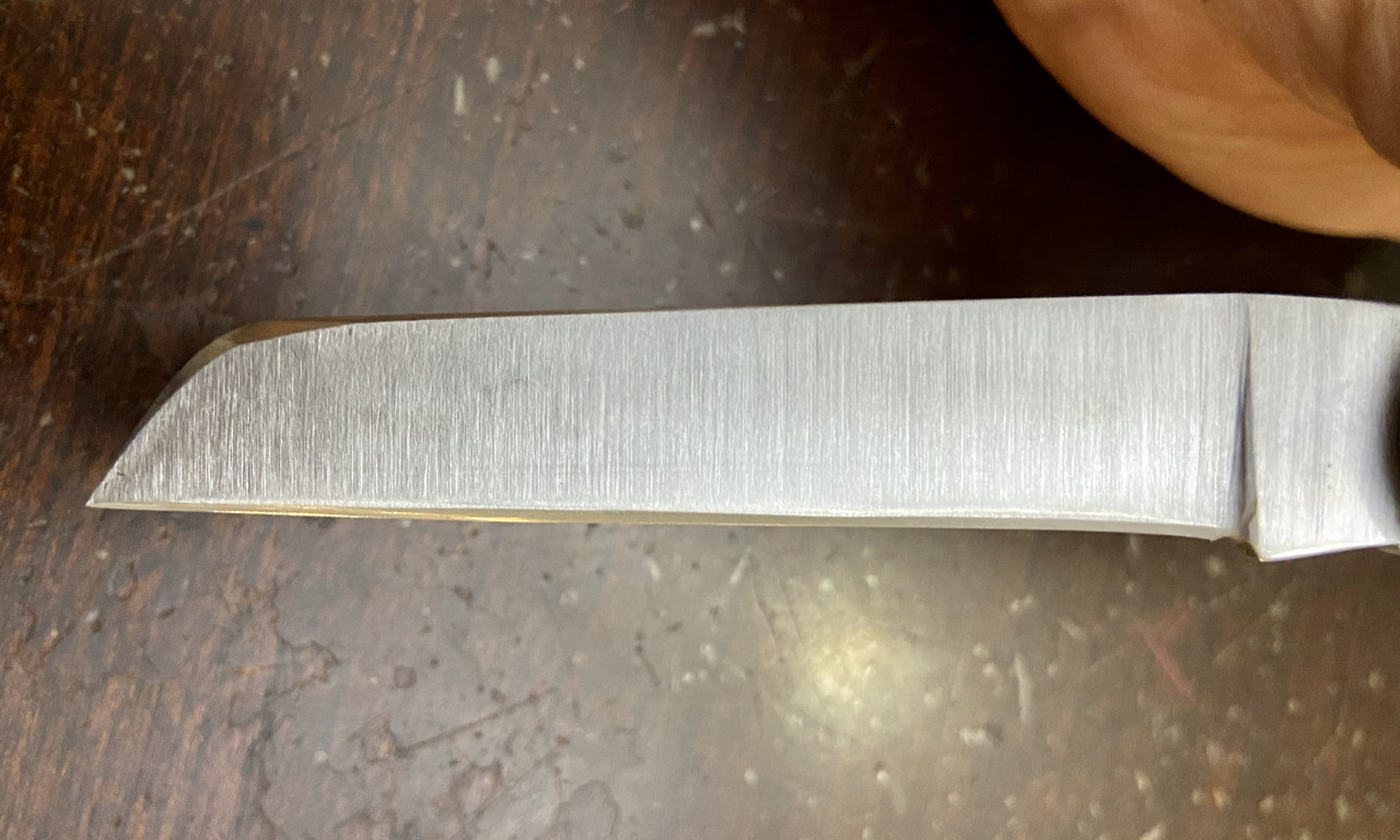

Took a very inexpensive navy knife and turned it into a lambsfoot. It isn't perfect, but for a 1st try, I'm pretty pleased with how it turned out. I started with a 60 grit belt, then 120. Then I hand rubbed with 400 grit and 600 grit (I forgot to do the 220, but I'll remember for the next one). Then I finished the cutting edge on King Stones (1000, 1200, 6000). The metal was pretty soft, so it didn't take as long as I thought it might.
Looks good JTB_5 JTB_5 ! Well done.
