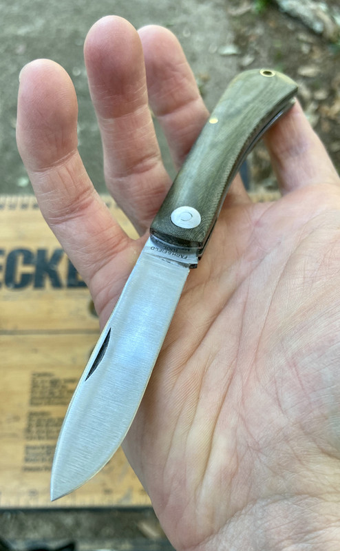

I reshaped my 71 farm and field today. I slimmed up and contoured the scales and reshaped the blade a little to make it more of a spear point.
I had been wanting to do this for a while but was scared I would mess it up. I’m happy with how it turned out. The handle is more comfortable and it gave it kind of a cool vintage micarta look.

I like that blade shape better.
Wish I had the tools and nerve to do that to mine.
Thanks for the kind words. @JohnDF - I’m think that blade shape should be better also. For some reason I don’t like the standard sod buster blade shape for my normal knife tasks.
If you’re thinking about changing the blade shape on yours, I would say go for it. I used a 1x30 belt sander, but you could just use sandpaper or files. As long as you go slowly it’s pretty hard to mess up. I just colored in the part I wanted to remove and sanded until it was gone. As I said earlier I had wanted to do the handle for a long time but was afraid I would mess it up. It came out fine and I’m happy I did it.
@Sacto did you thin the entire handle or just taper it at the front and corners? The pattern on the micarta looks like it is tapering.
I pretty much just rounded the corners all the way up and thinned the handle a bit at the pivot end. I wanted to thin the pivot end to get the pivot more smooth and flush. I already had the rawhide fob on the back end and didn’t want to cut it off and make a new one, so that made it hard to thin across the handle at that end. It felt comfortable, so I left it that way.

Got most of the way on @JohnDF's 71 spear and slim mod. The spear shape came out really nicely, but there are some flaws in other areas. I've still got to put a new edge on it and try and get rid of some rougher scratch lines on the pivot. Nearly there, though!
It looks fantastic. :cool::thumbsup:
I carried that knife solely for a week during Mike's Challenge GAW. The one thing I noted was that I didn't like the blade shape and wished the point was lower to aid in piercing tasks. Your modification should make it a much improved "user" and I can't wait to try it out. Perhaps I'll do another week's challenge in the totin' thread and report on how it has changed. I'm very excited and appreciate you doing it for me. :cool::thumbsup:
