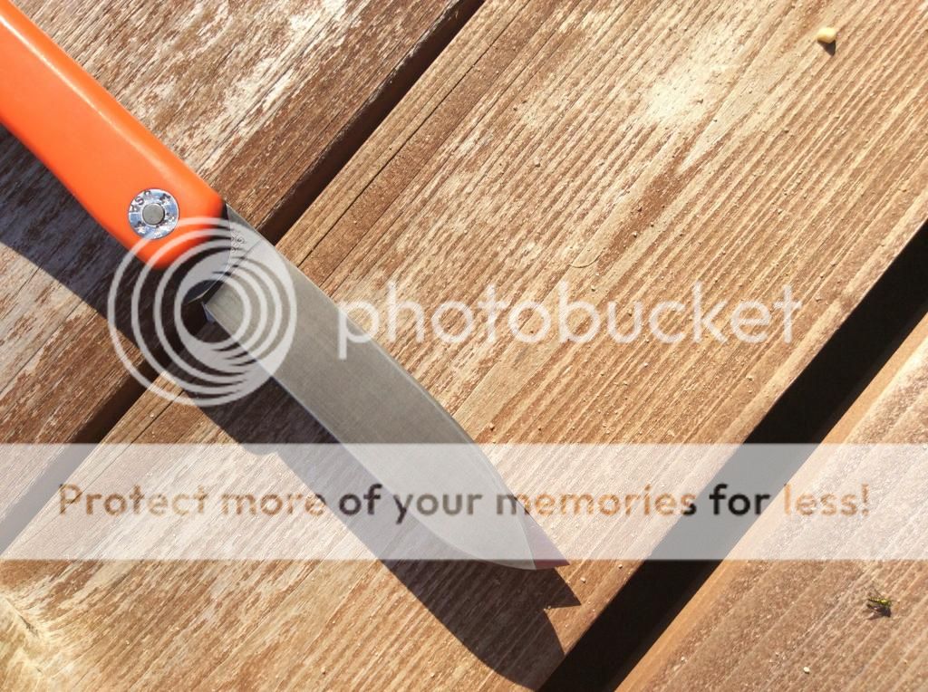

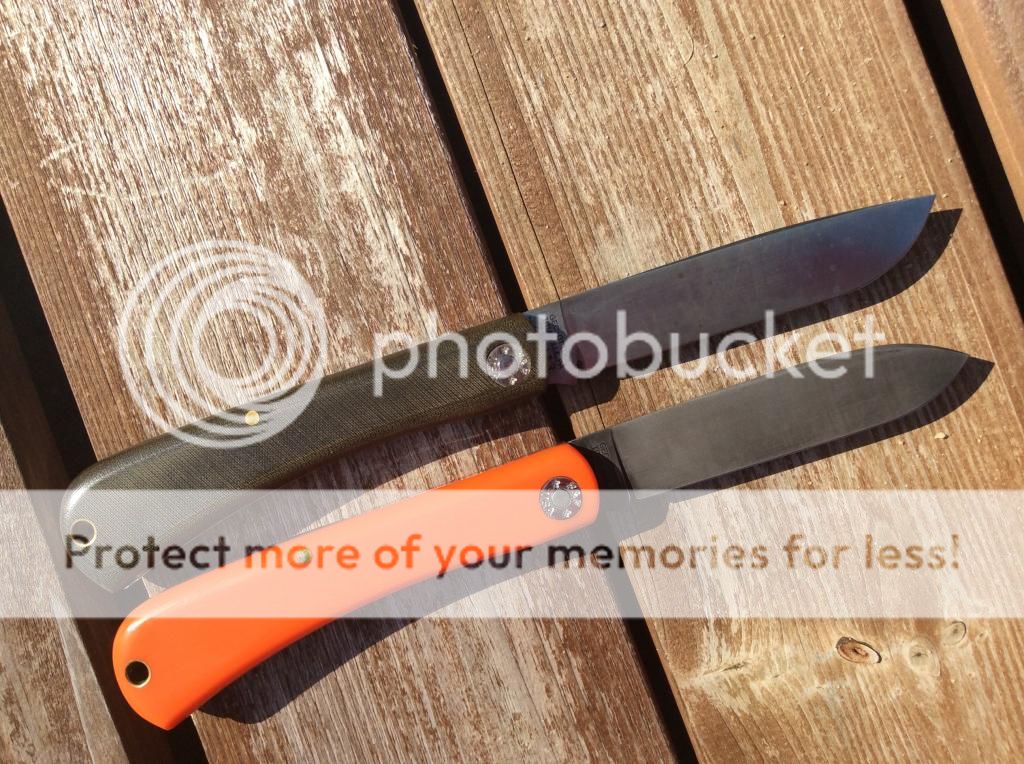

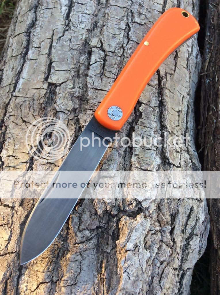

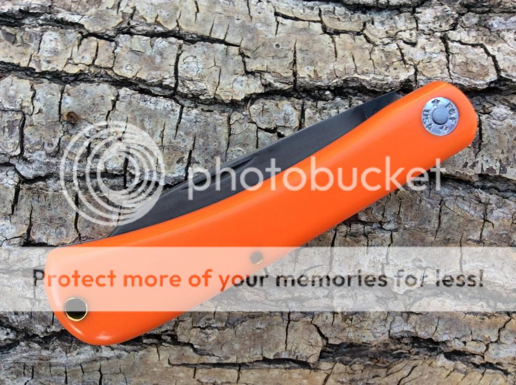

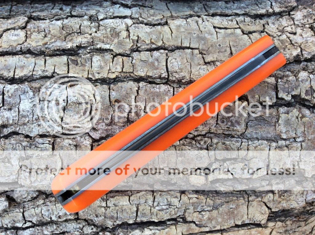

Here's my first project. If for no other reason than to see what it would look like. All done with hand files, sand paper, scotch-brite and apple cider vinegar.
That's a great looking patina, nice and even throughout!

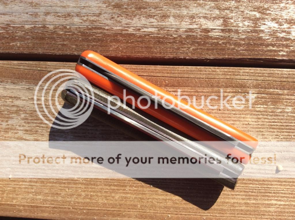

That's a nice job. Very even patina. Looking down into the well of the knife, the thong tube is visible whereas it is not on a stock knife. How much shorter is the blade now that you have modified it - 1/2" maybe?
Many thanks for the comments. :)
I knew there was something I forgot to do. I meant to take comparison pics. Blade lost 3/16" to be precise. A little shorter than where I thought it would end up going in, but still plenty long. I wanted to stop at -1/8", but just didn't like how it was looking when I got there.

That looks great Kirkwood! Minimal blade loss, good trade-off for the results you achieved. :thumbup:

I get it now! When you posted the first pictures, I didn't realize it wasn't originally a spear blade. Very nice. :thumbup:
That bullnose is phenominal! Even the swedge (not quite a swedge, but rear of the blade) is proportional and even. Looks very factory.
Many thanks again. :) I'm happy with how it turned out, and even found some garden work for it right away where the spear tip came in handy. :D

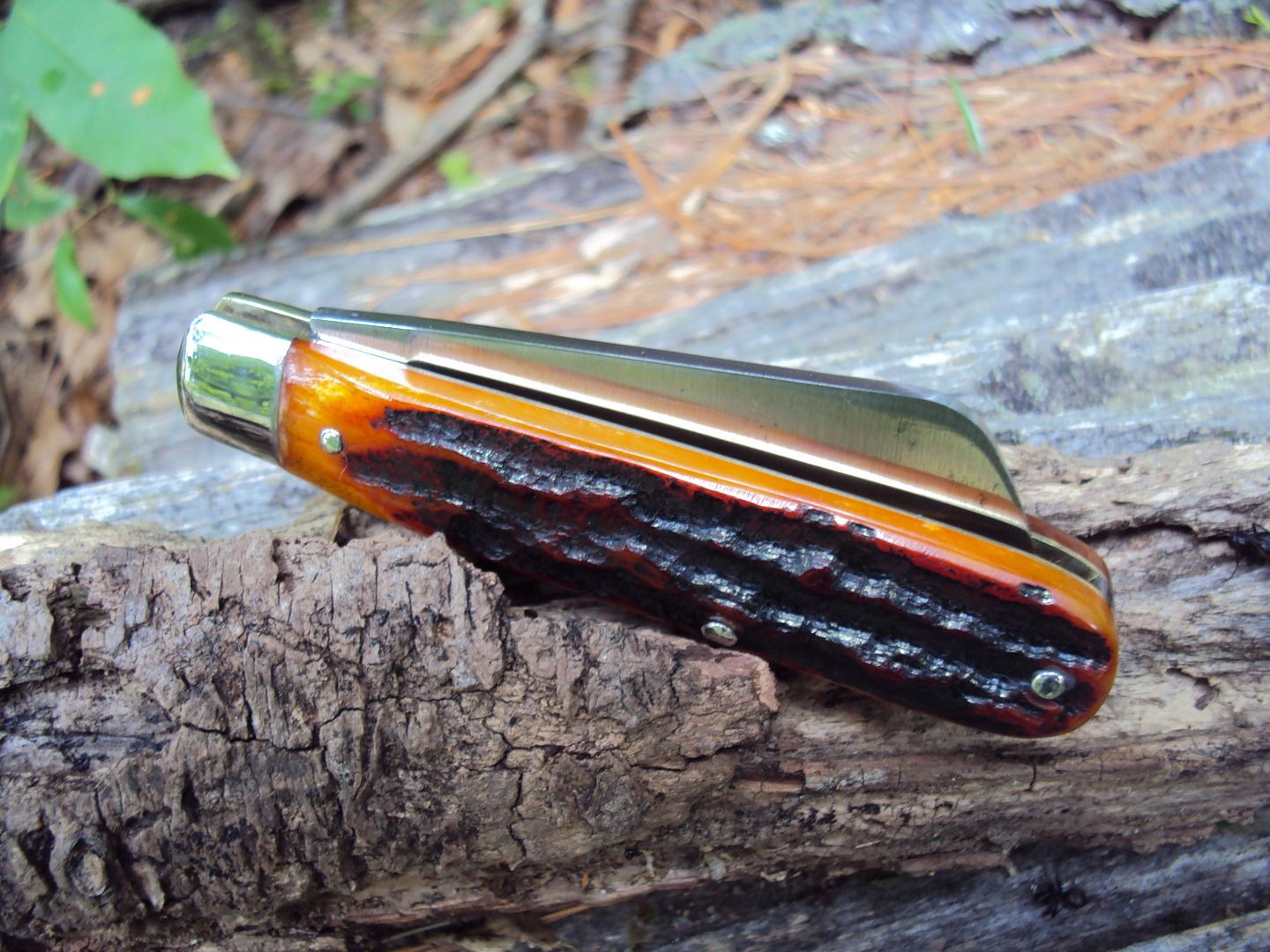

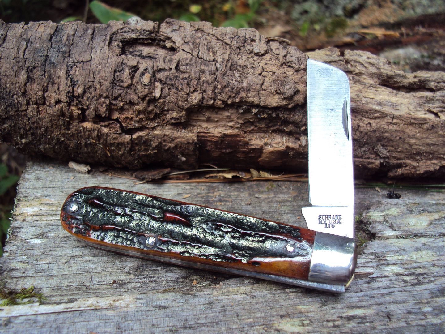

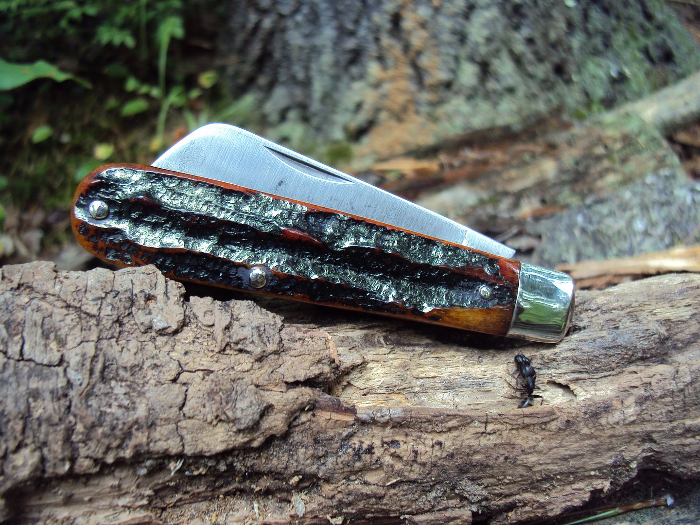

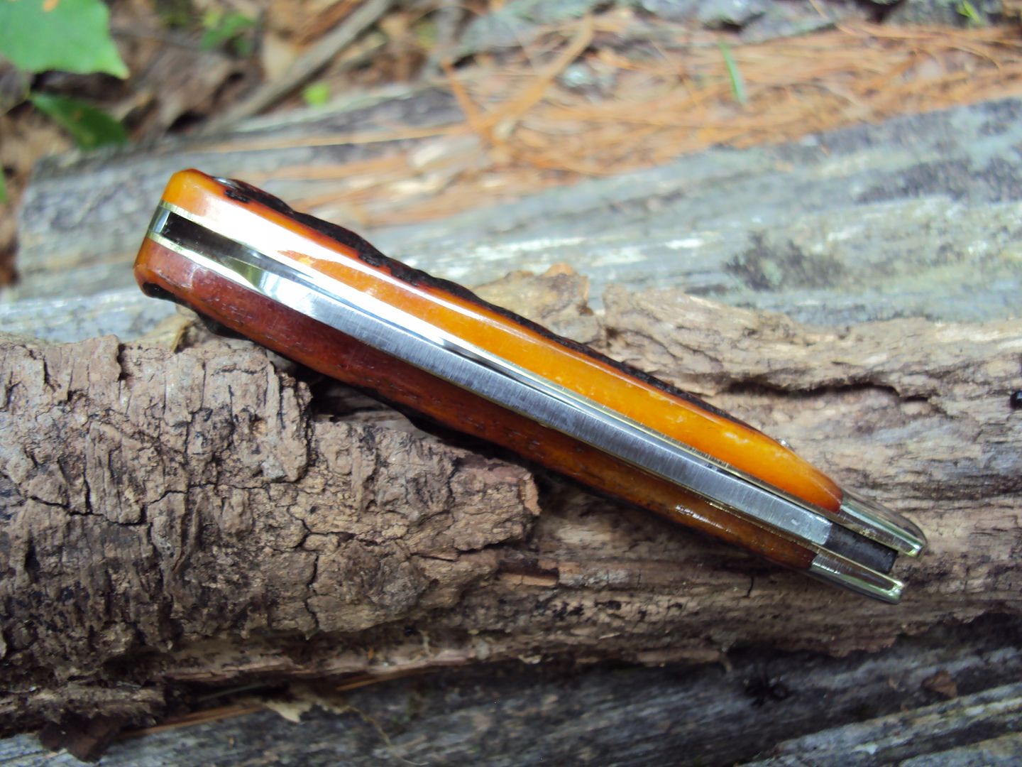

Here's one I just finished. A Schrade 175 pattern done up with amber carved stag bone...
